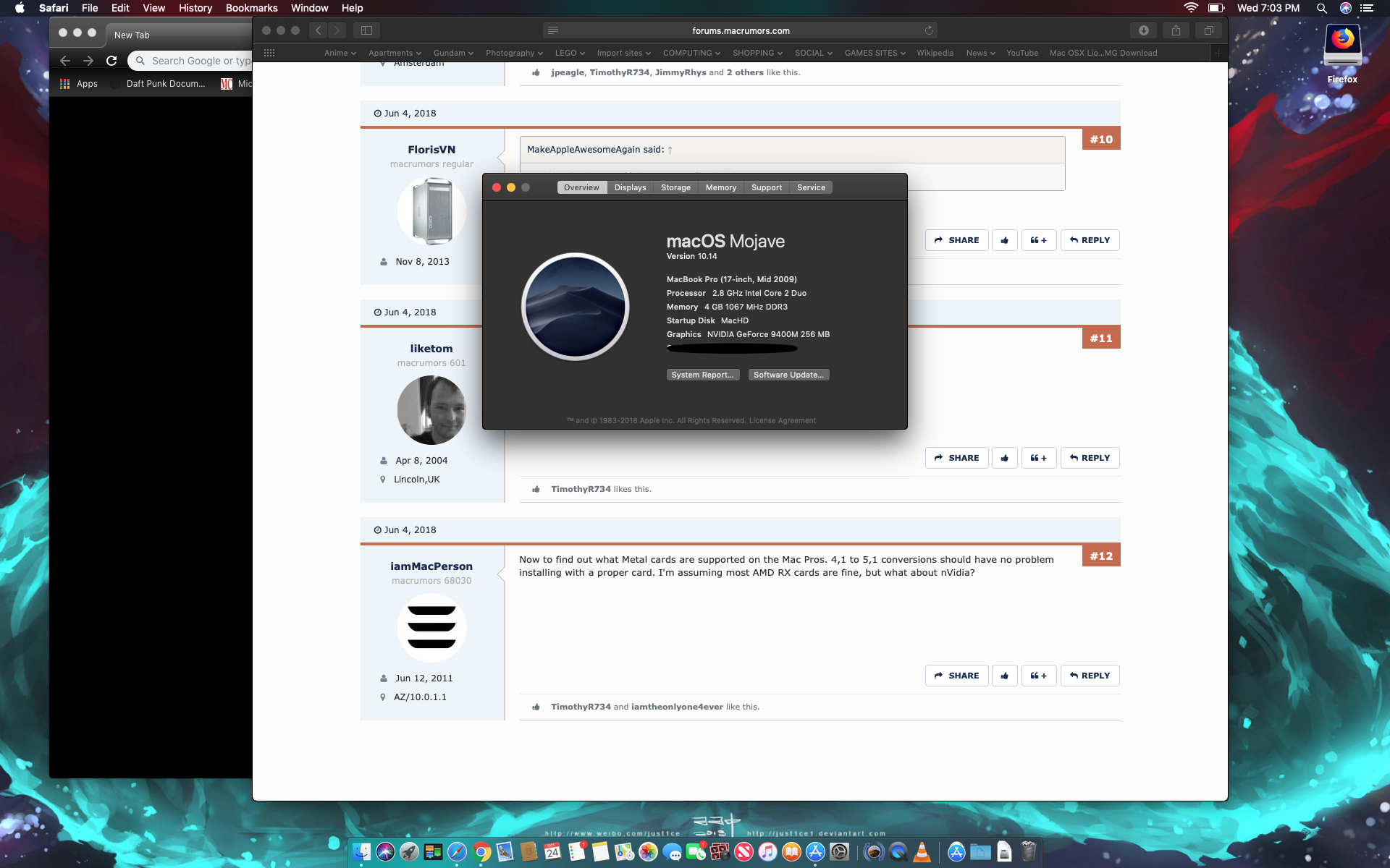

I've seen those who posted that they have gotten their iMac brightness working. This is literally the only single issue I encountered after installing Mojave, everything else is working awesome. I have a dual monitor setup and can't adjust the brightness on the iMac screen. Looks like the iMac brightness is about halfway at most. Hope someone can help me out to find a solution.
sometime reapplying the backlight patch from the patch updater works or you can download the brightness slider from the App Store its free
