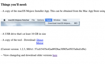

his site is still showing and downloading 1.2.2
Empty your browser cache
Reload the page with command Key press

Reporting a successful update from 10.14.0 to 10.14.1 on a 11,1 iMac.
I simply downloaded the new patcher, recreated the bootable USB key, installed Mojave on the previous version, applied again the patches and it worked flawlessly.
