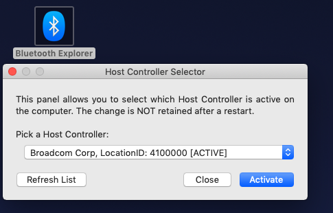

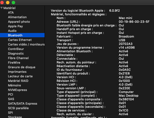

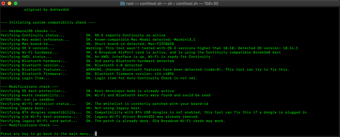

@dosdude1
Do you have any ideas with CAT issue and BT 4 ?
Continuity Activation Tool worked with 10.14 with my Macmini late 2009 (with a swap module from an A1342 MacBook) and BT4 dongle but with 10.14.1 Continuity don't work.
Impossible to uninstall CAT due to APFS/no recovery partition... so impossible to re-install because it report that Continuity is already active (the same in System Prefs).

@dosdude1
Thank for your really crazy great job !
The dosdude1's USB Mojave Installer can act as a Recovery, try uninstalling from there.
