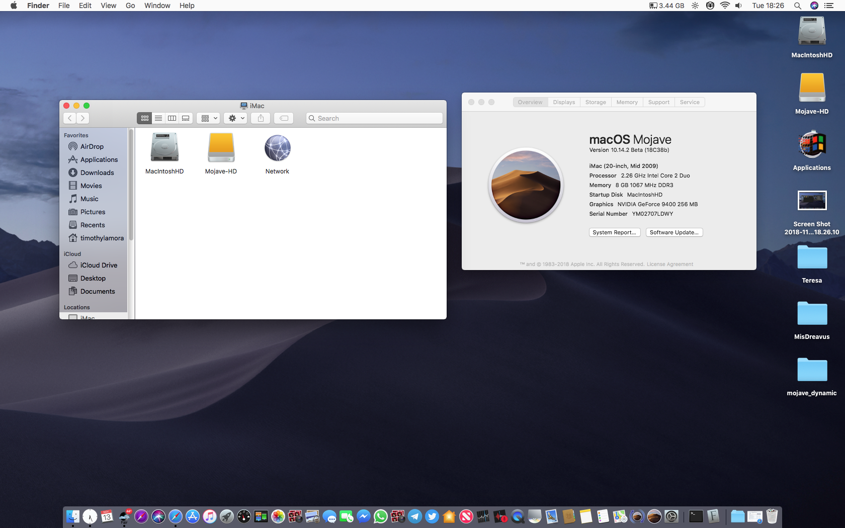

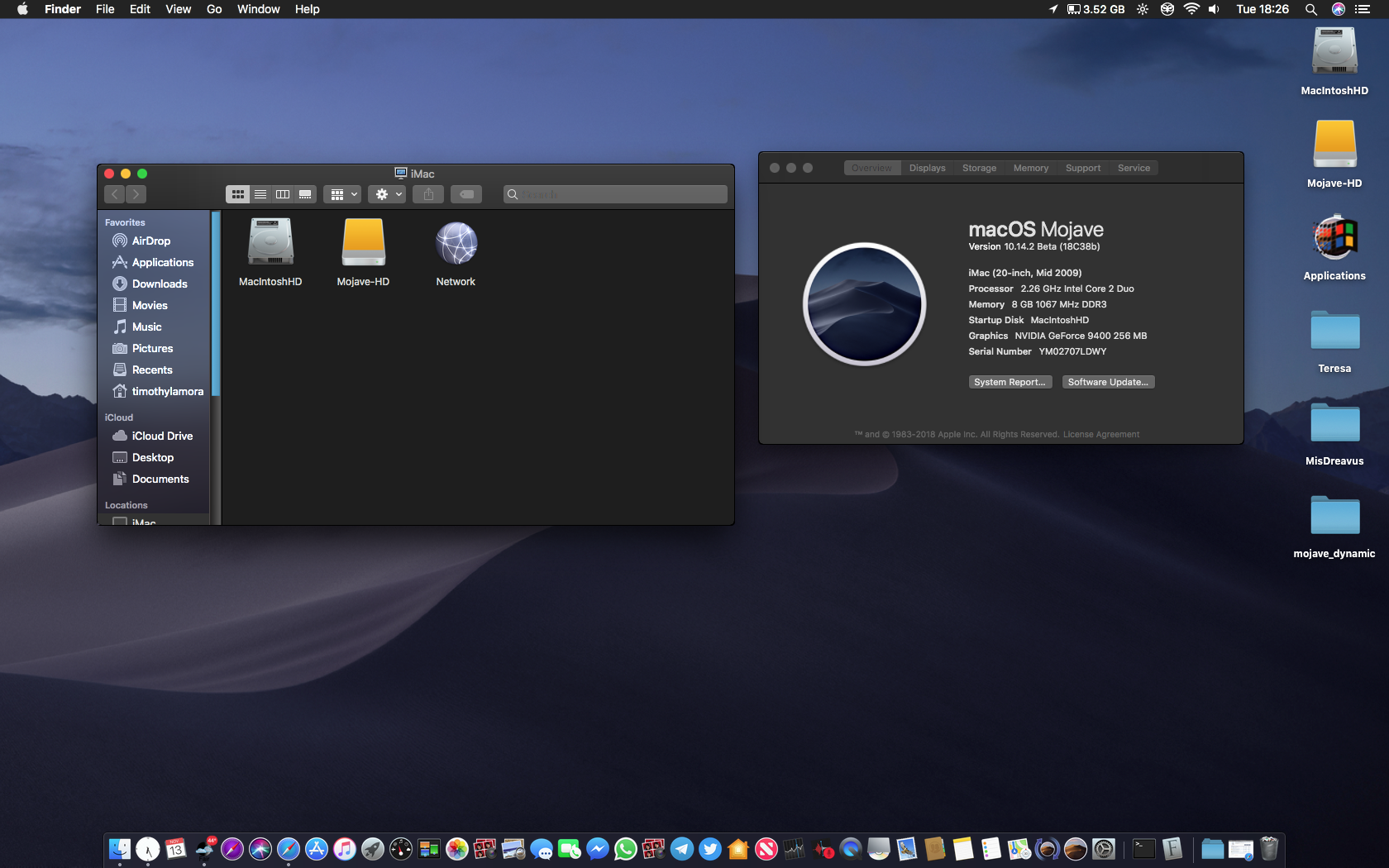

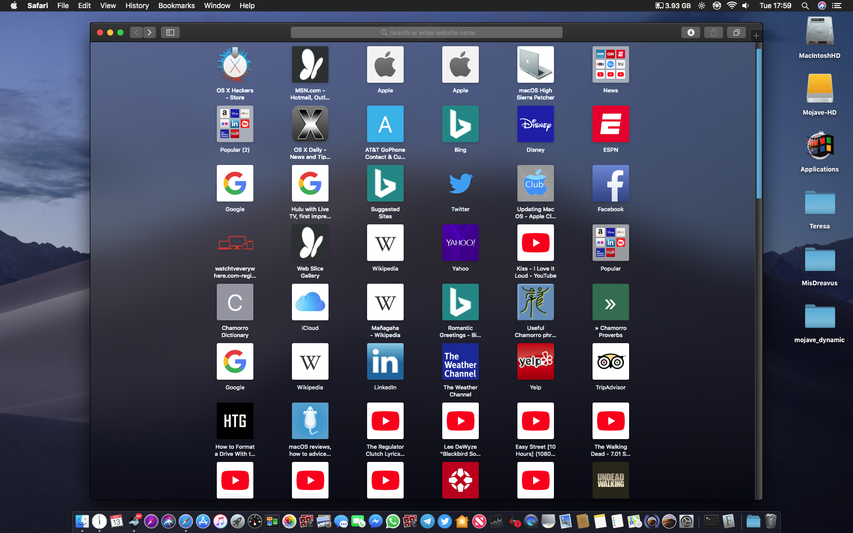

where can i find transparency in Mojave?
and ow can i check on MBP5.4 if hybrid mode patch is working?
that is how transparency looks if you install the hybrid patch correctly

Yes, thank you!
But where is the transpsrency option?
I cant find it...
its not an option you can turn on or off it does it automatically if you patch correctly

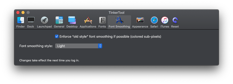

I use Tinkertool with the following settings and I'm happy with the result in all apps so far.
