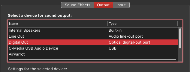

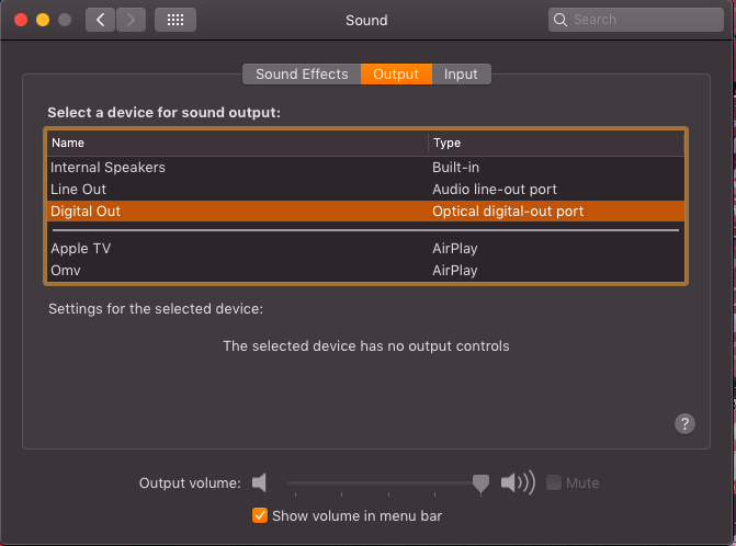

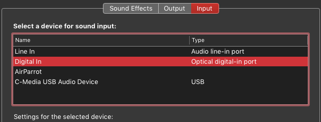

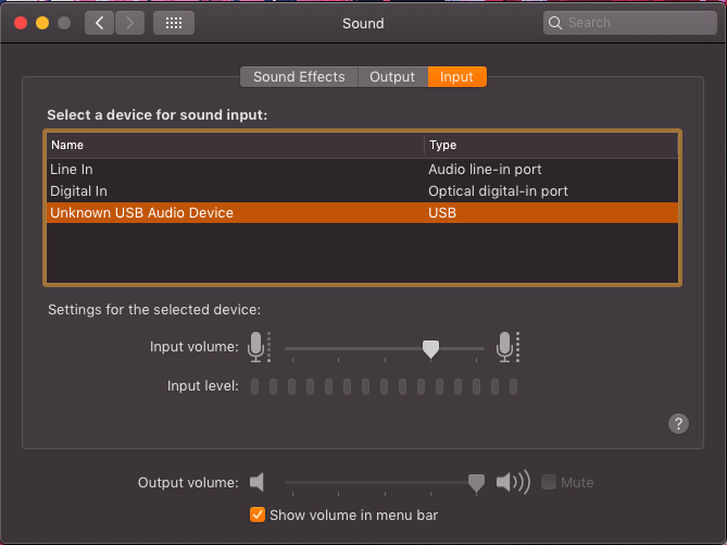

Could someone with a working Mojave setup on Mac Pro 3,1 (or unmodified MP 4,1 and patched installer) please verify if TOSLink digital in/out for audio is working or at least shown in system info / audio section? I´d like to rule out different behaviour between miniTOSLink (i.e. on MacBooks) and TOSLink (on Mac Pro). Should only be connector type that´s different, not the audio path and kexts involved, but I´d like to be sure...

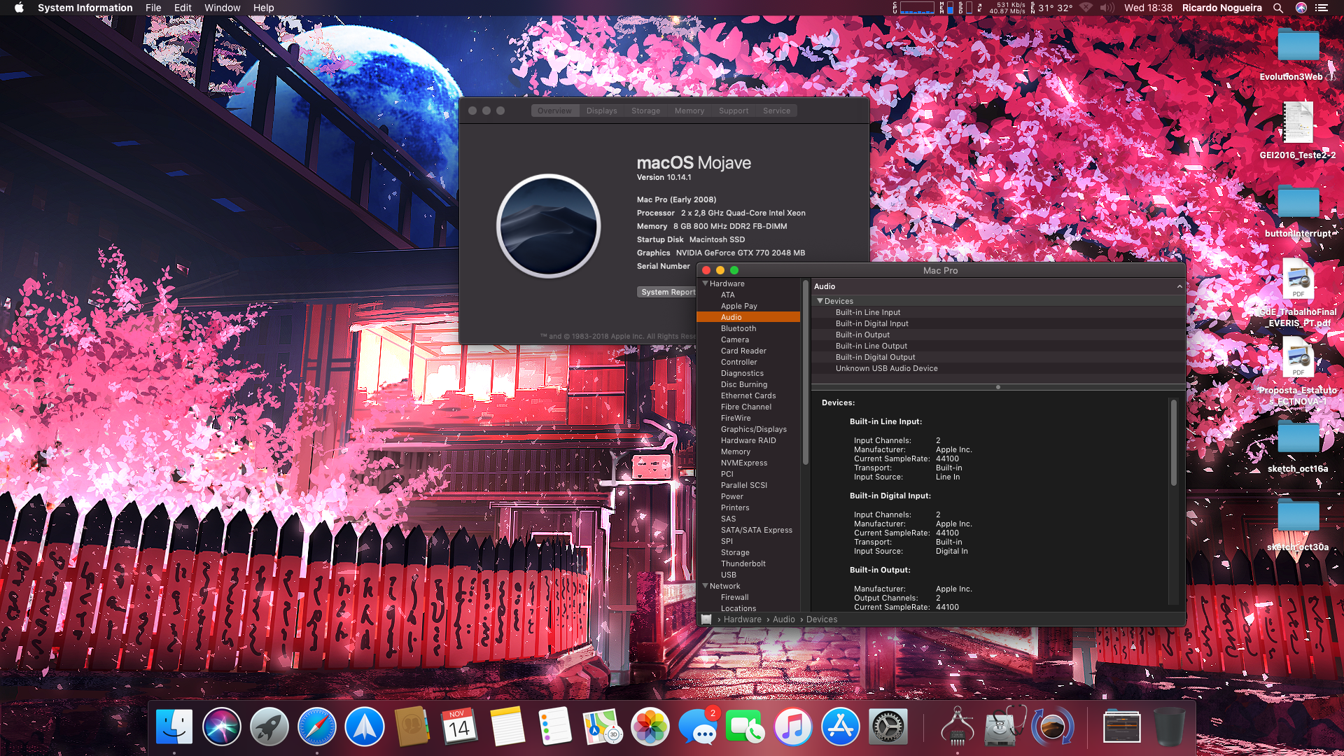

MacPro 3,1 running 10.14.1

No problem on a MP 3,1 and I use digital all day every day.
