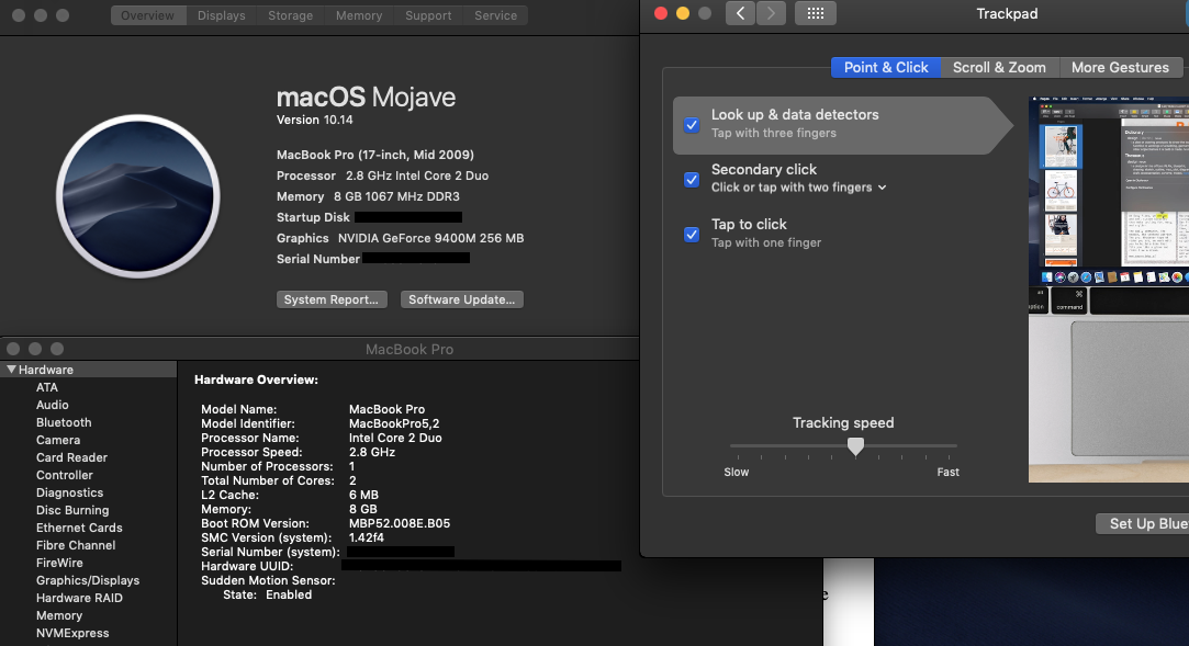

I got that model.
It works OK for me. You might want to do a PRAM/NVRAM reset if the track pad is not detected at all.
Proof:

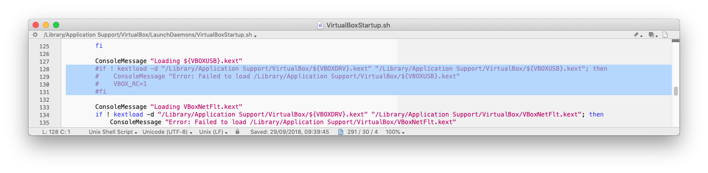

The following patch would apply to any machine with issues with the iSight camera... if you also have installed Virtual Box (currently 5.2.18 but I presume all versions will break iSight).
I noticed that after a clean install the builtin isight camera didi work ok, but stopped after a while. Looking around I found that uninstalling VirtualBox does bring the camera back to life!
How to get both working ? Well, it looks VirtualBox has a kext that breaks the camera.
Found a way to partially disable that kext, but keeping the camera and Virtualbox working at the same time. This unobtrusibe and clean touch/fix will get broken if you install a newer version of Virtualbox and you'd have to do the changes to the file again.
See highlighted the commented lines on the Virtual Box file, then restart your machine and enjoy the Camera and VirtualBox.
File to patch:
"/Library/Application Support/VirtualBox/LaunchDaemons/VirtualBoxStartup.sh"
Look for the section below
ConsoleMessage "Loading ${VBOXUSB}.kext"
Enter comments to the kextload section.:
#if ! kextload -d "/Library/Application Support/VirtualBox/${VBOXDRV}.kext" "/Library/Application Support/VirtualBox/${VBOXUSB}.kext"; then
# ConsoleMessage "Error: Failed to load /Library/Application Support/VirtualBox/${VBOXUSB}.kext"
# VBOX_RC=1
#fi
Hope this helps somebody out there 🙂

Just updated VBOX from 5.2.18 to 5.2.22 and the same issue happens as the patched file gets overwritten.
Same suggested patch above solves the issue and FaceTime and Camera work again after the edit and restart the computer.
