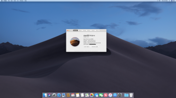

Well I had to reinstall the OS after I upgraded the GPU because I figured it was easier than trying to remove the Legacy Video Patch. Anyways, after some grinding of the heatsink, I have upgraded my late 2009 iMac with a SSD and a Nvidia GTX 770m. Thanks @dosdude1 and everyone else here that has worked to keep our machines relevant. I'm off to bed, Happy Thanksgiving everyone!
