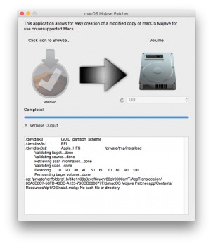

I used the Mojave Patcher and selected already downloaded(not with this tool) Mojave Developer Preview1 and proceeded.
At the end it showed "..../macOS Mojave Patcher.app/Contents/Resources/dp1/OSInstall.mpkg: No such file or directory"
Could you please let me know if I missed anything or did something wrong...
Used this on Macbook pro late 2011 13"
  • patcher opened from Applications folder Screen Shot 2018-06-27 at 2.02.27 AM.png
Reactions: lowercaseman
