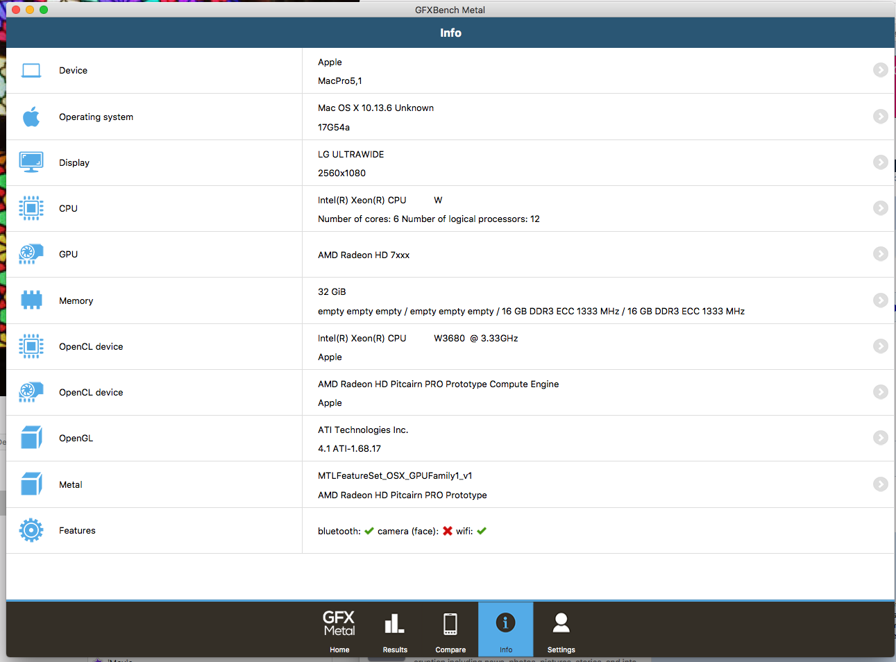

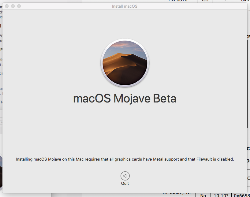

I just tried installing the first public beta Mojave on my Mac Pro 4,1 (early 2009) that had the EFI flashed so it reports as a Mac Pro 5,1. I have an Asus HD7870 GPU which should support Metal. I've ran the GFXBench Metal app which seems to indicate Metal support. Yet, when I attempt installing Mojave, I get an error message about Metal. My Filevault was never turned on. Am I out of luck with this Asus GPU or has the requirements changed since Mojave was first announced?
It's probably because the GPU is a PC card not flashed with a Mac EFI. Not sure a Mac ROM is available for that card, but I guarantee you that the only issue is that the Mojave installer just isn't liking it reporting as a Radeon HD 7XXX. Also, I'm not 100% sure Apple has added official support for the Mac Pro 5,1 yet. You can try using Mojave Patcher, just be sure that you deselect the Legacy Video Card Patch when running the post-install tool. Or, you may not even need to run the post-install tool at all.
Happened with me too, had to use startosinstall to install the PB1. Seems a bug on the installer app.

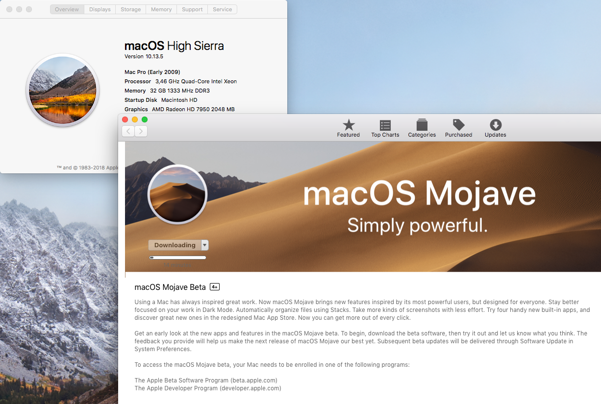

Hello dosdude1;
I have a semi supported Mac Pro for Mojave. This is what I have:
Mac Pro 5,1 (Mid 2012)
Graphics: AMD Radeon HD 7950 3072 MB
Is there anything special I need to do in order to install Mojave? I do have a full copy of the DP2 Beta on my other supported Mac.

Sadly, no. With and without Legacy Video patch at post-install, both end with the KP screen in 6 languages after progress bars reaches about 2/3rds.
Ok, must have needed ALL the 10.12 AMD kexts... Just updated it to include them. Download again, and copy macOS Post Install.app (from Mojave Patcher.app/Contents/Resources) to /Applications/Utilities of your USB installer, boot from the USB installer, and run the post-install patch again.

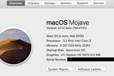

That was the trick dosdude1. It now boots to Mojave but no GPU acceleration as you said. Also noticed no wifi either. The date on the Finder taskbar is a bit blocky too. I'll play more with it tomorrow and let you what's not working, etc.
