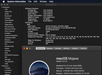

2) I replaced the non-recognized BCM 4321 AirPort card with a brand new Apple Broadcom 4322 AGN BCM94322MC card (eBay item 272528670442). Works flawlessly in my 17" Early 2008 MacBook Pro 4,1 2.6Ghz 6GB RAM 500GB SSD (model A1261). Connects to our WiFi network at 120Mbps down / 10Mbps up... exact same speed as Ethernet !!!
