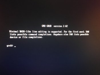

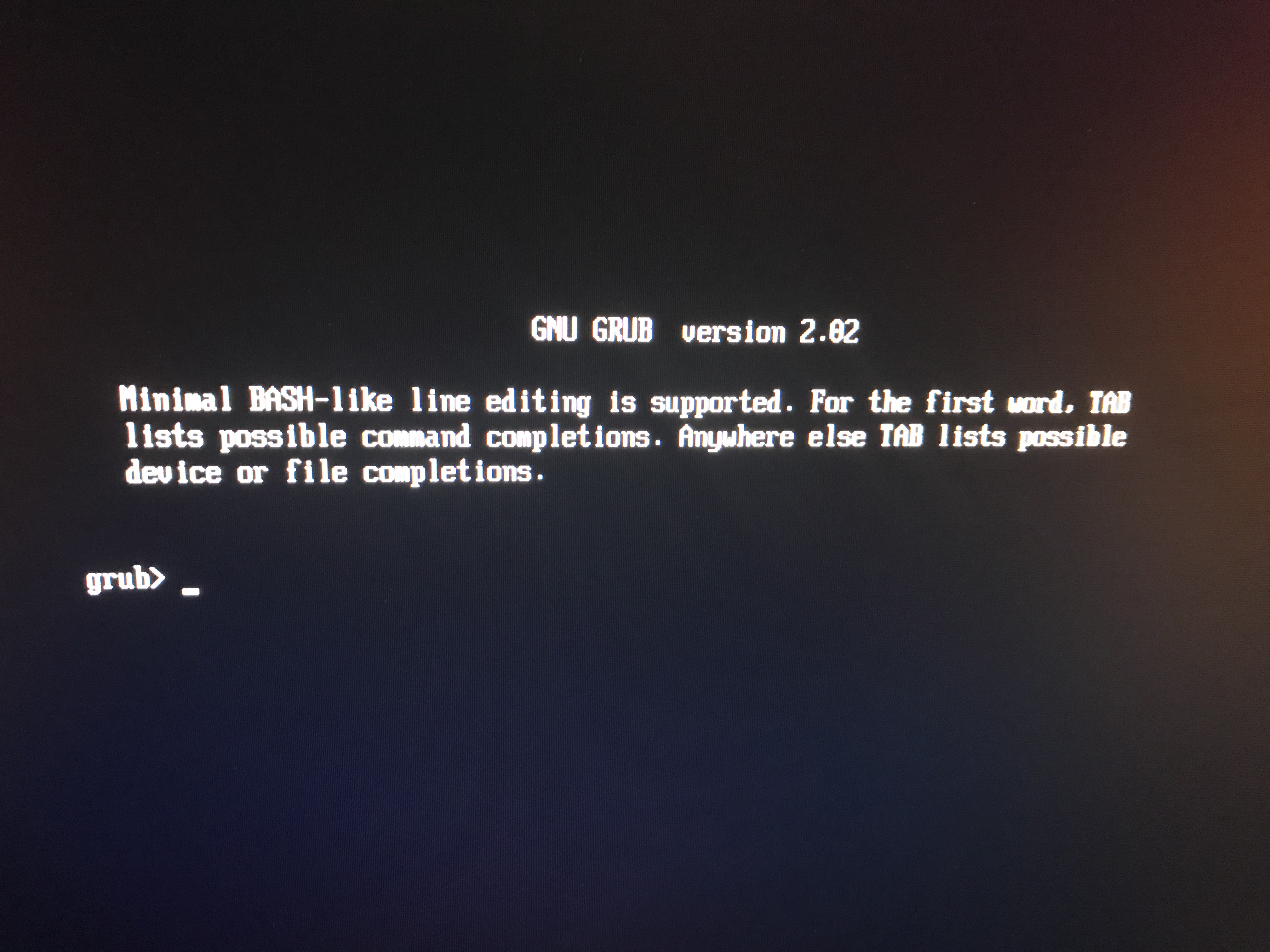

Guys, I installed Mojave on my 2011 mini earlier today and everything went well at first. Then I tried to boot using cmd+r and the thing wouldn’t boot into the recovery partition. I just got a circle with a line through it. Then, like the idiot I am I tried holding option and booting into recovery that way. Well, that didn’t work either. I saw my boot drive and EFI boot. Guess which I picked... now I can only boot to a grub prompt. How do I fix this?
To enter (as you done) onto a grub bootloader (tipically used on linux and PC) you used NOT the default mac startup manager but others third-party bootmanager, or you have installed previously Ubuntu, anyway to fix after the power-one chime hold CMD+ALT+P+R , and things should return as they were.
I did nothing but the Mojave patcher. But I’ll try your suggestion.
[doublepost=1551165827][/doublepost]Didn’t work.
[doublepost=1551165979][/doublepost]I typed “exit” and it exited and booted normally...
Who knew.

That's really weird, if you haven't use any third-party bootloader then probably you have installed the APFS software patch that's based on grub I guess, anyway "exit" is a good trick to escape from a loop bash shell.

Yes, I was pulling my hair figuring out what to do when I hit "tab" to see the commands, was reading through them and saw the "exit" command and gave it a try. Only other thing I had to do was after booting, open system preferences and set the SSD as the boot device.
