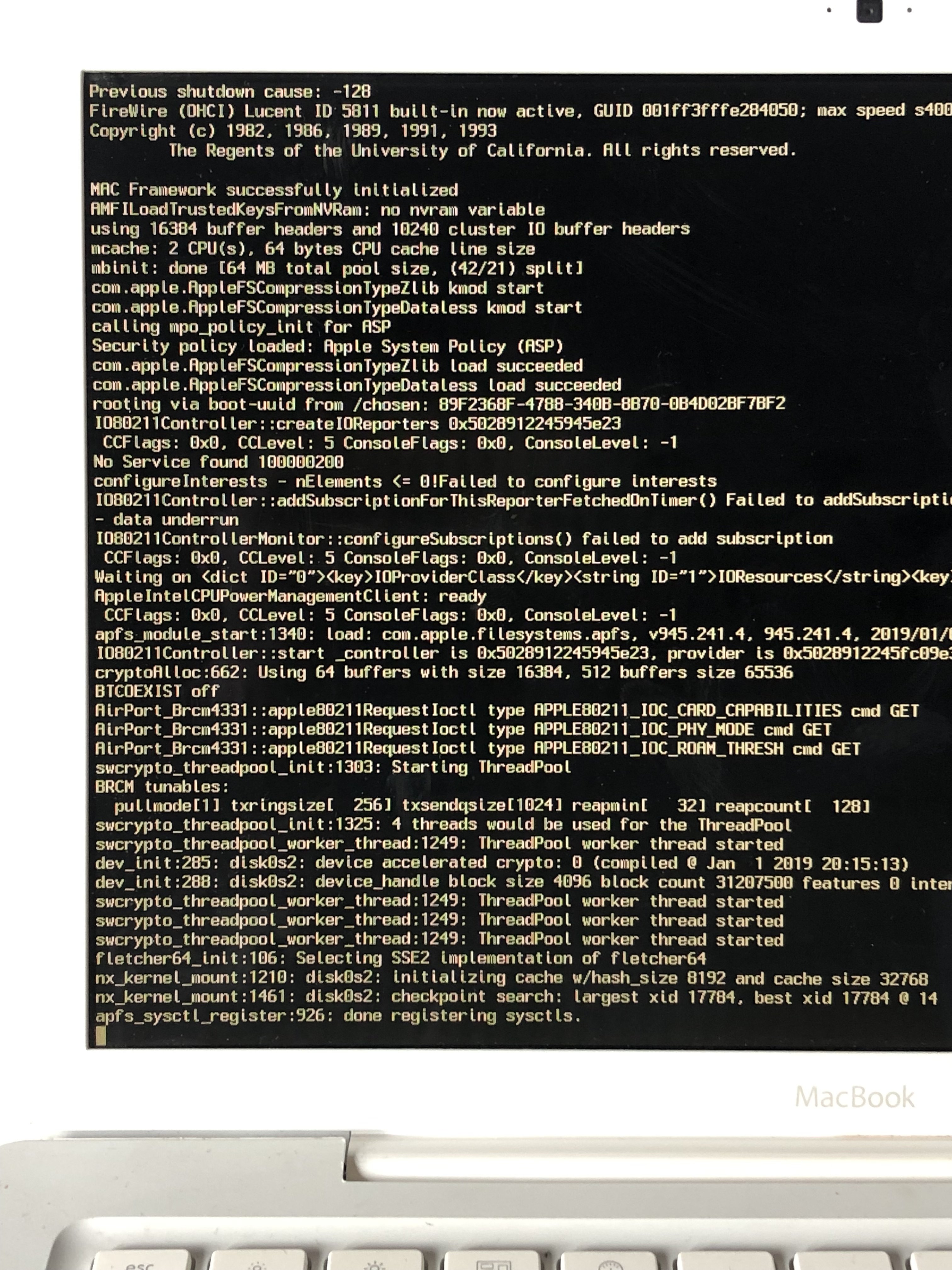

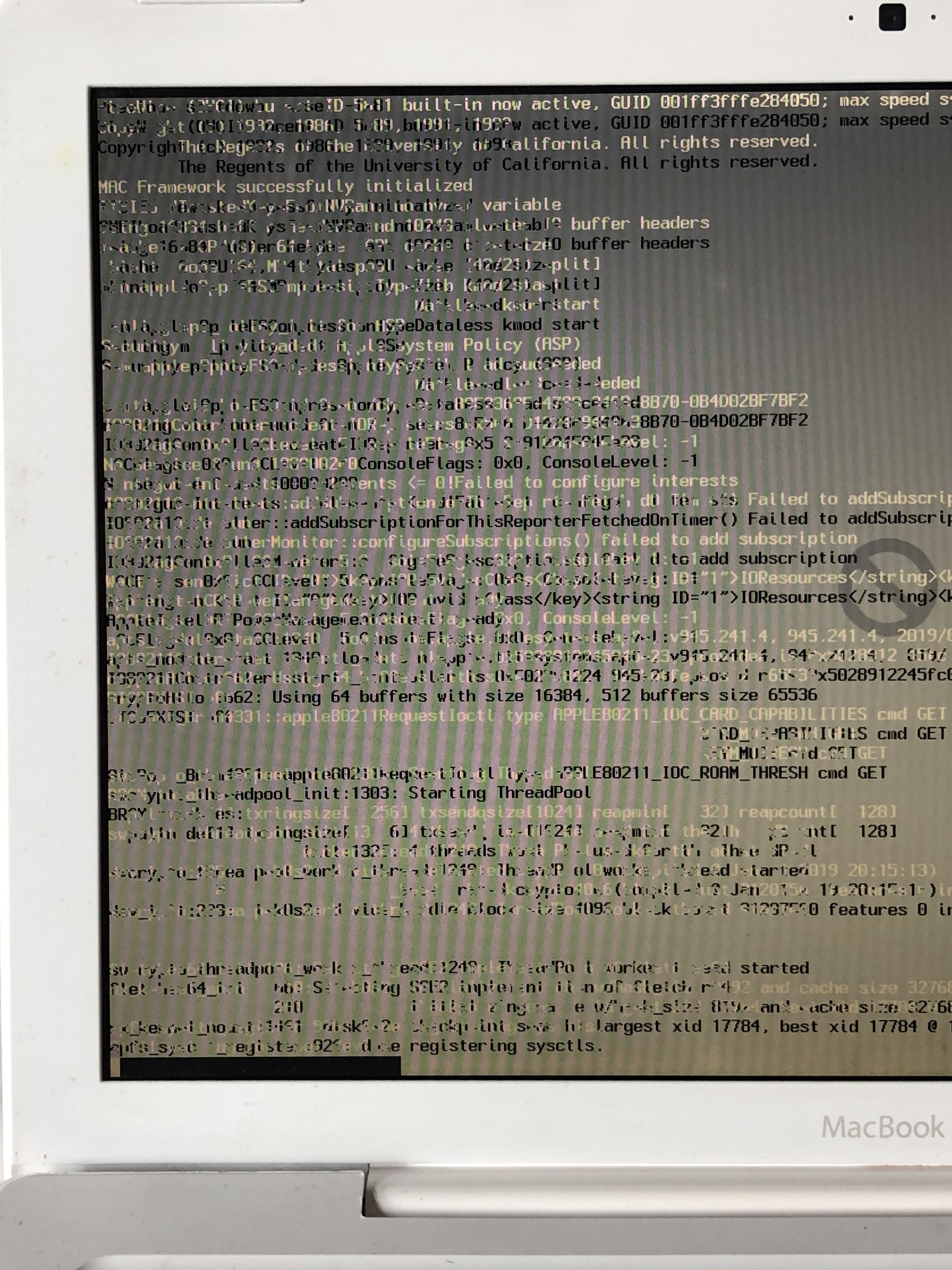

Tried your patcher today on a 10.14.4 b5 machine, using the 14.3.3 install image.
Same error here as already reported earlier, logging:
Patched graphics driver.
Patching installer package...
sed: 1: "s/nonSupportedModels.in ...": unterminated substitute pattern
Patched installer package.
Patching input drivers...
Patched input drivers.
Disabling System Integrity Protection...
Disabled System Integrity Protection.
Patching kernel exstension cache...
Patched kernel exstension cache.
Removing platform support check...
Removed platform support check.
Copying patcher utlities...
Copied patcher utlities.
Removing temporary files...
Removed temporary files.
I´ve tried the resulting install volume on three MacBooks:
- MacBook Air 4,1 -> boots perfectly
- MacBook 5,2 -> boots, but at install GUI you cannot move mouse (only up/down, not sideways)
- MacBook 4,1 -> fails to boot, USB gets detached after initial sequence leading to the already known garbled screen

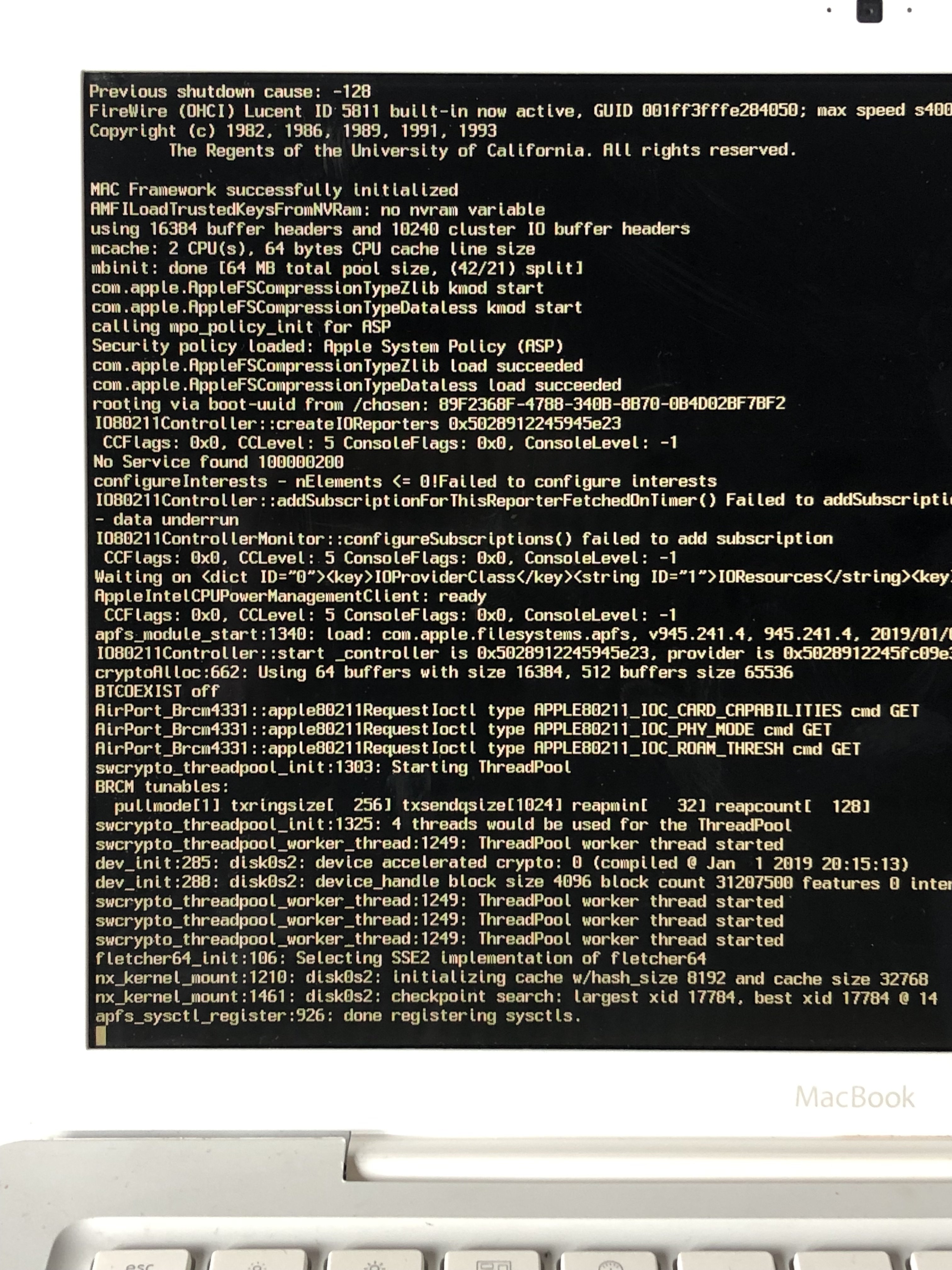

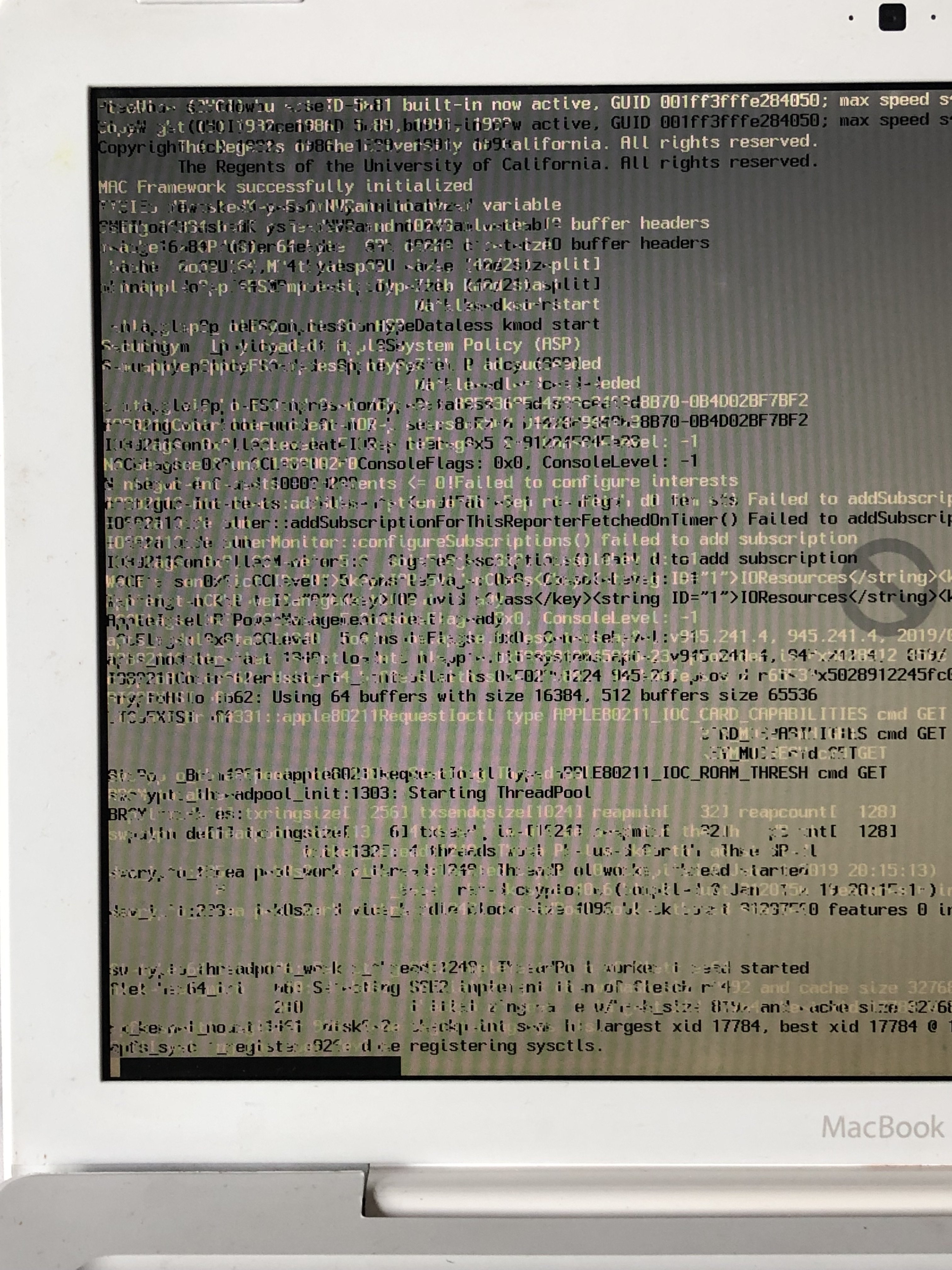

@0403979
This is the same with dosdude1’s tool though right?
Not quite. It has correct support on the 5,2 for trackpad. (The rest behaves as your installer).
What I wondered while I used your script/tool for the first time now:
Why is there a prelinked kernel for each macOS version (makes sense) but no distinction between destination platforms (i.e. there should be differences between a kernel for MacBook Pro 8,x vs. MacBook 4,1 or 5,2). I do not think there can be a one-version-fits-all prelinked kernel. So I´d expect that a query in your script will be necessary to reflect those different switch cases of which kexts and which kernels are to be copied onto the installer volume.
I might be totally wrong and there is some magic I do not understand, though. Just my thoughts on that matter.
I guess your "dropboxed" prelinkedkernel is built against the 10.14.4 beta kernel, while you should rebuild with a previous 10.14.x kernel, most often 10.14.0 kernel base version could potentially still boot any 10.14.x , but not vice versa of course.
The OSX Installers (and Recoveries) do not contain Kernels/kernel , only prelinked one.
Paradoxically when prelinkedkernel is build kernel can be deleted, but not the Extensions folder, because some are need a matching to continue booting.
Reactions: ASentientBot
That´s true, so we´d either have to wait for final 10.14.4 install image or I´d have to run the prelink process on a 10.14.3 machine again.
But then the result will only run correctly on a MB4,1, right? (See my assumption in my previous post).
