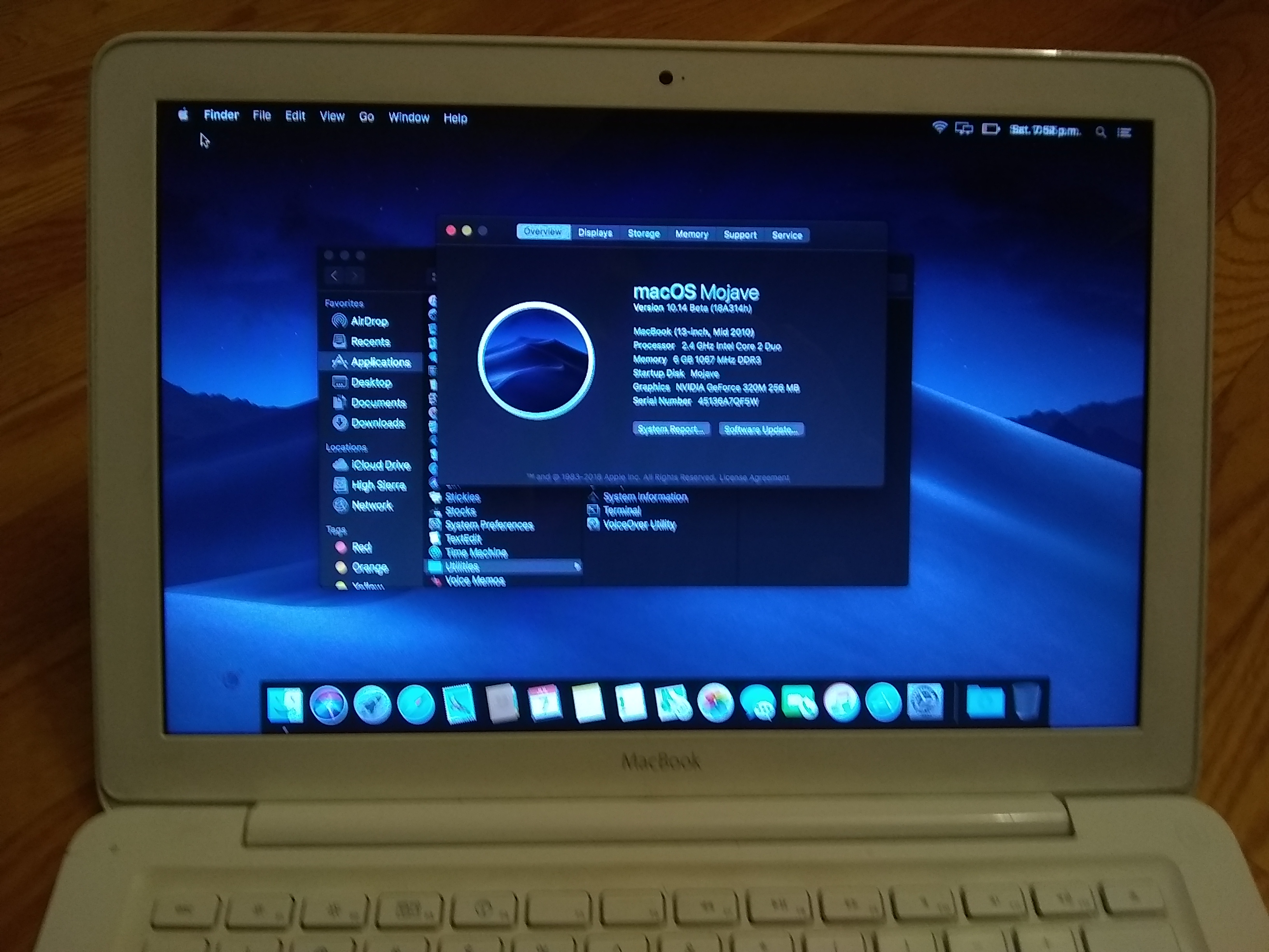

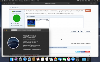

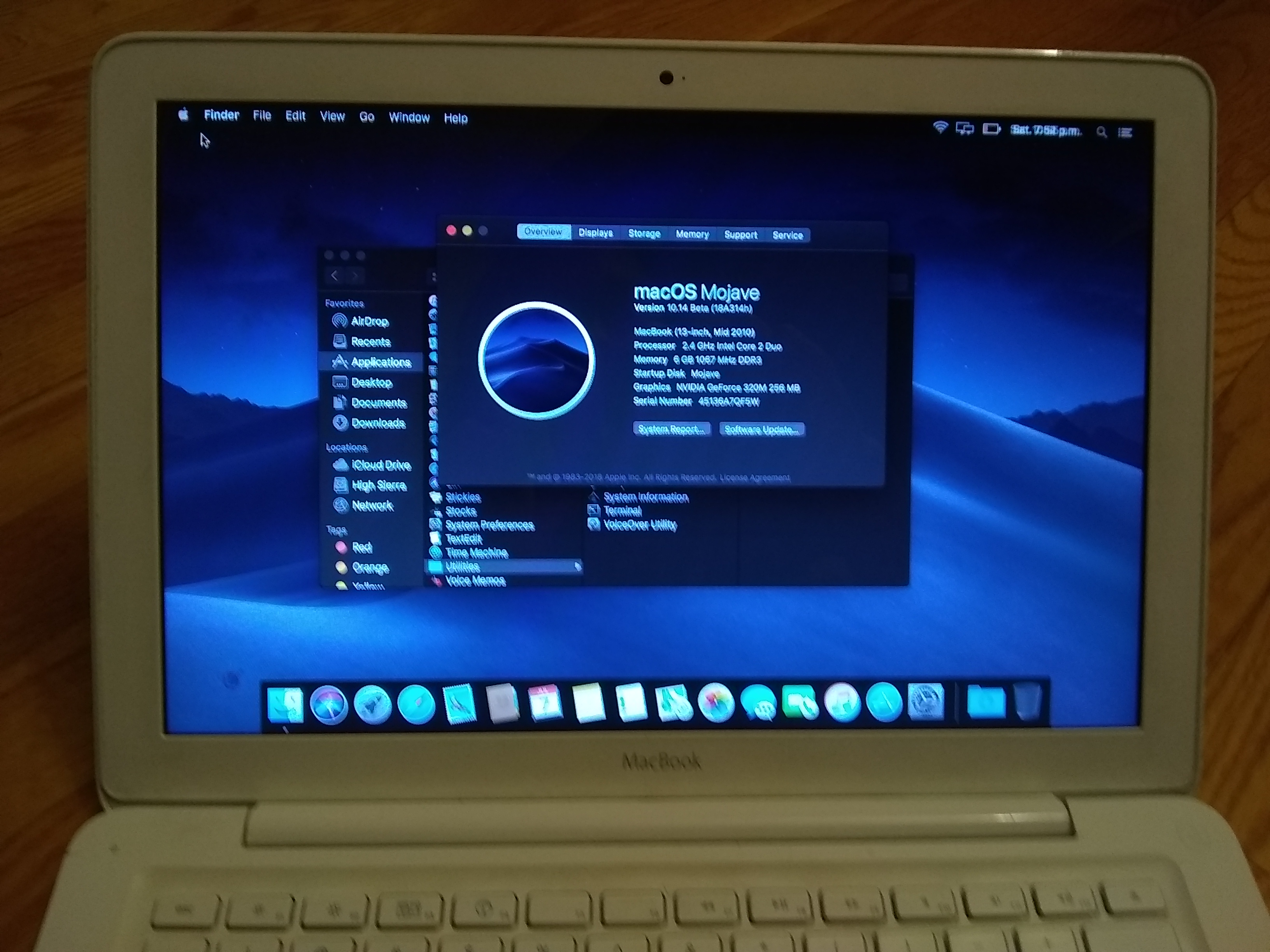

Just got to the setup assistant in Mojave on MacBook7,1 by replacing /S*/L*/UserEventPlugins from High Sierra!!!!!
Edit: And the desktop!! It's working, guys. Someone with a MacPro3,1 should give this a try!
Edit: I'm sending this message from Safari on Mojave on my MacBook7,1. No QE/CI of course, can't change the brightness, sleep does not seem to work, nor does sound. I'll be trying out some kext patching and further testing to figure out which UserEventPlugin is the culprit (there are 50-odd), but to @dosdude1 and others, hello from the first 2010 MB to ever not KP in Mojave 😀
Oh my god. I have been waiting for this day to come.
Same here, my friend. Still working on QE/CI (sound works by replacing AppleHDA.kext) but I'm hopeful this can be my primary OS someday soon 🙂
Once dosdude1 can confirm this patch he will be able to patch the usb installer with the trackpad and keyboard drivers and then we will be able to patch the system with it.

No grey screen and I didn’t notice anything strange on verbose mode.
Edit:
On verbose boot, noticed:
Unsupported CPU
Unsupported CPU
Unsupported PCH
Verbose mode? Detailed panic log? No instant reboot? sudo nvram boot-args="keepsyms=1 -v debug=0x100"
try that

One interesting issue:
NVDAResmanTesla will not load because it can't find the symbol _VSLGestalt in IONDRVSupport. So I replaced IONDRVSupport. But then it won't load because it can't find _IOGetHardwareClamshellState in IOGraphicsFamily. So I replaced that too. Hence those two files.
[doublepost=1531033516][/doublepost]
@ASentientBot If I install using your tutorial with the package installer. Will I be able to replace the UserEventPlugins KEXTS and then boot or am I missing something?
That was my experience, yes. (I don't believe UserEventPlugins are kexts, for what it's worth. The full path is /System/Library/UserEventPlugins/.)

I assume this machine used to panic outright though, didn't it? Or was that just the MB/MBPs?
Black screen sounds like a different issue. Do you ever get to a grey screen with a cursor? Maybe some simple logging scripts like mine (from which I found that UserEventPlugins was the culprit on my system) will help us make some progress. I unfortunately don't have a MacPro3,1 or I'd do some testing myself.
Noticed something on the verbose boot:
Unsupported CPU
Unsupported CPU
Unsupported PCH
