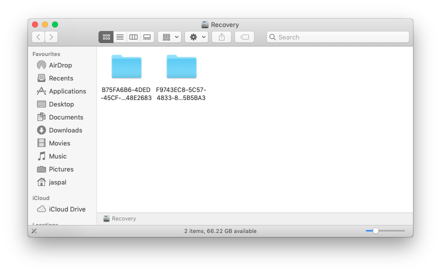

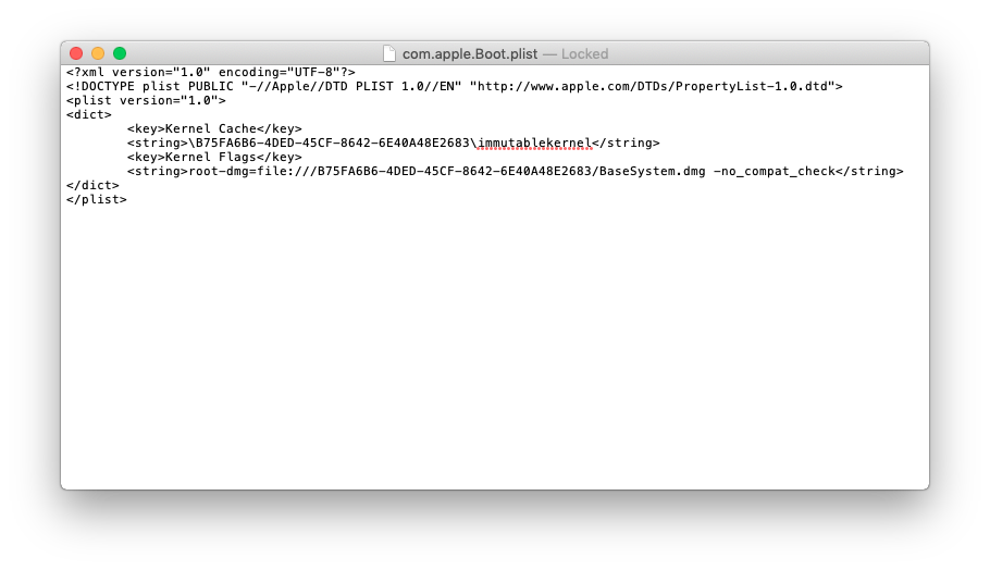

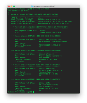

Thanks for the reply @jackluke I have followed this and I still cannot get the recovery to boot, CMD+R still gives me the prohibited sign. Heres what I did step by step,
diskutil mount disk1s3 < My recovery partition
open /Volumes/Recovery
Now I have two folders in here, both contain basesystem.dmg files, and com.apple.boot.plist files. I added the tag to the plist in both these folders, so my file now says " <string>root-dmg=file:///F9743EC8-5C57-4833-8842-D869525B5BA3/BaseSystem.dmg -no_compat_check</string>", and the same for the other folder plist respectively, with the other unique ID.
Please see screenshots, I can't figure what I'm doing wrong!
It's weird you still get prohibitory symbol, you have done correctly, but the only folder that represents your current APFS Mojave is the one starting with B75FA...2683 so you should consider only that.

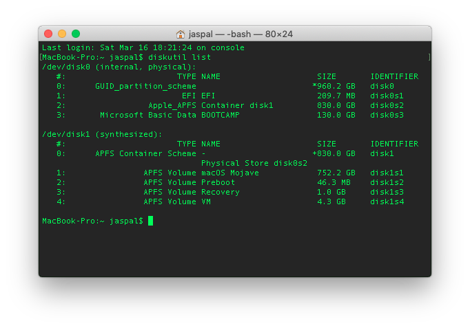

Meanwhile try this from Mojave Terminal:
diskutil apfs changeVolumeRole disk1s3 R
diskutil apfs updatePreboot disk1s1
sudo reboot
Reactions: Jas-Singh685

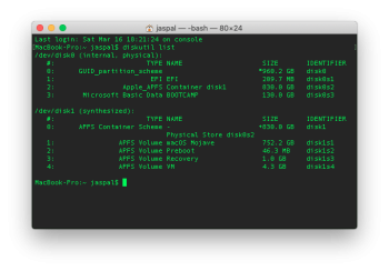

Thanks for the help @jackluke Unfortunately this still did not work, I still can't get into recovery! I did get a final confirmation upon the updatePreboot command
"UpdatePreboot: Exiting Update Preboot operation with overall error=(ZeroMeansSuccess)=0"
And if this means anything, I do have a BOOTCAMP partition on the same drive, could this be interfering? This all makes no sense! Recovery would work using the -no_compat_check when installed on an HFS volume, but not APFS, I don't understand!
