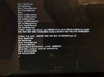

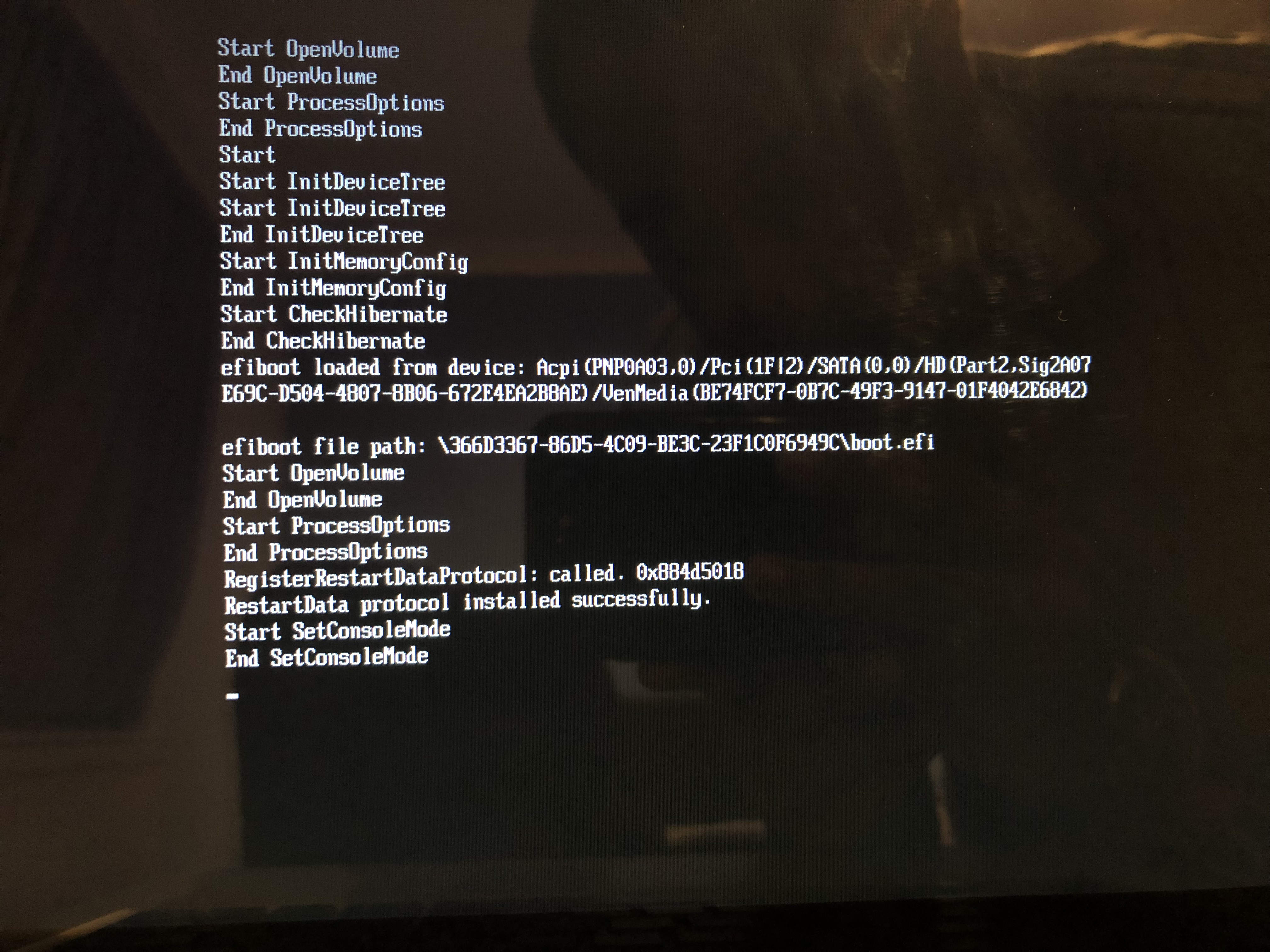

Apart "diskutil apfs updatepreboot /" I don't know another way how to set the right boot.efi to the correct APFS Volume, the fact you had two folders inside your /Volumes/Recovery means that something got wrong in past, but I think a next update could correct that. Meanwhile nvram parameters win over everything, so not a big issue.

You're right, in-fact from his previous pictures the APFS Recovery "com.apple.boot.plist" window appears "locked", while shouldn't.
