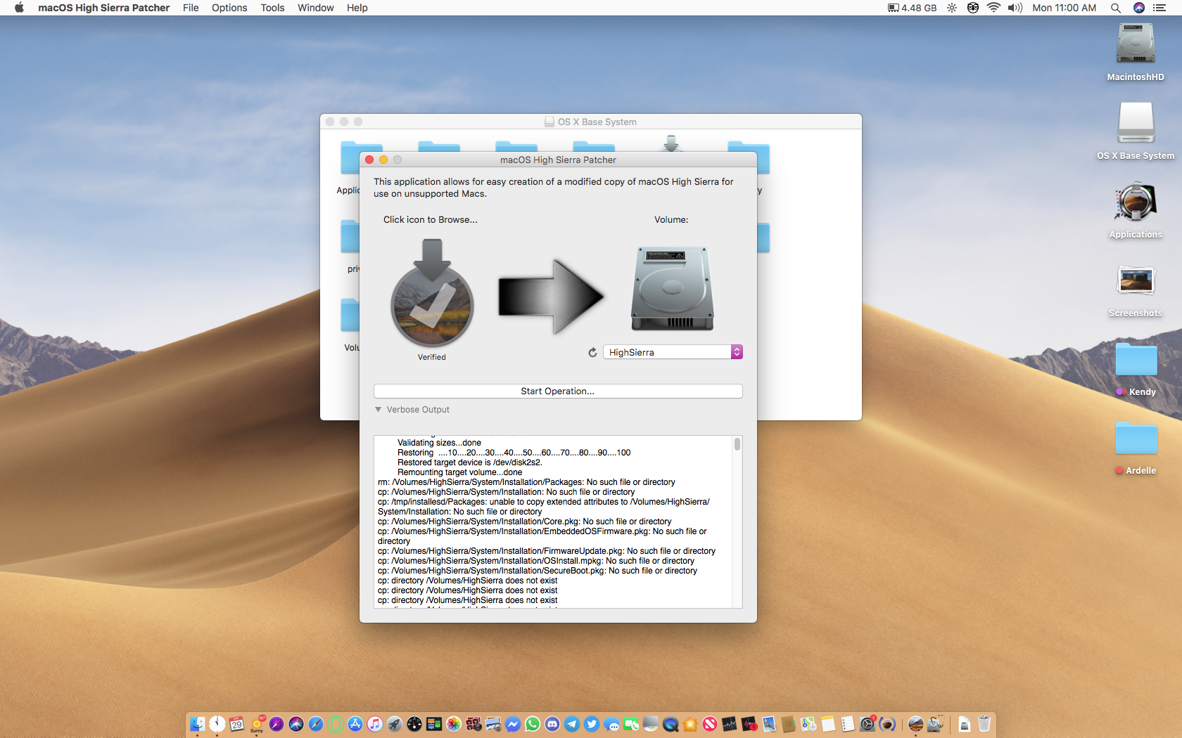

I bought a MacBook 7,1 and all I have for an old macOS is mountain lion but I want to install High Sierra but I keep getting this for every patcher I want to make and I just downloading 5.7 gigs of nothing
On Macbook7,1 you don't need the "patcher" just download HighSierra from here:
https://itunes.apple.com/us/app/macos-high-sierra/id1246284741?mt=12
and let it install officially from there.
Download size should be about 4.8 gb .

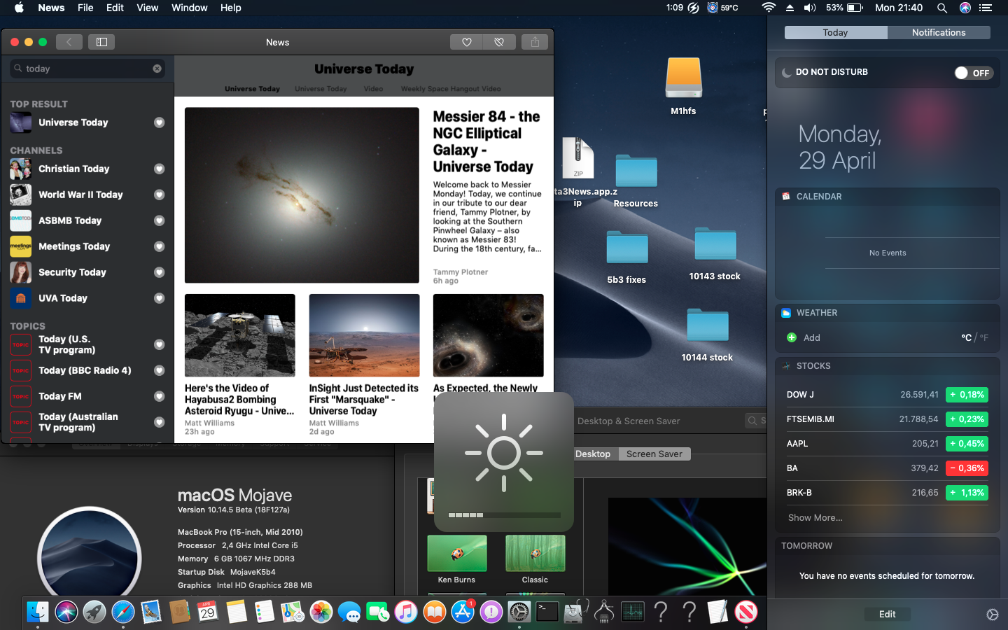

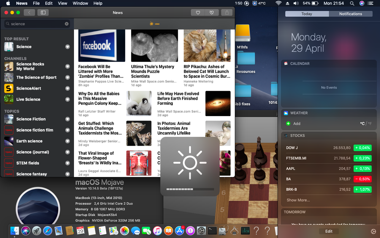

[doublepost=1556565227][/doublepost]Just downloaded and installed .5 beta 4 , ll share my experience soon
well well well lets start with first safe good news:
1) .3 OpenGL and .3 GPUSupport aka @dosdude1 patch + .4 CoreDisplay aka @ASentientBot patch still bring full QE/CI on .5 beta 4
2) "Flurry & Co." still work with acceleration
3) .5 beta 4 IOUSB* kext still work OOB
Now I move to the dualGPUs system
4) for dualGPUs to make correctly working MUX switching I confirm the same ".4 set" I used and shared in this post
Using the ".4 frame-kext-set" (included the GPUWrangler required to me for fast GPU MUX switching and power management) doesn't affect in any way the working order of any MacBook with single GPU, infact in both picture I attached are being used those ".4 set" .
In all my unsupported machines .5 beta 4 News.app doesn't crash.
@Larsvonhier .3 Siri patch is still required for Siri working.
For manual patching I just added an HighSierra replacements of AppleHDA.kext and telemetry.plugin (only for C2D).

[doublepost=1556571898][/doublepost]@hvds - one of the first I tried was switching from 94 to 96 on .5b4 and it was smooth (no KPs - no restarts) Obviously hasn't been stressed much but no glitches.
