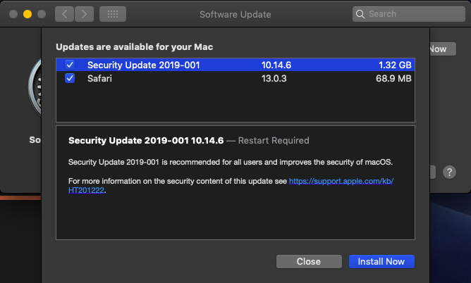

Is this Security Update 2019-001 and Safari 13.0.3 safe to install on my MacBookPro4,1 (17" Early 2008 MacBook Pro 2.6 GHZ Core 2 Duo, 6GB RAM, 500GB SSD) that's currently running Mojave 10.14.6 perfectly with macOS Mojave Patcher and bkltpatch10.14.2 ? It just showed up in Software Update
