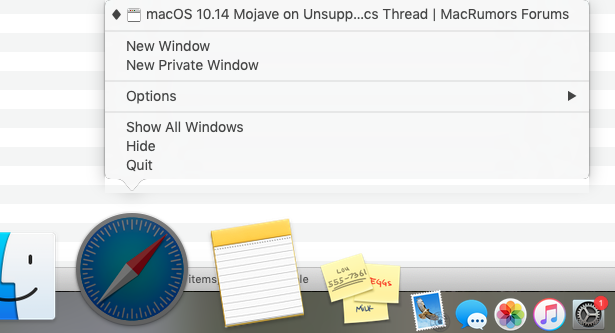

I installed the latest Legacy Video patch, and it works great 🙂👍👍👍 , except when you right click icons in the dock as the pic attached. This only happens when an app is open and showed on screen. As you may notice some short of shadowing is being presented.
Here too...
By the way, if anyone using the light mode wants just the Dock, Finder and menu bar into Dark mode:
Launch Terminal (located in /Applications/Utilities) and enter the following command:
sudo defaults write -g NSRequiresAquaSystemAppearance -bool Yes
Then logout or restart. Switch to Light mode. Only the "weird darkish mode" will be changed by black mode.
-> This is an excerpt from :
https://www.tekrevue.com/tip/only-dark-menu-bar-dock-mojave/
Mainly, whoever wants a Light Mode can have it working 99%, only the dock and top bar will be blank, but not “weird darkish grey”.
I currently prefer this mode 🙂 to fully white or black and is better than the weird one.
