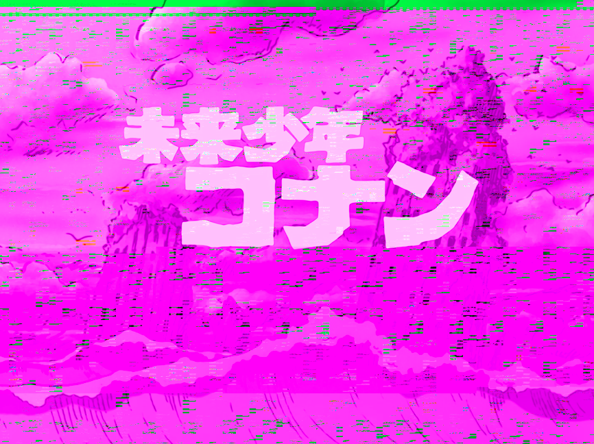

hi all
tnx dosdude for the patch.
I got a problem and I don't recall when it started (I had it perfect, no issues at all and suddenly it all messed up. don't know why nor when...)
the problem: all ProRes videos appear with green glitches (in preview / quicktime but not on vlc - here it is perfect). all other codecs (h264, etc..) are ok. so this is something related to apple Pro codecs. (it even happens before any pro codec sys update)
Mac Pro 3.1, 28gb ram, Ati Radeon HD 2600.
I´ve already tried a fresh install and the problem persists.
am I doing something wrong? (all patches updated correctly, no issues. I enabled legacy video card patch)
all videos are fine on other Macs. so the problem is in my machine.
help anyone?
tnx in adv.
ps - img attached > screenshot quicktime player of a ProRes LT video. (as I said in vlc it appears perfect...)
