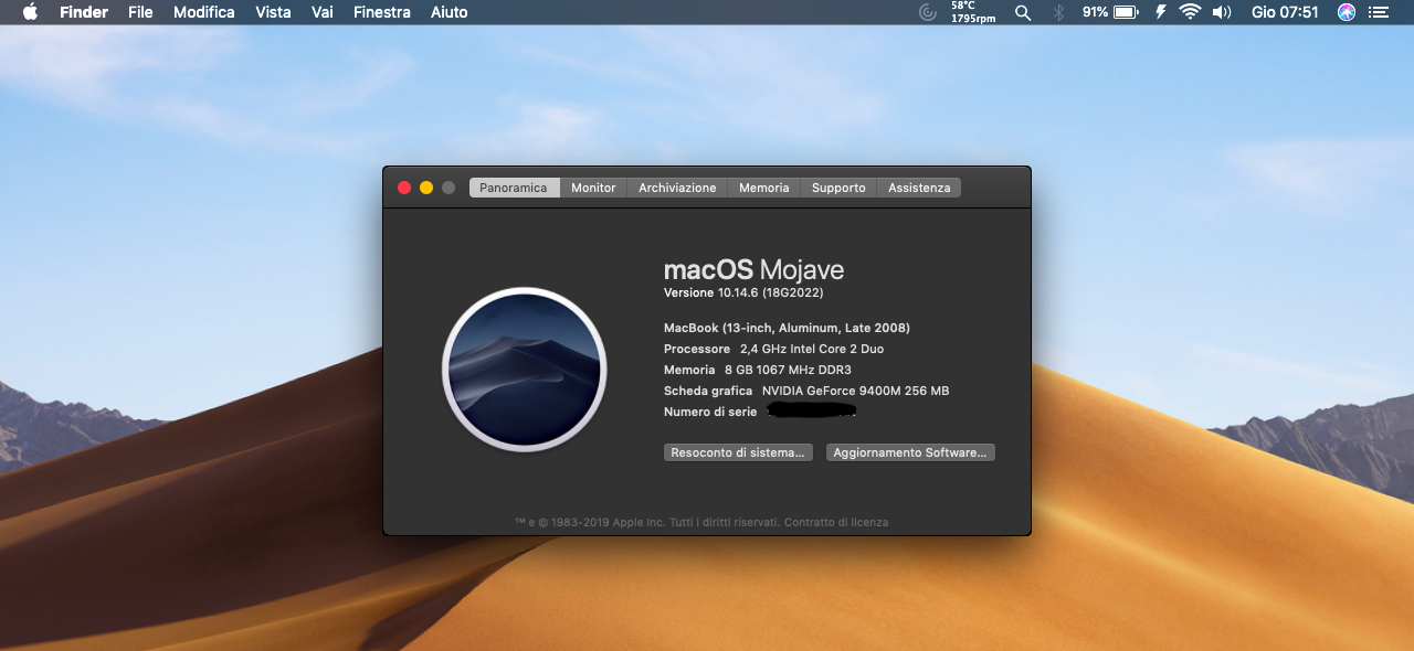

Installed the last update. After rebooting, I used the USB stick to install the dosdude post patcher. The system is restarted and now everything is OK.

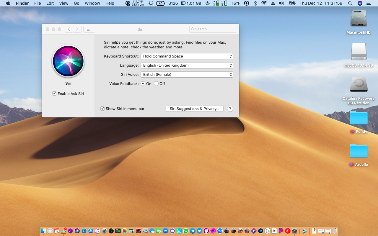

Since all have already used the @dosdude1 patch to install Mojave previously in unsupported Macs. This time to update the security updates and safari update in Mojave ,just run software update and install these updates.
After the computer boots you may loose Siri, sound card for some. Don't panic do the following.
1. You should run the @dosdude1 patch updater which may be in your utilities folder.
2. Select re install all patches
3. Restart you Pc and you should get back your sound and Siri.
4. For any reason you don't get Siri,
replace Siri.app (by v146.15.3 of 18G103) in / System/ Library/ CoreServices and
replace SiriUI.Framework in /S/L/PrivateFrameworks/SiriUI.framework (by v146.12.3 of 18G103)
5. You may locate these in Catalina thread after doing a search.
You are good to go after that. 😉

I've tried methods here for Siri fixes and can't find one to work for my MacBook 5'2. please help I actually use Siri and I'm on the latest security update.
[automerge]1576179506[/automerge]
! You need to disable Siri inSystem Preferences uncheck the box that's says enable Siri 2. Replace the Siri app in /System/Library/CoreServices folder. 3 Replace the SiriUI.framework in /System/Library/Private.frameworks folder. 4 Enable Sire in System Preferences
Same problem with Siri here. Running version 18G103. The files given are already in place on my system (17" Macbook Pro mid 2009 5,2) but Siri doesn't work (No animation and eventually says "Siri Audio Problem").
Hi,
Try this SiriUI.framework with Siri.app from @TimothyR734 #17,866
Please note, when copying select replace files, do not merge
Do not forget to modify the permissions with the Terminal commands "chmod" and "chown"
Code:
sudo chmod -R 755 /System/Library/CorreServices/Siri.app
sudo chown -R 0:0 /System/Library/CorreServices/Siri.app
sudo chmod -R 755 /System/Library/PrivateFrameworks/SiriUI.framework
sudo chown -R 0:0 /System/Library/PrivateFrameworks/SiriUI.framework
After rebooting, Siri should work with waveform
