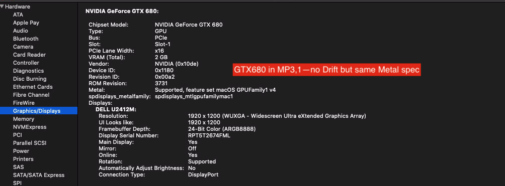

I wonder if the Drift screensaver requires Metal 2? It is confusing that Apple doesn't seem to explicitly list which GPUs are stuck on Metal 1. The Iris Plus 640 on my MacBook 14,1 under 10.14.5 still shows v1 so I assume, if those don't have feature set for Metal 2, that Apple will code most everything to Matal 1 until those machines are unsupported.
Here are two screenshots; one from supported MBA 7,2 which displays Drift OK and one from MP3,1 with GTX680 that does not. They both show the same Metal spec. Can someone else with an MP3,1 and GTX680 running Catb3 confirm Drift does not run?
And Ars says this:
"macOS_GPUFamily1_v3 is the official name for Metal 2 in High Sierra, which you can actually see in the System Information app under Graphics/Displays." so presumably Family1 v4 is Metal 2.
If so, something else is stopping Drift running.

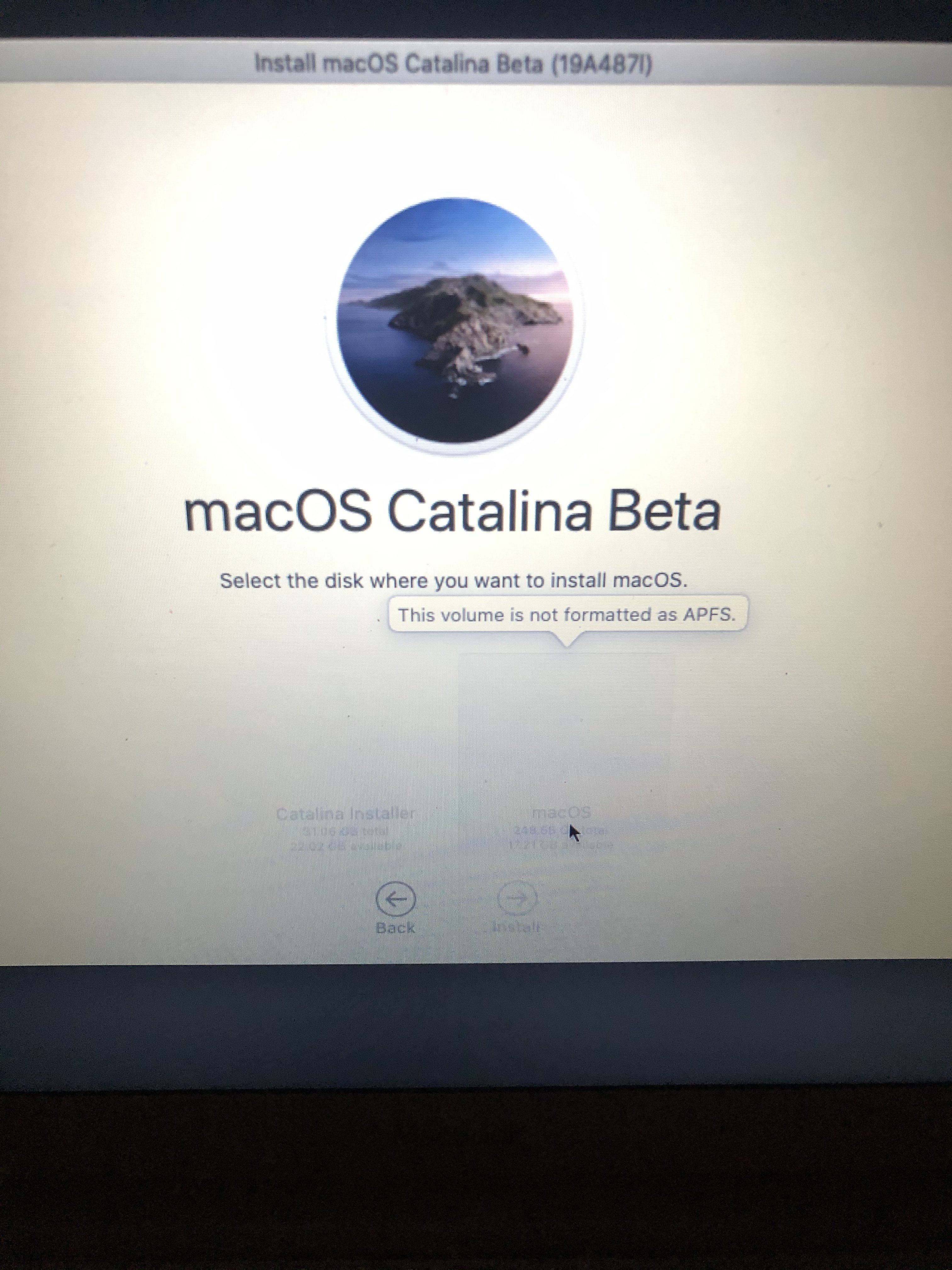

So...unless I've missed some kind of trick, the only way I can get this to install is if I reformat to APFS and lose everything??? At this moment I have no way to back up a 1/2 terabyte. Please someone tell me there's a way to get around this.
If I create an APFS partition on my hard disk and install there, is that a workable solution? Will I be able to access everything on the macOS Extended (Journaled) side of the house? I really don't want to admit defeat, here.
Well, for one you shouldn't be using this as your main OS, Catalina is still quite buggy. Secondly, at the very least, you should be doing a clean install on a separate hard disk or partition.
Is there a good rule of thumb re: how large the partition should be? Am I able to access my files from the non-APFS portion?

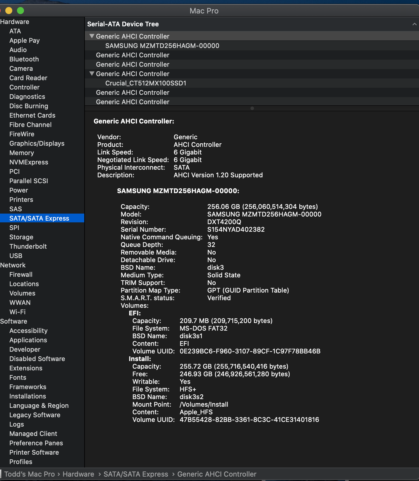

Five ways to get 6 Gb/s speed on SSDs on a Mac Pro 3,1.
  1. USB 3.0 support with optional Inateck PCIe card. Runs 6 Gb/s on 16x slot.
  2. Updated: The two internal SATA II ports behind the fans on the Mobo on the lower left run 3 Gb/s speed. To use the two internal SATA ports you have to route power from somewhere. If not using the DVD drives, you can use power from there. I use one DVD and one SATA III SSD. To get 6 Gb/s you can stripe two drives from these two hidden ports.
  3. Internal PCIe SSD on 16x slot also runs at 6 Gb/s speed.
  4. Stripe two SSDs on two of the four SATA II drive bays will result in 6 Gb/s speed (3 Gb/s x 2)
  5. Stripe two PCIe Card SSDs on two 4x slots (3 Gb/s x 2) Update: In Beta 3, my 4x PCIe Cards with SATA III SSD’s are working at 6 Gb/s each. I may take two of my 256’s and stripe them for greater Speed.

What do you mean with "two internal SATA III ports behind the fans on the Mobo"?
The Mac Pro 3,1 has two hidden internal SATA III ports. They are on the motherboard. The fans in the front where the cheese grater is there they are directly behind the fan. You have to remove the fans to get to them. And you have to use power from either the DVD drive cables with adapters or from one of the video power cables if you have one that's available.
I think Apple added it in the board design to use SATA DVD drives instead of ATAPI ones or it was just designed to add two more hard drives instead of DVDs.
Update: The 4x PCI slots can negotiate at 6 Gb/s. The hidden SATA ports are SATA II. My bad.
Yes I know. But they are SATA II. Not even the Mac Pro 5.1 have SATA III.
Yes I know. But they aare SATA II. Not even the Mac Pro 5.1 have SATA III.
Nevermind, My 4x PCIe slots are negotiating at 6 Gb/s. Arg. I have SSDs everywhere.
The two hidden SATA ports are SATA II, but you could stripe them to get 6 Gb/s.

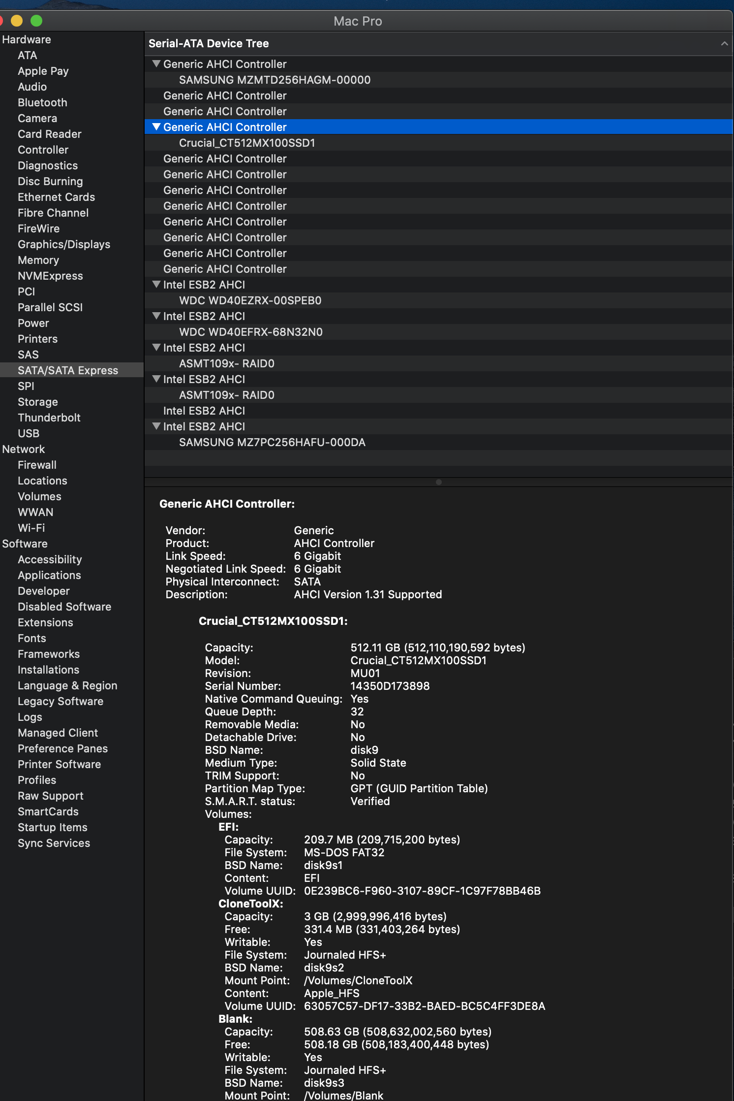

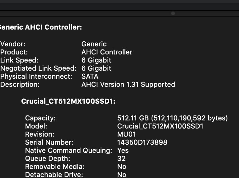

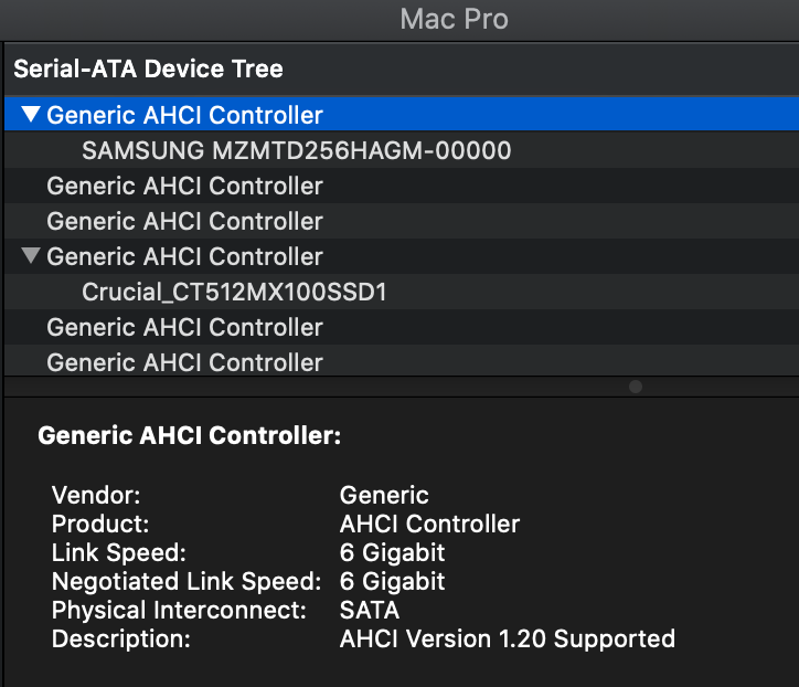

A PCIe 2.0 x1 connection works at 5GT/s 8b/10b (500MB/s without accounting for overhead, with overhead it's around 350MB/s).
A PCIe 2.0 x4 is 2000MB/s, with around 1500MB/s usable after overhead.
6Gbps is a SATAIII connection.
I showed screen captures of the 4x slots negotiating at 6Gb/s.
Reactions: TimothyR734
Your screenshot show a SSD connected to a PCIe SATAIII card, you are using wrong terminology since you can't connect a SATA drive to a PCIe slot without a PCIe SATA card.
What? The SATA3 SSDs with PCIe card on the 4x slot is negotiating at 6gb/s. How is this the wrong terminology?
Previously to beta 3, I have only seen them negotiate at 3Gb/s on a 4x slot and usually only on a 16 x slot you get 6Gb/s on a SATA3 SSD.
Previously to beta 3, I have only seen them negotiate at 3Gb/s.
Yes it's wrong. You probably wanted to write that you have a PCIe SATA III card:
"Update: The PCIe SATA III card can negotiate at 6 Gb/s. The hidden SATA ports are SATA II. My bad."
You only connect PCIe drives (SAS/PCIe AHCI/NVMe) to the PCIe slots directly.
