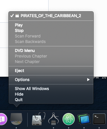

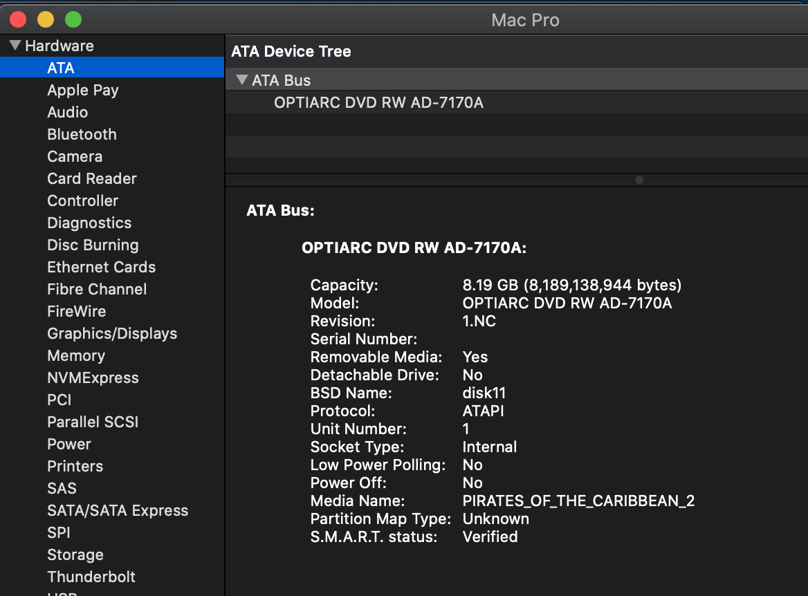

I can confirm the DVD player on Catalina B3 works with the Internal Super Drive with the IOATAFamily.kext from Catalina Beta 2. If you don't have Catalina B2, you can get take the IOATAFamily.kext from the Mojave 10.14.5. They both have the AppleIntelPIIXATA.kext.
Side note: To mount Mac OS Standard HFS discs [pre HFS+], you can use HFS.kext and HFSEncodings.kext from Mojave 10.14.5,. without these kext replacements older HFS discs will not mount and may crash the Finder as well.
You don't need to replace the entire IOATAFamily.kext. All you need to do is add the Mojave AppleIntelPIIXATA.kext into the Plugins directory of the Catalina IOATAFamily.kext which is what dosdude1's 1.0b7 patcher does.
Good to know. Does it pass signing?
I checked the versions #'s between Catalina Beta 2 and Mojave 10.14.5, and they are the same.
I like to use the entire IOATAFamily.kext so this parent kext passes signing. I also prefer using the set signed for Catalina which is in Beta 2. You don't need the one from Mojave. And if only using the one from Mojave you will have one kext signed for Mojave, 2 signed for Catalina and I think it will break the signing of the IOATAFamily.kext itself. I try to preserve signing as much as I can.
Reactions: TimothyR734
Yes. It appears that the signing is self contained within the individual kext in the plugins directory.

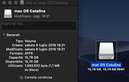

How it is possible, without a APFS patched macmini4,1 ?
I have installed the OfficialfirmwareUpdate (succesfully) and then used the APFS ROM patcher (got same incompatibility message) ... Strangely, after an initial error partitioning the pendrive, I have managed to format a 16 GB USB pendrive to APFS without the ROM patched ??? ...but I need at least 22GB to install Catalina and I cannot replicate this behaviour on a bigger pendrive...
