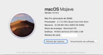

@nekton1 - some nice throuput there - sure beats my old OWC Mercury. But is it worth spending $300 and beyond on a box selling for less than a Bengie?
I paid 90 bucks for my Mac Pro 3,1 8 Core 3.2 GHz box that was just sitting there collecting dust at my work. I know in the last year, I spent a lot on it, but it is running like a champ and it's been fun doing the upgrades.
3TB SSD total storage space, 8 TB total HD space, 4k display, logi HD cam, Steel Series head phones, iMac Pro style Magic 2 Keyboard and Magic 2 track pad, USB 3.0, Two PCIe SATA III expansion cards. One USB 3.0 PCIe expansion card. New in Box Galaxy Nvidia GeForce 2 GB PCIe graphics card. New 802.11ac and BT4 coming soon. Original Internal SuperDrive. It had two. I removed one and added a SSD there. A couple USB Audio adapters. One I use for headphones / Mic. Also have a Samsung sound bar with analog, digital, BT, USB, and HDMI outputs. Two additional displays that I had lying around. One is the TV that I won and another was from my MAME station.
It is nice having 9 USB ports (4 USB 3.0, 5 USB 2.0)
Every slot is filed in this box. I finally had to put the side cover back on to keep it cool.

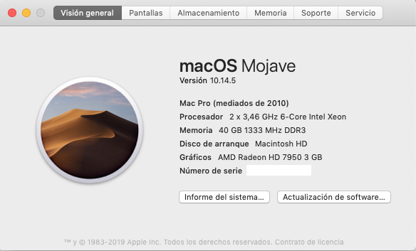

I was a bit inaccurate, the "MTLDriver" as the "GLDriver" as any other ".bundle" is not showed in "kextstat" or as loaded kext/bundle but almost surely is loaded in your case, hence I still think your AMD Radeon HD 7950 is a full Metal GPU and could work on Mojave and Catalina too.
I have one of those. Full metal GPU.

I also have a 3.1 running Mojave, and it´s a great machine. Similar in geekbench to my Macbook Pro late 2011. An AHCI, a CalDigit FASTA-6GU3 and a BCM94360CD make it a very satisfactory computer. 24/365 on during years and never failured.

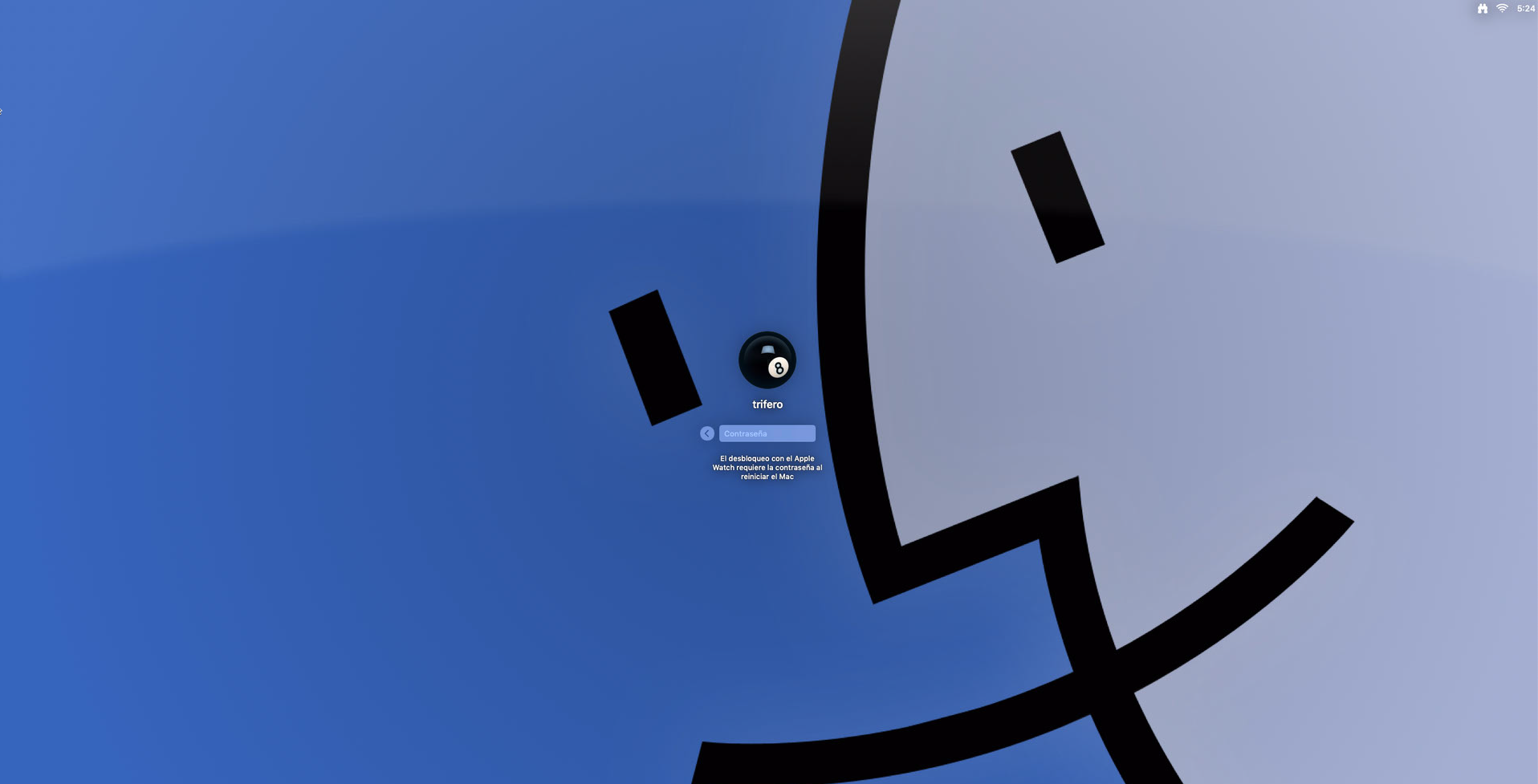

Mac Pro 2019 plays in another league. Above the usual "Pro". Not too much people needs such power, in my opinion.

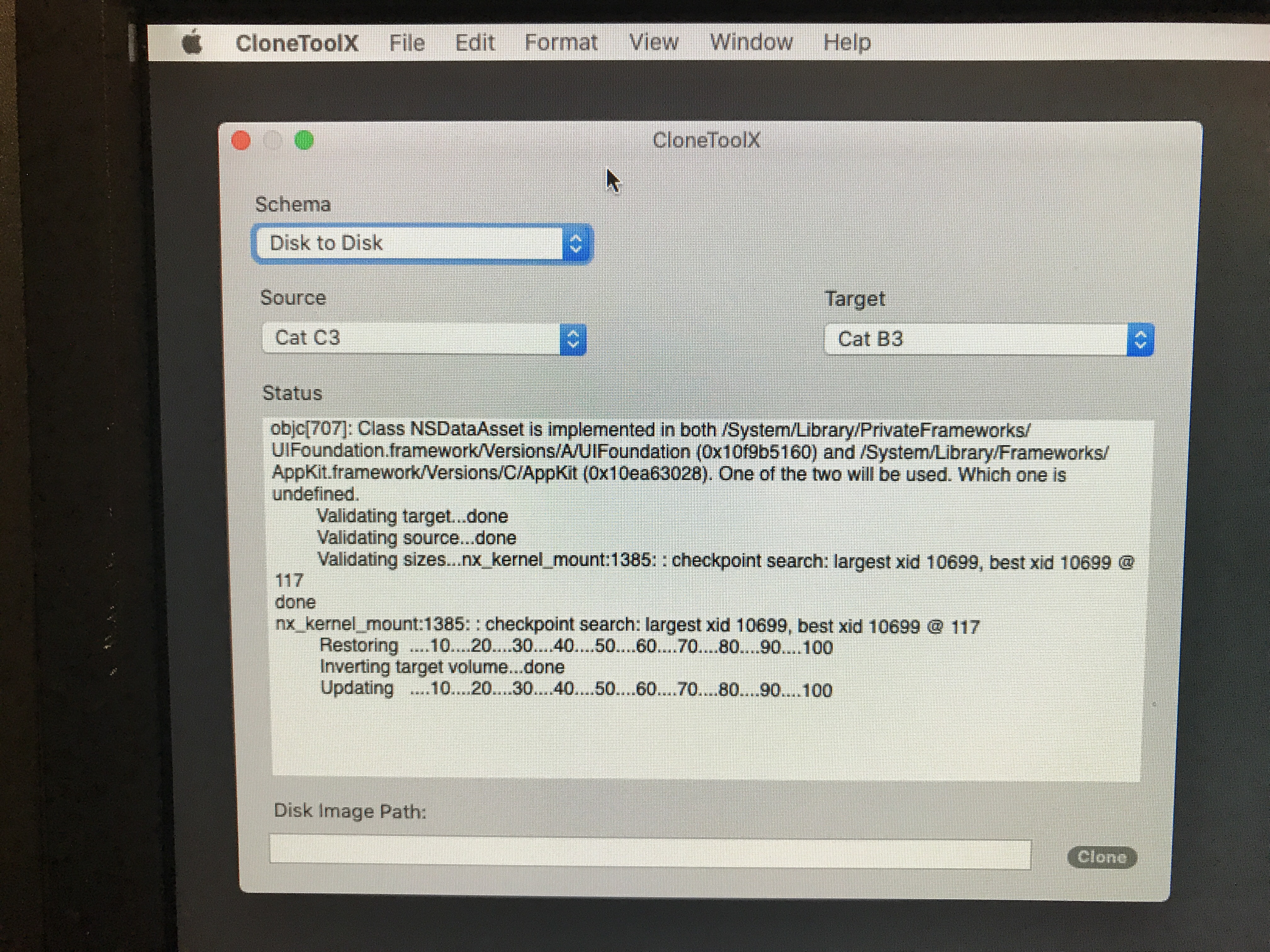

I have disk to disk cloning working. I revamped its logic for HFS and APFS volumes: will be going back to catch the other two schemes up which are disk to image and image to disk.
Then I will be doing a good bit of my own testing making corrections along the way, and then I’l start looking for a few key members first to test it and get their feedback.
The goal is gonna be to have it ready for the public when Catalina reaches GM.
