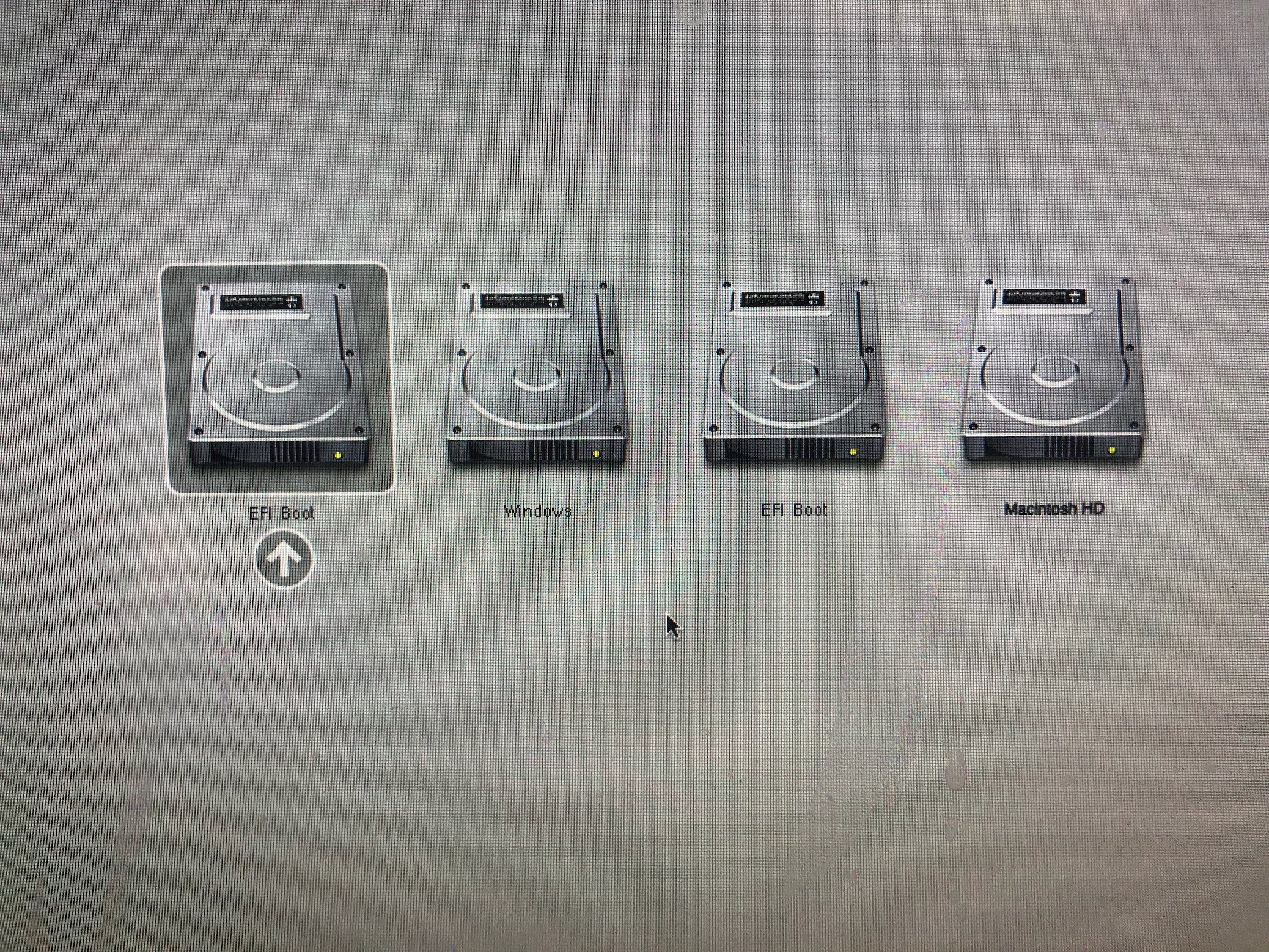

Does that imply that now, on machines with the APFS ROM patch applied, that we will have three disks polluting the option boot screen (the APFS volume, the duplicate EFI Boot volume that the APFS ROM patch creates and now a third EFI boot volume holding the APFS patch)? Ugh.
If so, could you please add an option to the Catalina Patcher to allow users to create a customized usb installer that has the APFS ROM patch off by default?
From my experience, you are not going to have three disks(just an EFI Boot and the APFS partition). Also, it is false to say that EFI Boot volume is entirely useless. Granted it might be a very rare occasion for most but I personally came across a situation(twice) where I desperately needed an EFI Boot volume to be there for me.
Especially as you'll end up with a yet another icon congesting the boot selector on APFS ROM patched machines otherwise.
I know it's inconvenient but if you delete or don't have any "EFI disk0s1 volume" on your internal disk, you can plug and use any HFS+ formatted usb drive (diskXsY) acting as external EFI bootloader (for the internal volumes), that will contain surely another EFI diskXs1 volume, since any EFI/UEFI machine after power-on search first for a FAT32 Boot-able partition.
That said having the EFI partition internally is without doubt very handy.
Simply copying a HFS volume onto a APFS volume won't create the normal APFS boot partitions. You should see...

The fact that you don't have an icon under the actual volume name for the APFS volume for the APFS ROM patched MacPro 3,1's option boot selector is a huge red flag.

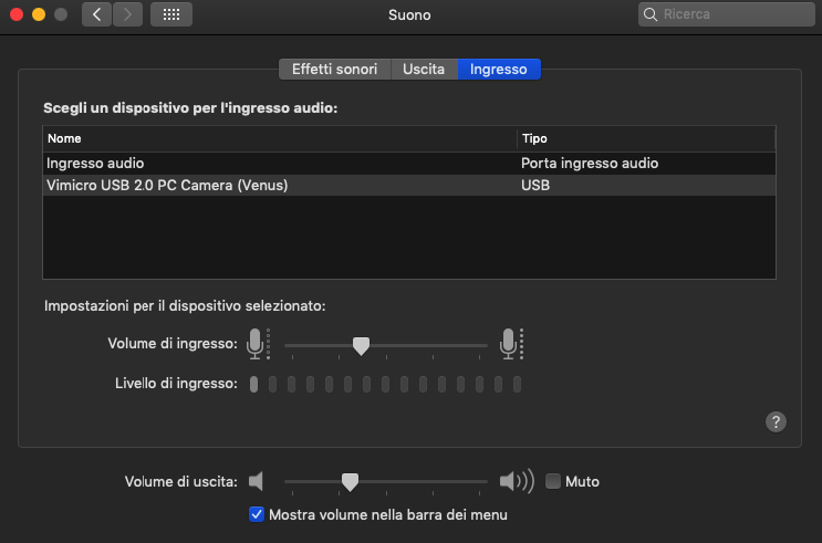

This is my Mojave sound setup on Macmini 2010.
The Vmicro USB 2.0 PC Camera SOUND IN option is missing on Catalina (not shown)
but the video feature works. Any idea about how to fix? (I'm using the writing option with Siri)

Right, Macmini doesn't have an embedded microphone, but only a little output speaker.
To try fix it I guess you should use the 5 (five) IOUSB*.kext non-patched from Catalina and maybe removing the LegacyUSBInjector kext, I write this because your Macmini 2010 hardware is almost identical to the MacBook7,1 .
Or you could try to use a 3.5 mm microphone and plug in the proper audio input behind the macmini.
example: https://i.stack.imgur.com/E2j9i.png

@jackluke Luckily there is the right option in "Accessibility" , but I try your fix :)
You may also check inside Catlaina Sys Pref - Security & Privacy (tab)
if in "Camera" or "Microphone" (left tab) something is disabled or unallowed.
But I guess it's something more related to the Catalina USB driver not properly loaded for the audio compartment.
For example I used a third party usb device with an el capitan driver that worked till Mojave, but on Catalina the driver is loaded but the device is not recognized (even if detected in system report).

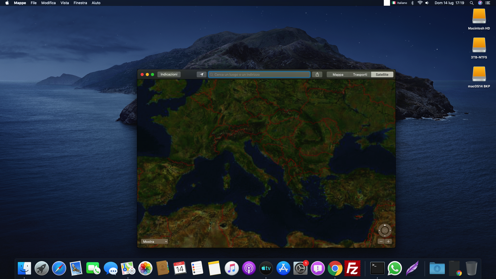

I must have missed that i though it was a collaborative effort. Does ANYONE have a fix for apps like Maps and Photos? Is it even possible? If it's not I'd just like to know to downgrade.
Dosdude said that they are unlikely to work on non-metal systems. It's one of the reasons I reinstalled High Sierra. You can downgrade by downloading a copy of macOS from the App Store and creating a bootable drive, then reinstall. You will need to back up as it will wipe the drive.

Dosdude said that they are unlikely to work on non-metal graphics cards due to Metal requirements. It's one of the reasons I reinstalled High Sierra. You can downgrade by downloading a copy of macOS from the App Store and creating a bootable drive, then reinstall. You will need to back up as it will wipe the drive.
Works already now, with non-metal graphic cards, thanks to the geniality of @dosdude1 and @ASentientBot and we are only at first betas. I'm confident that I will have Catalina fully working before October's GM release.
