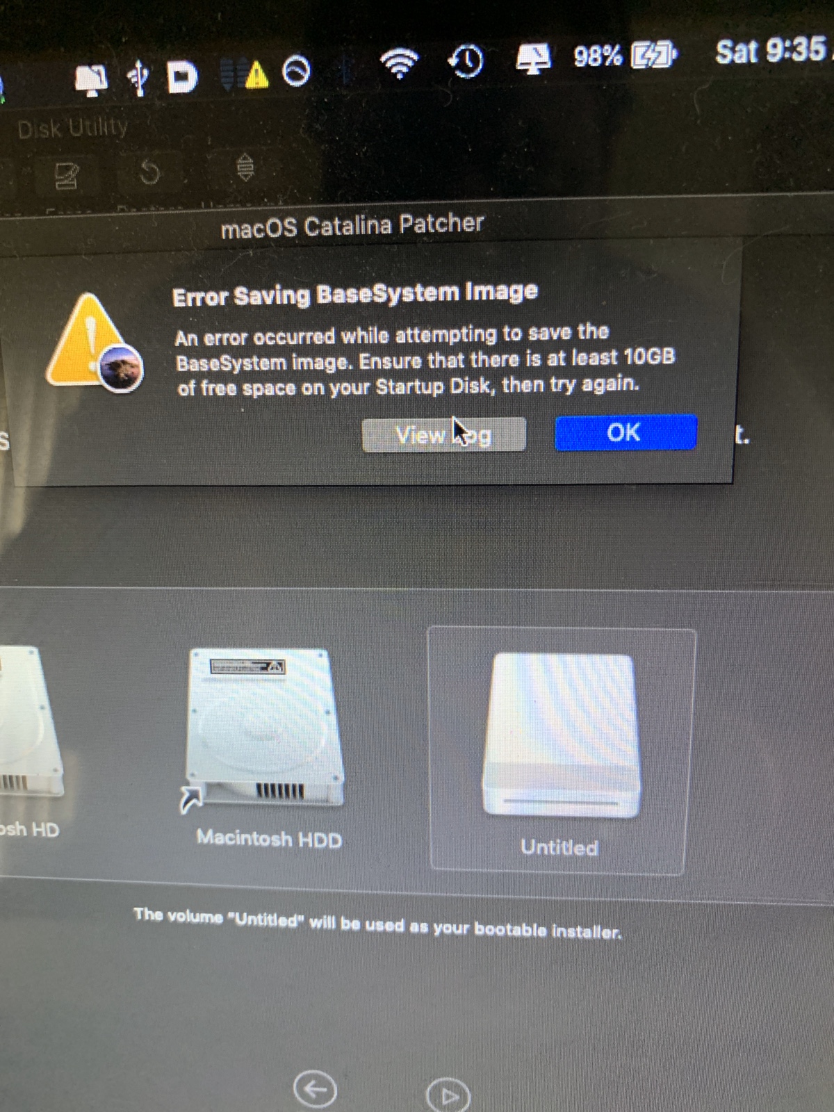

Hi, @0403979, thanks for making a new version of Catalina Patcher! I tried to create an installer disk with your beta 6 patch file, but continually got the following error messages. I have tried that with a 16GB and 32GB USB disk but got the same result and the installer disk can successfully install the latest Catalina but can't patch the OS, there is no output commands after typing "patch". I think the reason is because of those errors during the creation of the install disk. Could you have a check on this? Thank you! And here is the log file with those errors:
/ Input a volume name.
/ Macintosh HD
/ SANDISK
/ SANDISK
+ Unmounted installer disk images.
> Creating installer disk.
> Created installer disk.
+ Renamed installer volume.
+ Mounting BaseSystem disk image.
+ Patched installer files.
+ Patched input drivers.
+ Patched platform support check.
+ Patched kernel cache.
+ Patched System Integrity Protection.
> Copying patcher utilities.
cp: /tmp/Base System/usr/patch/AMDRadeonX3000GLDriver.bundle/Contents/Libraries/AMDil.dylib: No space left on device
cp: /tmp/Base System/usr/patch/AMDRadeonX3000GLDriver.bundle/Contents/Libraries/libCLVMAMDilPlugin.dylib: No space left on device
cp: /tmp/Base System/usr/patch/AppleIntelHD3000Graphics.kext/Contents/MacOS/AppleIntelHD3000Graphics: No space left on device
cp: /tmp/Base System/usr/patch/IOGraphicsFamily.kext/IOGraphicsFamily: No space left on device
cp: /tmp/Base System/usr/patch/AppleIntelFramebufferAzul.kext/Contents/MacOS/AppleIntelFramebufferAzul: No space left on device
cp: /tmp/Base System/usr/patch/AMDShared.bundle/Contents/_CodeSignature/CodeResources: No space left on device
cp: /tmp/Base System/usr/patch/AMDShared.bundle/Contents/MacOS/AMDSharedIL: No space left on device
cp: /tmp/Base System/usr/patch/AMDShared.bundle/Contents/PlugIns/libAMDMtlCompilerPlugin.dylib: No space left on device
cp: /tmp/Base System/usr/patch/AMDShared.bundle/Contents/Resources/runtime.amdil_si.bc: No space left on device
cp: /tmp/Base System/usr/patch/AMDShared.bundle/Contents/Resources/runtime.amdil_si.builtin: No space left on device
cp: /tmp/Base System/usr/patch/AMDShared.bundle/Contents/Info.plist: No space left on device
cp: /tmp/Base System/usr/patch/AMDShared.bundle/Contents/PkgInfo: No space left on device
cp: /tmp/Base System/usr/patch/AMDShared.bundle/Contents/version.plist: No space left on device
cp: /tmp/Base System/usr/patch/AMD3800Controller.kext/Contents/_CodeSignature/CodeResources: No space left on device
cp: /tmp/Base System/usr/patch/AMD3800Controller.kext/Contents/MacOS/AMD3800Controller: No space left on device
cp: /tmp/Base System/usr/patch/AMD3800Controller.kext/Contents/Info.plist: No space left on device
cp: /tmp/Base System/usr/patch/AMD3800Controller.kext/Contents/version.plist: No space left on device
cp: /tmp/Base System/usr/bin/patch: No space left on device
+ Copied patcher utilities.
+ Unmounted BaseSystem disk image.
+ Converted BaseSystem disk image.
+ Mounted InstallESD disk image.
+ Patched installer package.
+ Unmounted InstallESD disk image.
+ Converting InstallESD disk image.
+ Removed temporary files.
/ Thank you for using macOS Patcher.

I've seen this issue many times but I don't know what it is. Can you give me the size of your hard drive, your installer drive, and the amount of RAM you have?
The size of my hard drive is 512GB ssd, the size of my installer drive is 16GB or 32GB USB disk, and the RAM is 16GB. My laptop is a mid-2015 MacBook Pro.
Reactions: TimothyR734
How much space do you available on your hard drive? macOS Patcher stores temporary modifications on the drive where the macOS installer app is located before copying them to the installer drive. This could be the cause of your no space left issue.

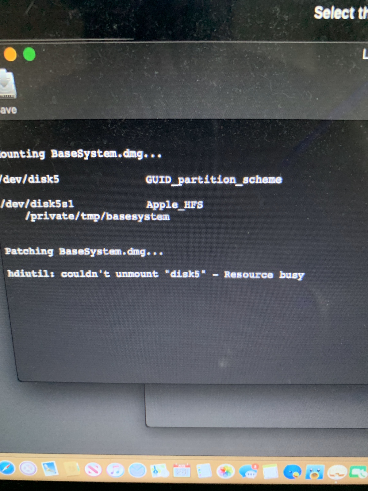

I need help getting pass this
Just restart your machine, then try the process again and it should work.
Definitely not. I have more than 300GB available space left. And I have tried to create the installer disk on three different machines and all have got the same result. Such an installer disk created with those errors appeared can successfully install Catalina but can't patch. No command lines output when typing "patch". Really don't know what the problem is.
