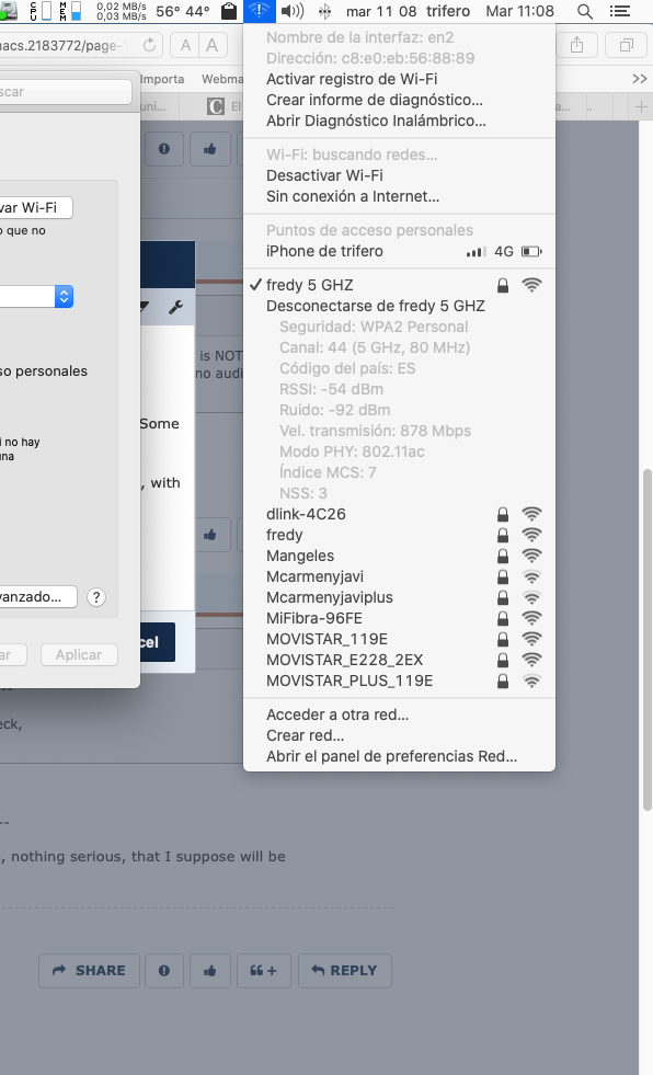

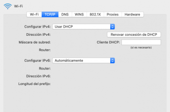

[doublepost=1568711107][/doublepost]I must say DP8 runs extremely nice in my Mac Pro 5,1 Some odd things, nothing serious, that I suppose will be polished in the final release.
For instance, The wifi appears as not connected, even in the icon ans in the System Preferences, with no IP assigned. But runs nice. Even faster than in Mojave.

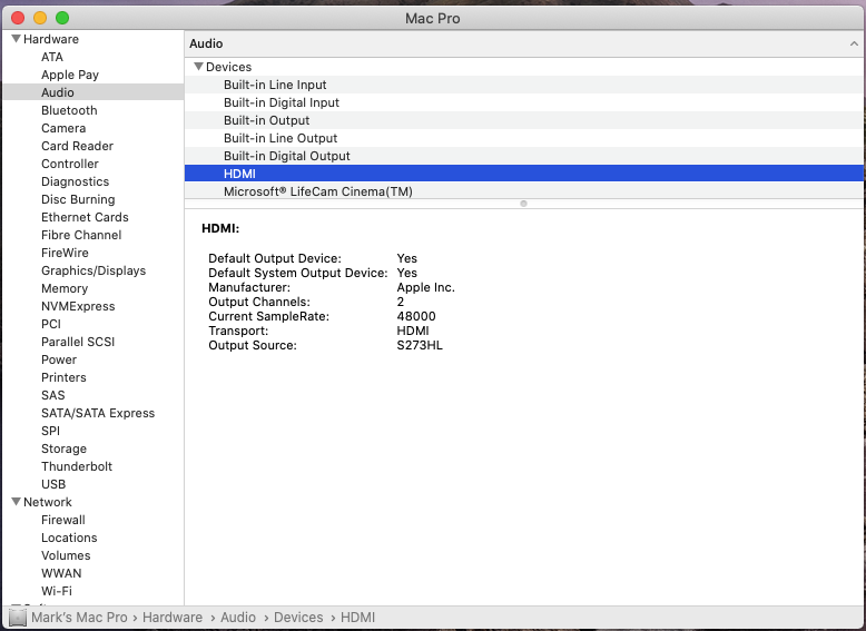

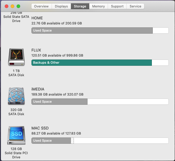

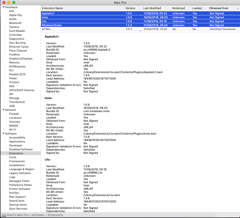

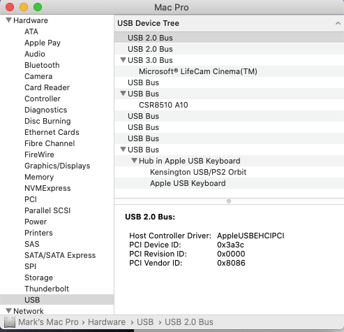

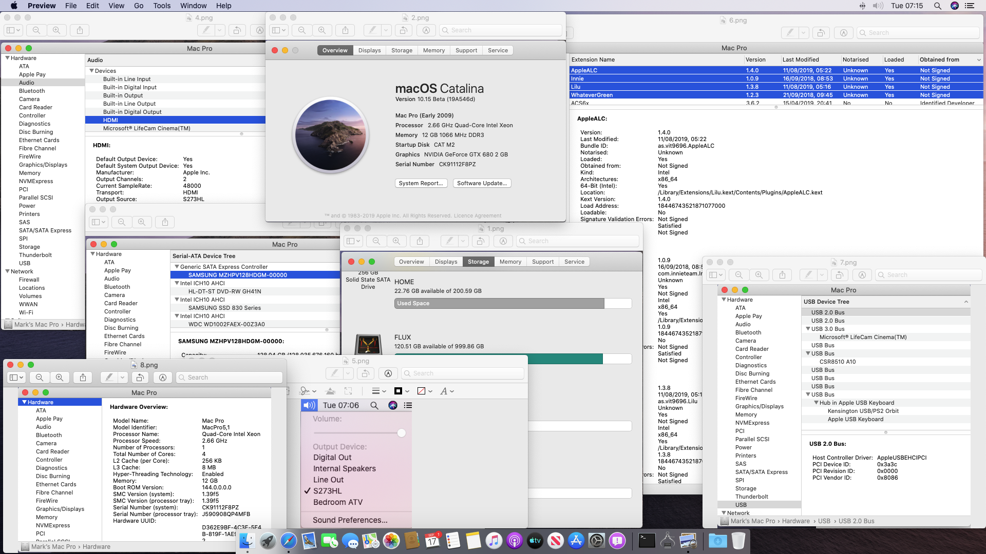

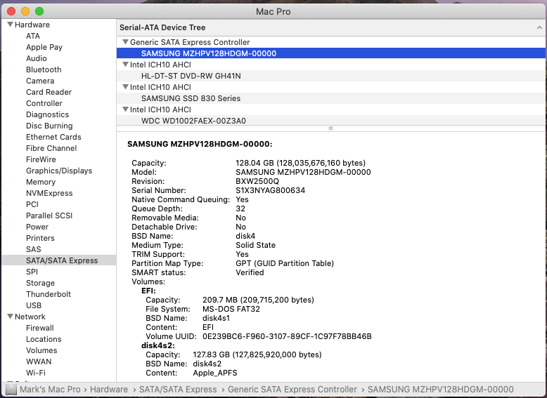

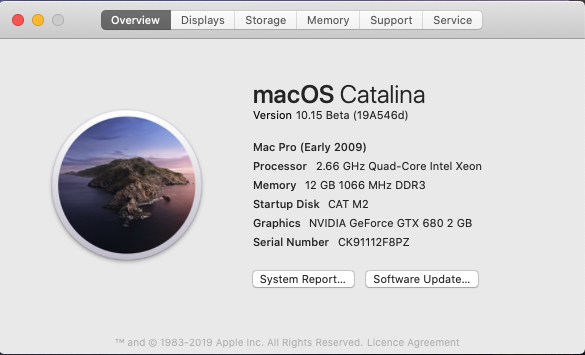

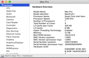

successs, I've done a vanilla install with no patches applied
booted to the desktop no problems. no WIFI as yet but hey ho
and now have HDMI sound and my PCI M.2 is now seen as internal.
sound and usb all working as normal, looks like some machines don't need patching
and using hackintosh kexts works. it works both ways
UPDATE now with WIFI
-No_Compat_Check auto added by the patcher

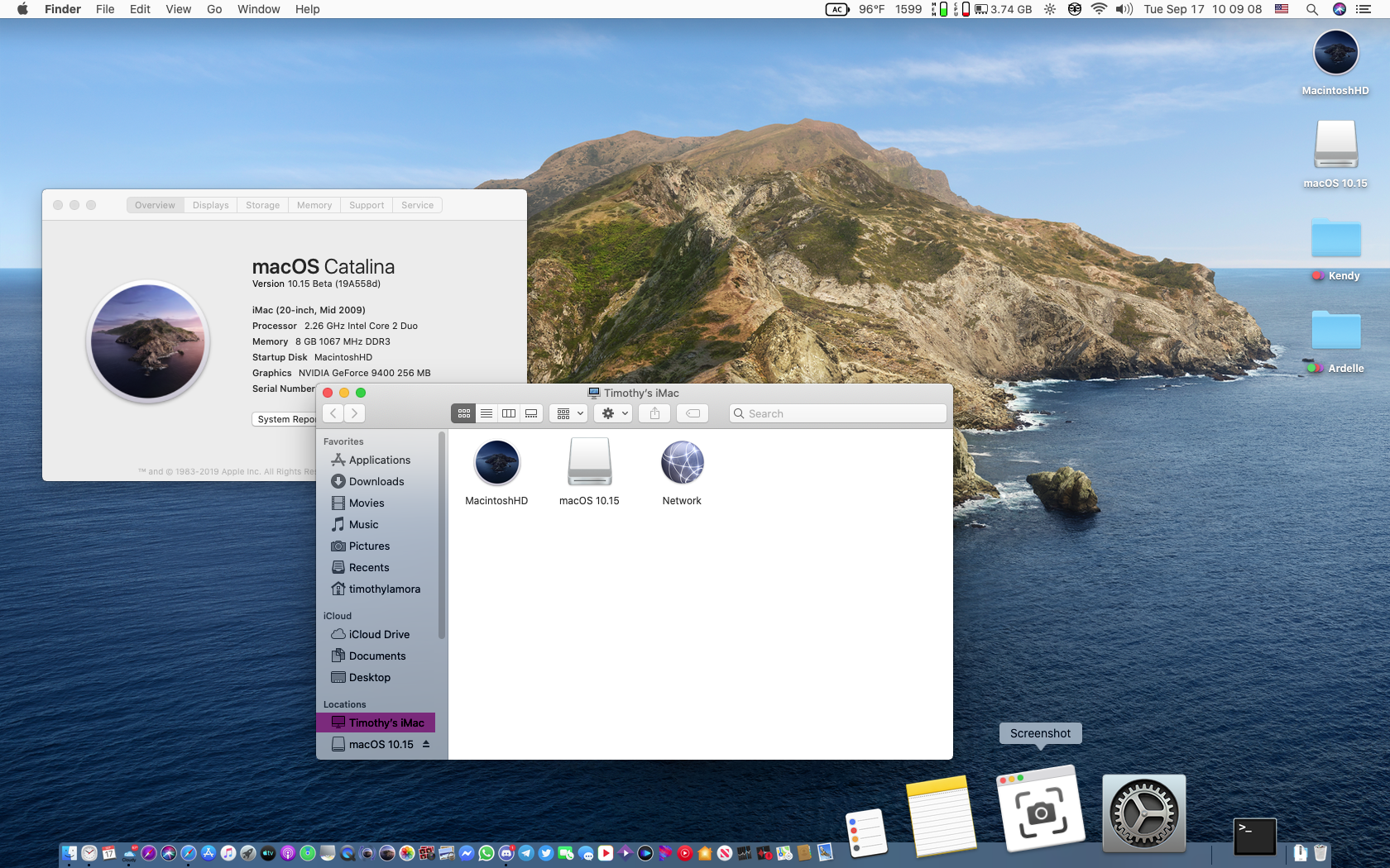

I can confirm it does work no conflicts
