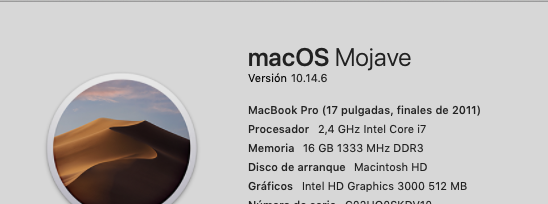

just upgrade your iMac's GPU.
just a little while back an bootscreen EFI mod is also released, and works great ;)
I've so far upgraded two iMac's and applied the EFI mod to hem, and Mojave/Catalina works fine now..
Check out this thread :
I still hope one day, HD3000 kexts are put back into the Mojave/Catalina patchers to get sleep mode working again, and I think also Airplay mirroring require them for these 2011 iMac's..
Also by default disabling legacy graphics patch on the Mojave patcher from dosdude1, like it is now with Catalina patcher would be great if made possible ! :)
My mac works perfect.

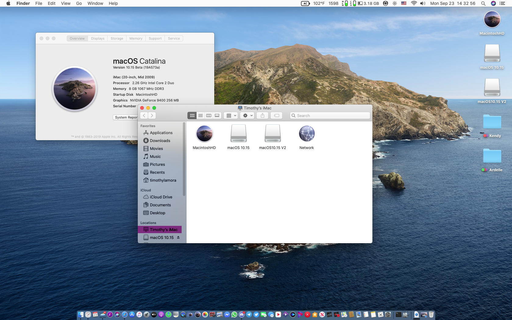

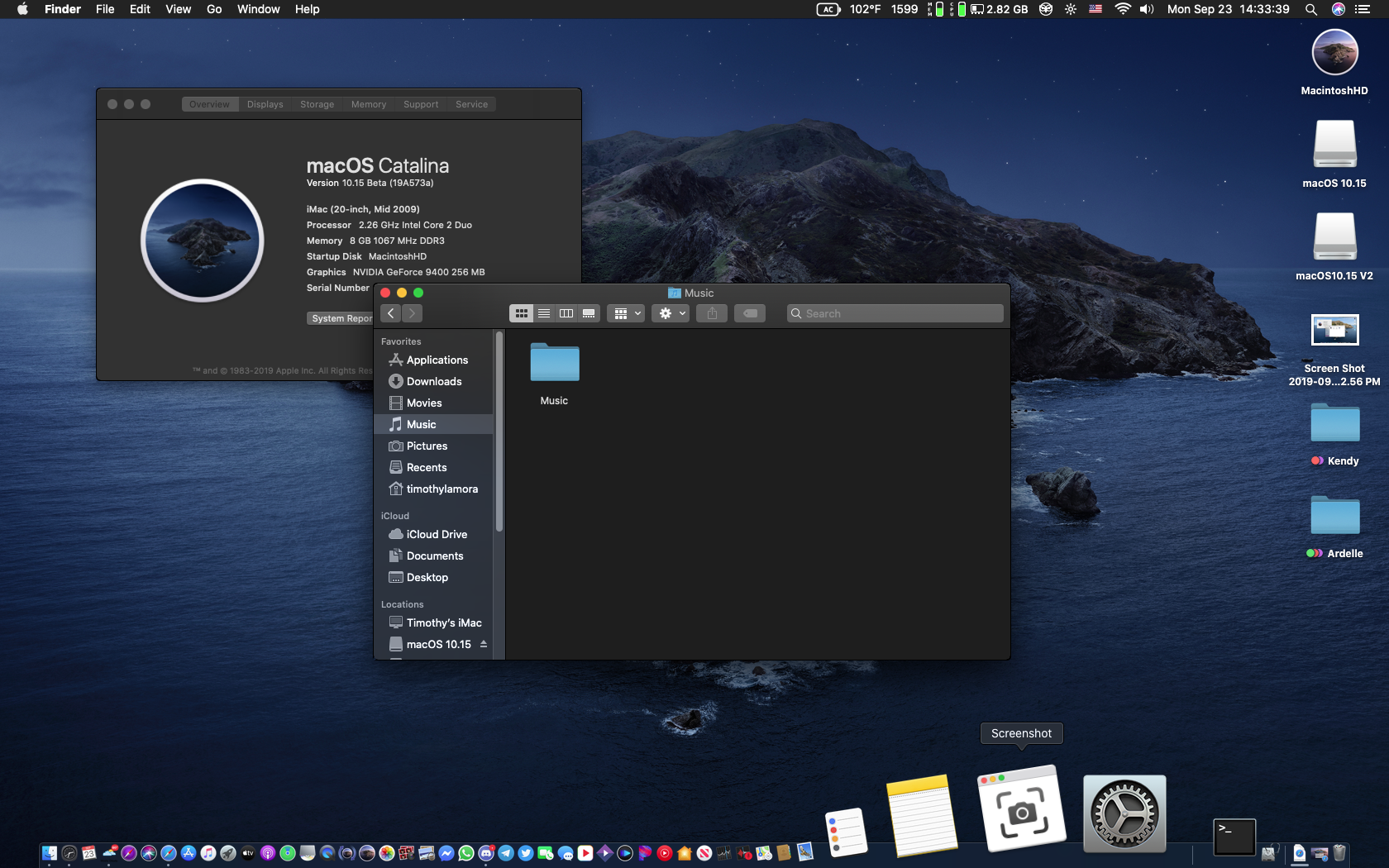

[automerge]1569275170[/automerge]
Did successfully install Cat Dev beta 9 using an older cat patcher using the install to this machine method and applying the post install patches BlueSky also working :)
