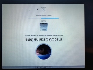

My MacBook Air 2011 stopped at installation screen on about an hour’s! I am using 1.1.5 and bp9. Any problem for me?
Finally It is using about 3.5 hours for complete the installation!

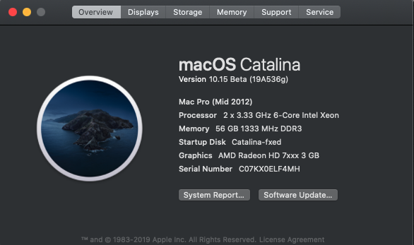

Here is my unsupported MAC running Catalina

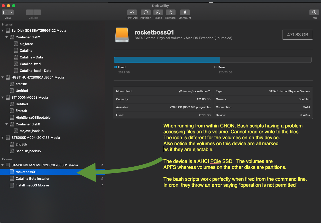

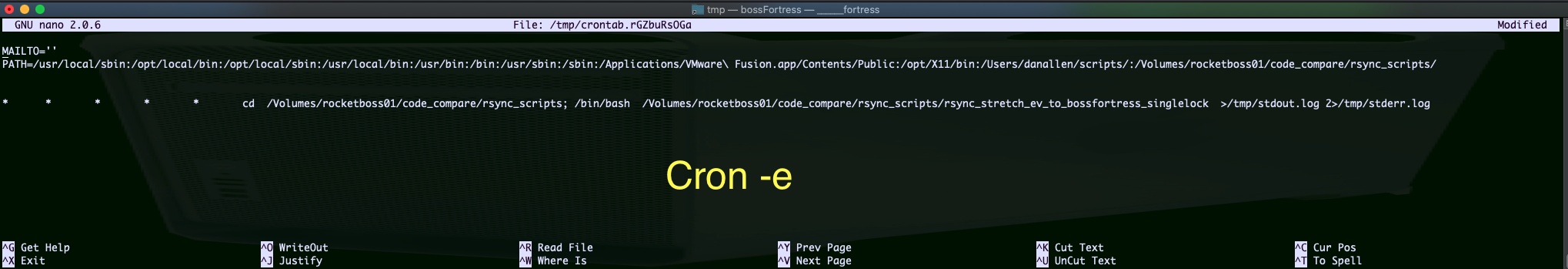

I spent the last two hours smashing my head with a brick. I'm trying to get some Bash Scripts to run from cron. It looks like the problem is the Scripts running in cron don't want to access AHCI SSD files for read or write. Any ideas on cause or fix?
This picture shows the volume I cannot access with bash scripts running out of cron.

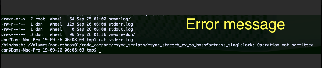

This is cron, with the error thrown to /.tmp/stderr.log
ERROR:
Here, the file called by cron gets the "Operation not permitted" error:
Moved the script to a different type volume,. a partition on another device instead of APFS volume on a SSD which the system sees as a removable drive. The script still references files on the SSD. The file will start running out of cron, but it dies when the script tries accessessing a file on the SSD.
So now the script starts running, but dies when it has to access a file on the SSD. Problem appears only in cron
So, it seems as if the scripts will not run out of cron.

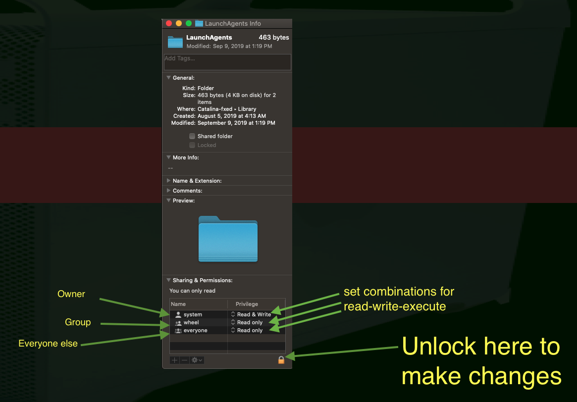

You can set these same permissions using finder by get info

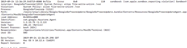

Hi I’m new to this forum but I’m having issues copying some files to the systems files as in previous posts aka Skylight patches. I’ve extracted the files from the zip but I can’t work out how to copy them over to the associated folders. Anyone got any help?
. As you do this stuff, it is important to know it is possible make your system unbootable with small mistake. Specifically, if you put a file into /Library/LaunchAgents that is writable by any account except the root account, the system will not boot with the volume containing that condition.
So, applying the long post to the thing to watch out for... here is the listing from that /Library/LaunchAgents directory on my computer. If any of these files have write permissions for any owner except root, the computer will not boot with the partition containing that directory.
-r-------- 1 root wheel 4 Oct 30 2016 com.adobe.AAM.Updater-1.0.plist
-rw-r--r--@ 1 root wheel 799 May 9 20:03 com.google.keystone.agent.plist
-rw-r--r--@ 1 root wheel 907 May 9 20:03 com.google.keystone.xpcservice.plist
-rw-r--r-- 1 root wheel 352 Sep 10 21:06 com.microsoft.update.agent.plist
lrwxr-xr-x 1 root wheel 104 Mar 16 2017 com.oracle.java.Java-Updater.plist@ -> /Library/Internet Plug-Ins/JavaAppletPlugin.plugin/Contents/Resources/com.oracle.java.Java-Updater.plist
-rw-r--r-- 1 root wheel 715 Oct 26 2016 org.macosforge.xquartz.startx.plist
