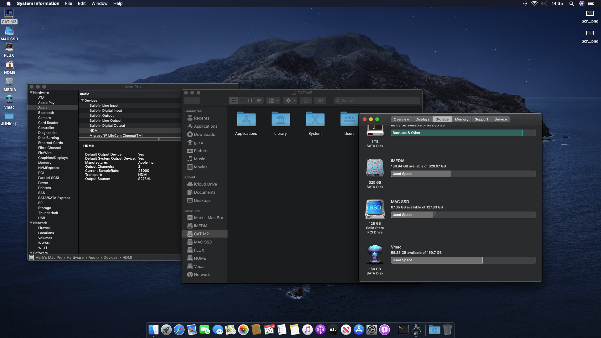

UPDATE: added lilu, innie, appleALC and whatevergreen
Now have my pci m.2 as internal also now have HDMI sound

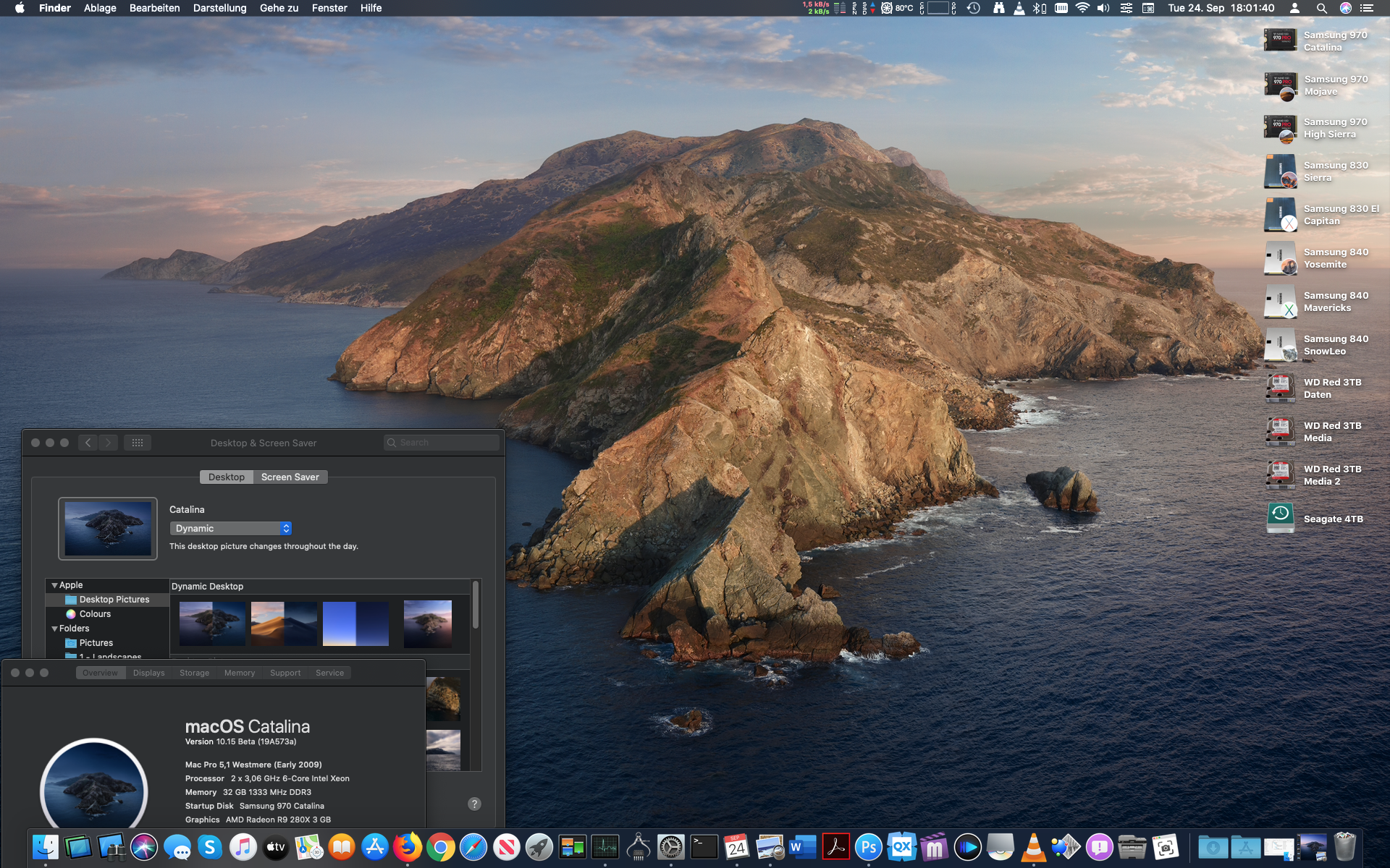

Not sure about this but it could cause trouble down the line. My preference is to have as few patches as possible so using dosdude installer but with no patching. However any comments why Catalina Dynamic Wallpaper looks like this? Other Dynamic and static wallpapers are fine. This has only happened with B9. Presently using GTX680 2GB. installed twice now with same effect. May try a new download and rebuild usb.

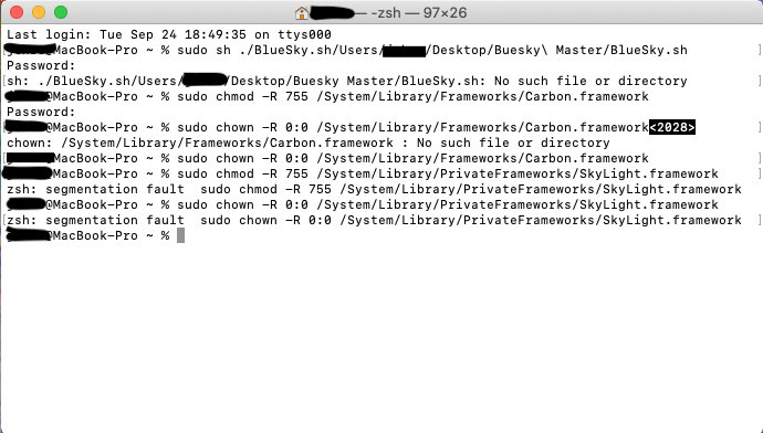

So i try the manual Install..did found the two folders and replace the files..everything went well with the HiToolbox commands..but problem with the 2 commands of SkyLight (See the picture..)
So i tried to reboot but the Macbook fail at the end of the process and remains stuck on the startup window..
