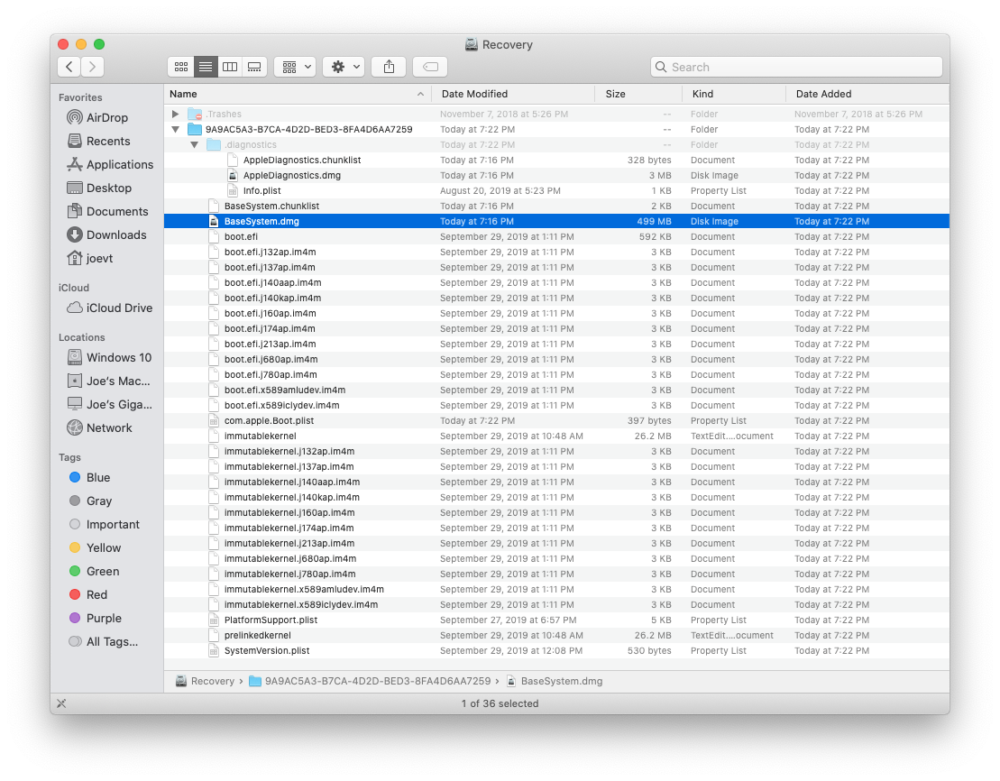

I created an unpatched installer and installed Catalina over the previous installation (not a clean install). This fixed the Recovery partition.
I use Disk Arbitrator.app to mount Recovery partition to examine the contents.

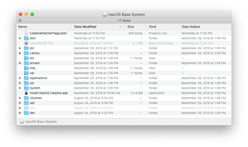

Before, with the patched installer, the the contents of the Recovery partition and it's BaseSystem.dmg file look like this (you can see a patcher file in macOS Base System):

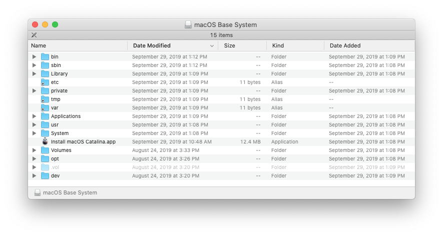

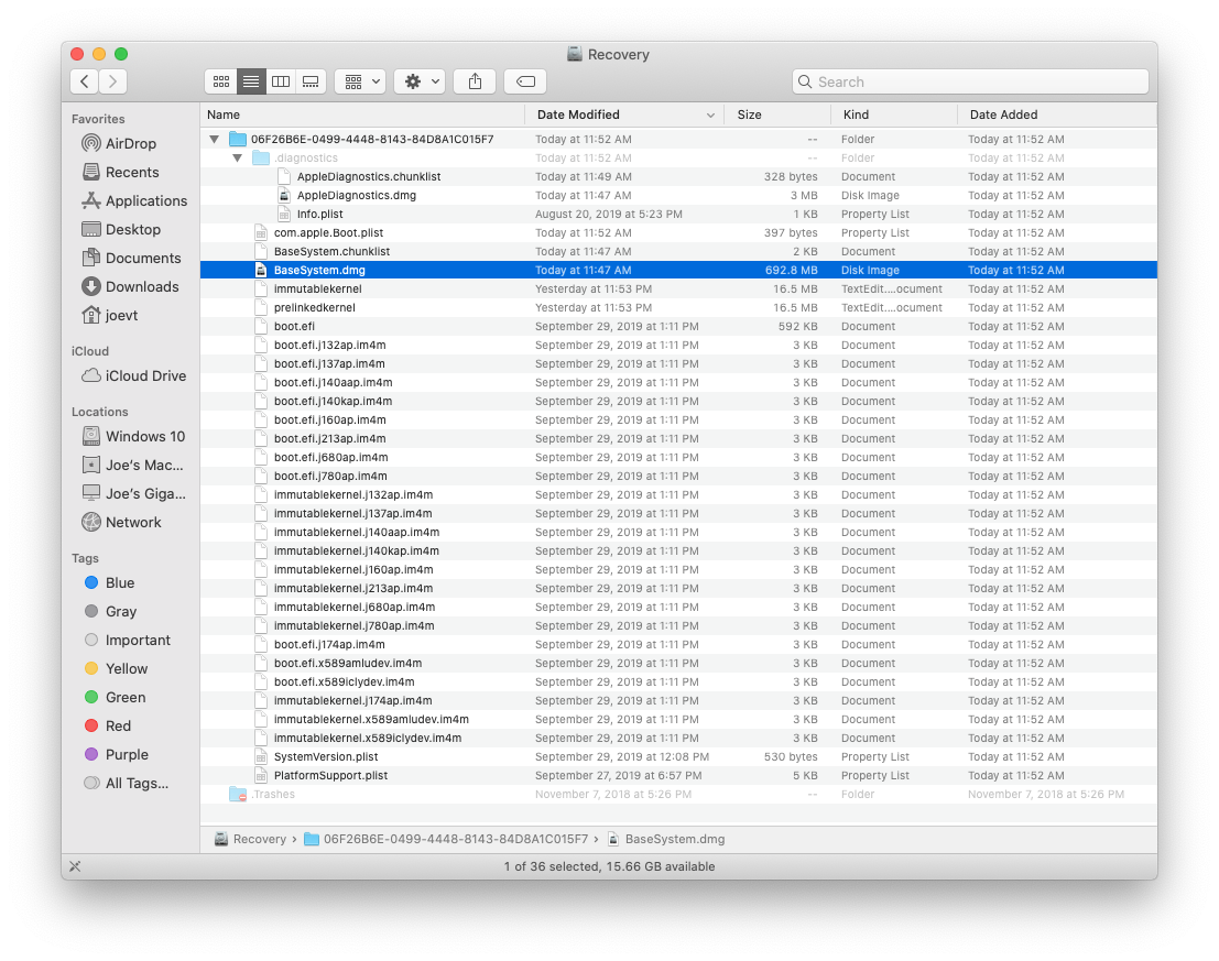

After reinstalling (not a clean install) using the unpatched installer, they look like this (no more patcher file or other changes):

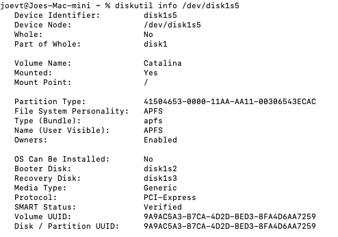

I noticed the UUID in the Recovery partition changed. This matches the UUID of my Catalina partition:
I don't think the reinstall would change the UUID, so maybe the UUID in the patched Recovery partition was wrong? I didn't check the Catalina UUID until after the Recovery partition was fixed. I don't know where that old UUID came from.
Anyway, this is a lesson to check the UUIDs if problems occur (in the root folders of the Preboot and Recovery partitions and in the volume info of the partitions). The "Booter Disk" and "Recovery Disk" should also be correct.
Code:
diskutil info -all
