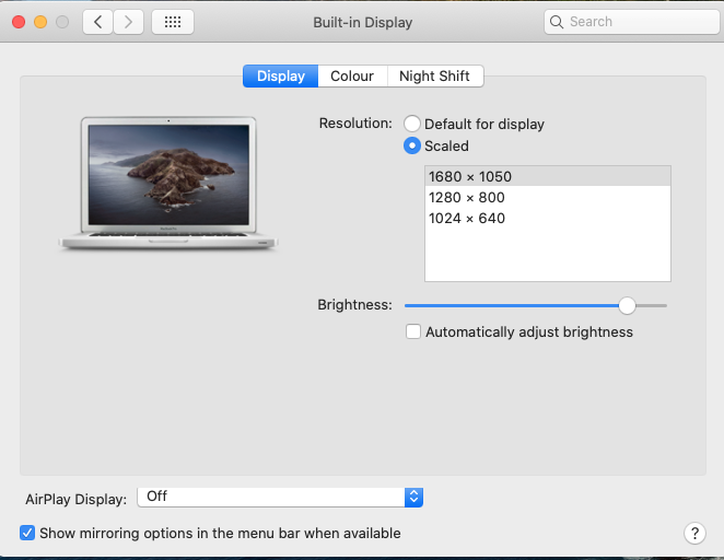

I have some issues though, with my 5,2 (5.2) white MacBook. I can't just the screen brightness. No patcher update solves this like it did before when the Mac was running on High Sierra. Any Idea where I might come from ?

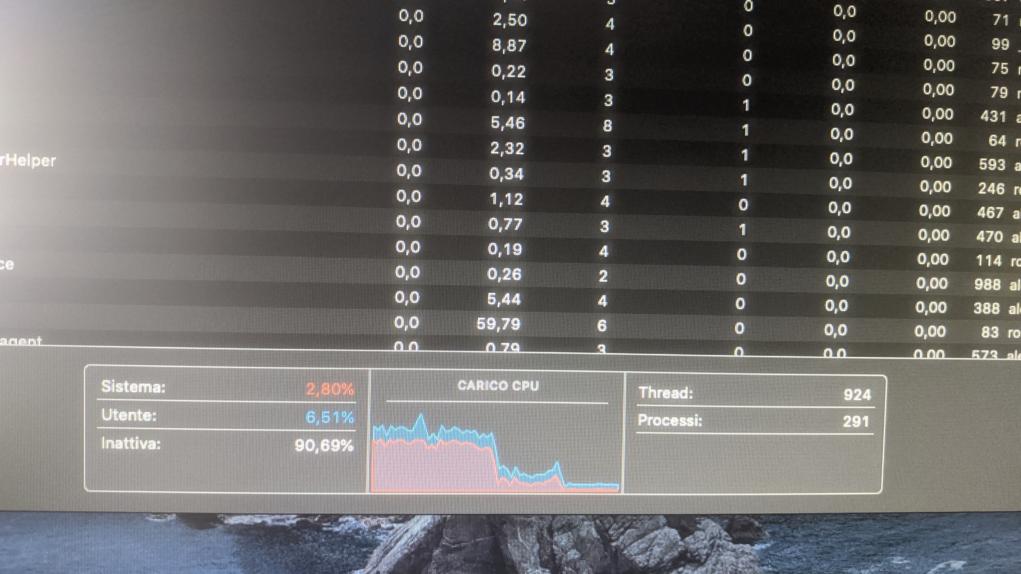

Anyone has the CPU at 40% IDLE like me with Macmini 2010, with other old macs?
Do you think that an external SSD via USB 2.0 or an internal SSD could improve the performance?
I suppose that the low performance is dued to the new file system, because with @dosdude1 patched Mojave on the same hardware, the system is perfecty usable also using Plex server and other heavy apps and services.
Mac OS is doing some photo collecting stuff for a day or 2 depending on the photo library size. I suggest keeping it running for some time :)

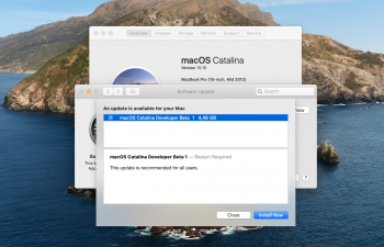

Well as far as I can tell there are no ill effects so far using the Catalina Patcher USB on a supported machine. There was no Patch Updater installed, NightShift is original by Apple, and the MBP gets point updates via Software Update like any other supported Mac, i.e. 10.15.1 DP1.

Interesting, thanks for sharing.
Well as far as I can tell so far there are no ill effects using the Catalina Patcher USB on a supported machine. There was no Patch Updater installed, NightShift is original by Apple, and the MBP gets point updates via Software Update like any other supported machine, i.e. 10.15.1 DP1.
it is because your machine is officially support 10.15
