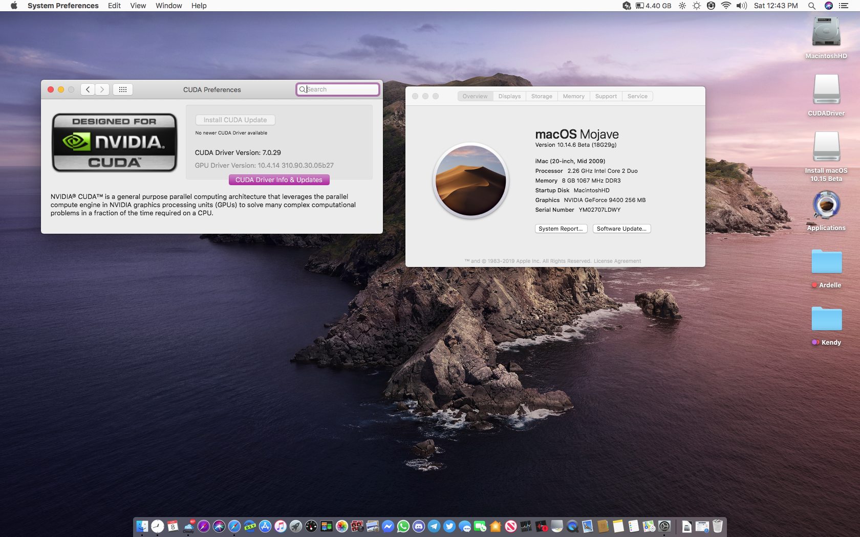

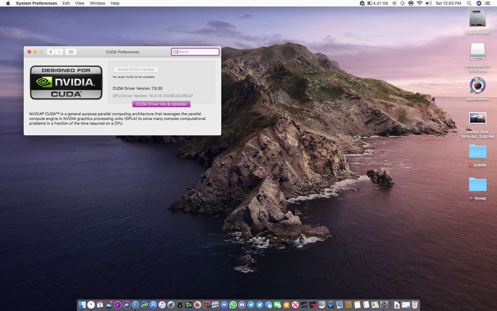

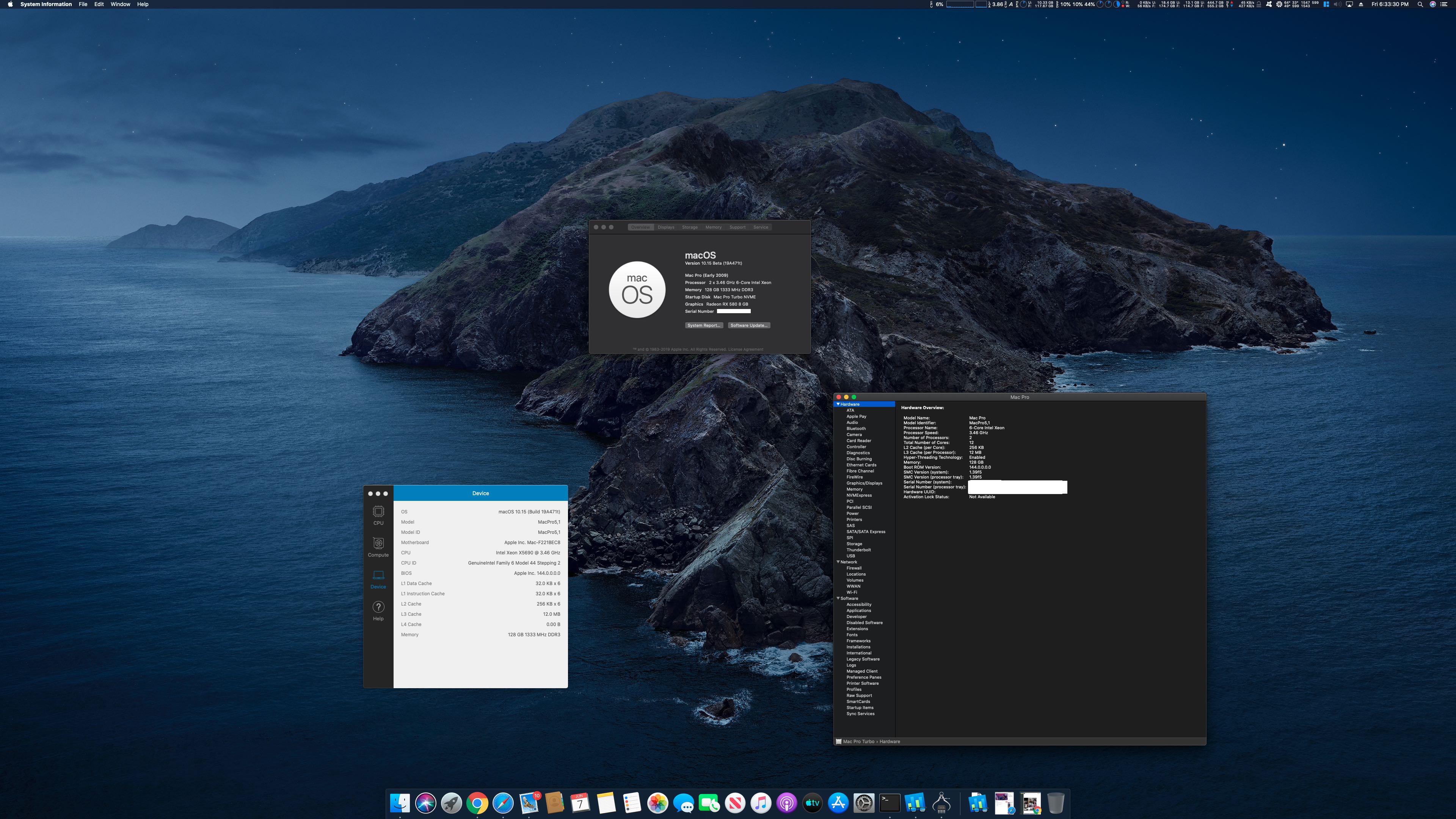

Cuda driver 7.5.30 working hope this is helpful info 🙂
