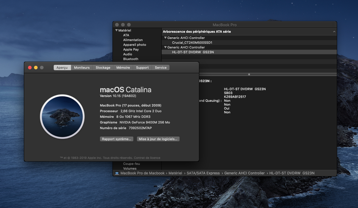

After to be alone with impossibility to play bought movies on my Mac Pro 2009 and Catalina using le RX580 PC Card, am I alone to have black screen when trying to play DVD on my MacBookPro 2009 using DVD player ?
