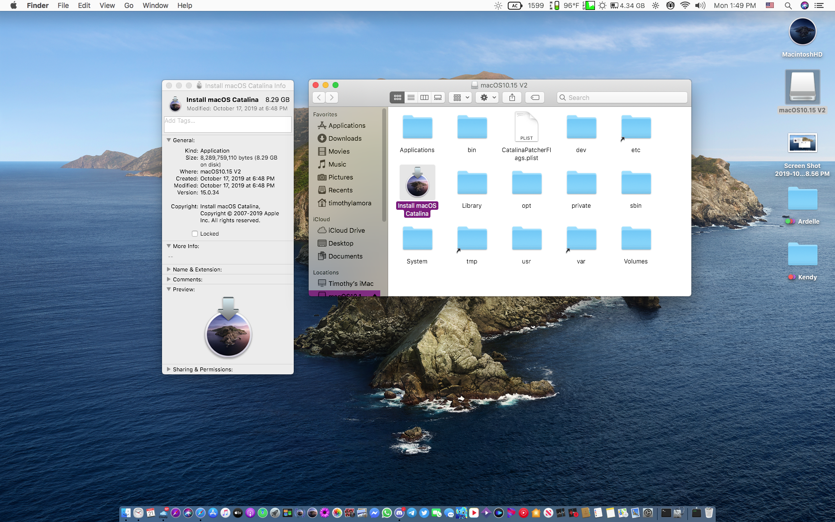

Just did a successful install using CP 1.1.9 15.0.34 on MacBook 6,1. Booted into my High Sierra partition, used CP 1.1.9, downloaded 15.0.34 and created USB installer, reinstalled over current 15.0.33. Reinstalled the HiToolbox and SkyLight Original using method from previous page. Posting this post install 19A603.

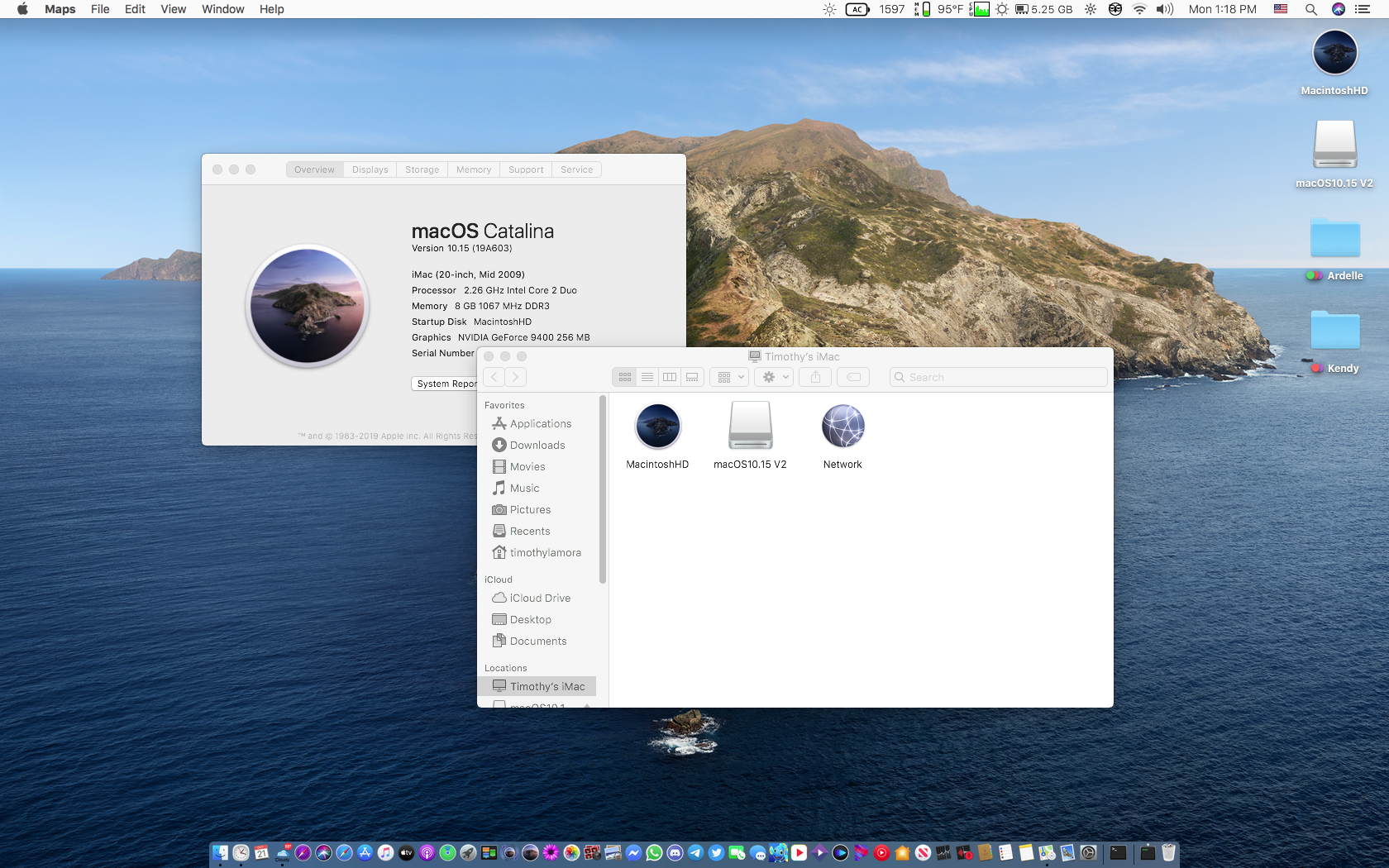

Successfully installed 10.15.0 19A603 using the install to this machine method BlyeSky 1.4.4 also working :)
