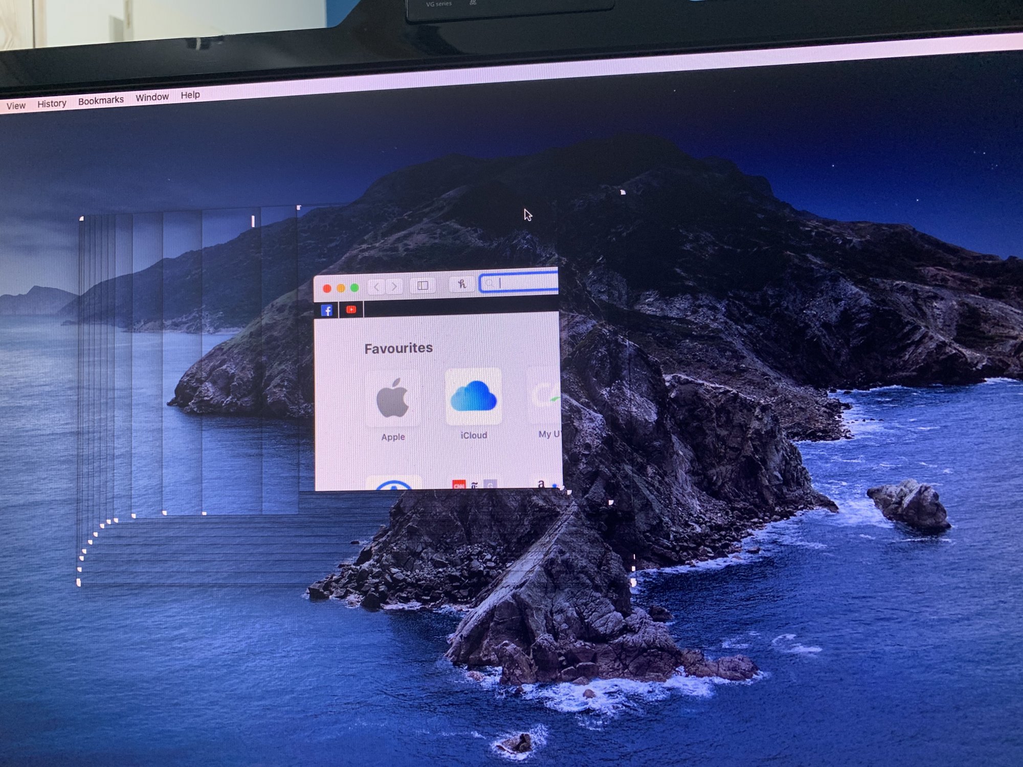

Hey there, I been having some problems running Catalina on my Mac Pro 3.1. I upgraded my Mojave build and found that my GTX 780Ti will no longer output to a display where as the original GT120 still works fine. I also tried using a Mac edition GTX 680 which will work but with no GPU acceleration, so many visual artefacts and choppy animations (see image). With a fresh installation all three GPU’s work fine but only at 1080p, nothing will display if plug the 680 or the 780Ti into a 4K monitor. Does anyone know how to fix my original build and if it's possible to run a 4K resolution on a 3.1 Mac with Catalina?View attachment 878490
If you installed patched Catalina on your MacPro 3,1 with a non-Metal graphics card installed (ie not your GTX680), the legacy video patches would have been applied. These will break Metal acceleration. Just remove all the graphic cards other than the GTX680 and do an re-installation over your current system volume. That will purge out the legacy video patches.

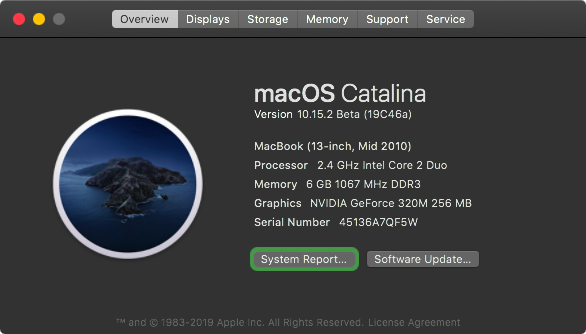

Hi all! Just checking in to confirm that 10.15.2 DP3 (19C46a) is working seemingly normally on a non-Metal MacBook7,1 with the new GeForceTesla patch and a stock IOSurface. I'll report back if anything weird happens, but fingers crossed that the next couple betas will continue to be smooth sailing :)
Thanks dude :), My old installation works fine now at 1080p. I've done some further testing and found it will run @4k 30 on my TV, when using the HDMI 1.4 port. My though was that the DisplayPort might not be working under Catalina but when I use a DisplayPort to DVI cable on the 1080p monitor it works fine, so that can't be the issue.

Hello. I just bought my wife a A1278 MacBook Pro 2011 i7 and used the Dosdude1 patcher to install Catalina. Im facing weird performance, and when im updating the Legacy Video Card patch, the computer frozes and reboots to tell me she had an error. It has an Intel 3000 graphics card and i think theres an issue with this GPUs.
The Dosdude1 page dosent mention problems for this particular sistem. Im running it on an 850 SM SSD and 8Gb Ram.
can anyone help!?
Thanks
Hi Yamil did you find any solution for this? I have the exact same 2011 13" MacbookPro8,1 but I am now afraid to upgrade because it sounds like you are having problems.
Reactions: TimothyR734
