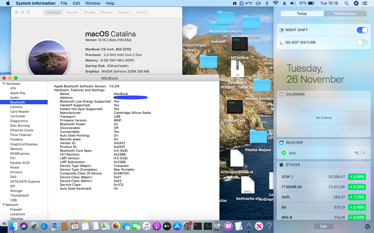

As you can notice I already tested on my machine this attached, moreover I used a CambrigeSiliconRadio not Broadcom (apple favourite vendor) usb BT 4.0 dongle that is not advisable to use for compatibility but instead it worked without issues.
  • Catalina 19B88 patched BT4 usb dongle IOBluetoothFamily.zip

The fact that when you plug the usb BT 4.0 dongle the blue-light is solid is not normal, AFAIK any external bluetooth dongle when plugged is continuously blinking so maybe yours is defective.
About the fact that is not detected as primary bluetooth device (with its MAC address) you can try to plug it before the machine power-on. Anyway no need to write the MAC, from system report just check
Bluetooth Core Spec and LMP version: 4.0
and of course this: Bluetooth Low Energy Supported: Yes

As for speed, the iMac BCM9460CD is a 1300 Mbps card and with BT 4.0 that supports Handoff and Airdrop without patches.
Glad it worked, but to clarify when the USB BT 4.0 is used as primary dongle the internal BT 2.1 one is temporary disabled, unplugging it will start to work again, I write this because with a patched IOBluetoothFamily can't be used two concurrent BT 2.1 / 4.0 devices, I mean if your an external BT device is paired with the BT 2.1 , you have to re-pair it with the BT 4.0 usb device.
Here is another apple document about Sketch and Markup that are Sidecar Continuity features:
https://www.apple.com/macos/catalina/docs/Sidecar_Tech_Brief_Oct_2019.pdf
Yeah I did have to pair everything again. Which was fine. Booted up this morning, and it was back to using internal BT even though I leave the BT dongle in permanently. But this time I couldn't get it to switch back to the dongle using the method I used last night.
I followed instructions from here and ran sudo nvram bluetoothHostControllerSwitchBehavior=always then rebooted. That got it working again, but I still had to unplug a couple of times. I'm thinking maybe you were right about this dongle being defective.
I also installed Additional Tools for Xcode 11. It includes Bluetooth Explorer which allows me to switch without rebooting (although changes are not retained after rebooting). That was also in that post I linked above although then it was called Hardware IO Tools for Xcode.
If after all of this, it continues to happen, I'll replace the dongle and what happens... or install an internal combo card, if possible. Can you install an internal wireless-AC / BT combo card into a late 2011 17" MacBook Pro? MacBookPro(8,3)
