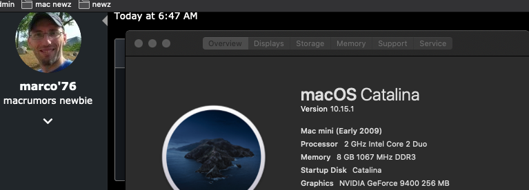

I just went through the process as per the video for dosdude1's Patcher. All went well on my cMP5,1 until the newly booted Recovery utility complained that the Catalina installer on the USB drive was damaged. I'd downloaded a fresh copy of the Apple installer, all had run well and then <pop!>. This is the 284th page of this thread, can anyone suggest the appropriate post to read for diagnostics?
