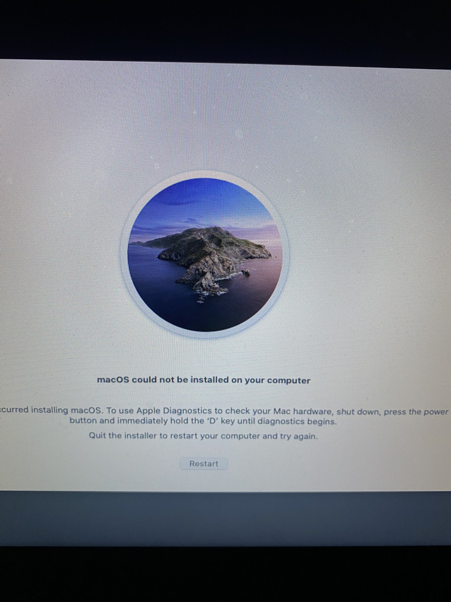

I’m receiving this error and the Sip is offView attachment 884918
The pic you posted is such poor quality I doubt anyone can read it.
I sure can’t.

Thank you just fixed the picThe pic you posted is such poor quality I doubt anyone can read it.
I sure can’t.

Any idea on what I could do to solve the problem?
If I had to guess, it's something related to the dual GPU related kext replacements, rather than the wrapped frameworks. I don't know a lot about those systems though since I have a single-GPU machine. @jackluke might!Please put that in a codeblock. To answer the question, it might be something to do with the acceleration wrappers.
keepsyms=1 boot argument, the backtrace will be much more informative.I found a good NEW kext installer tool specifically for Catalina:
What should I do to make the installation correctly finish the process?
