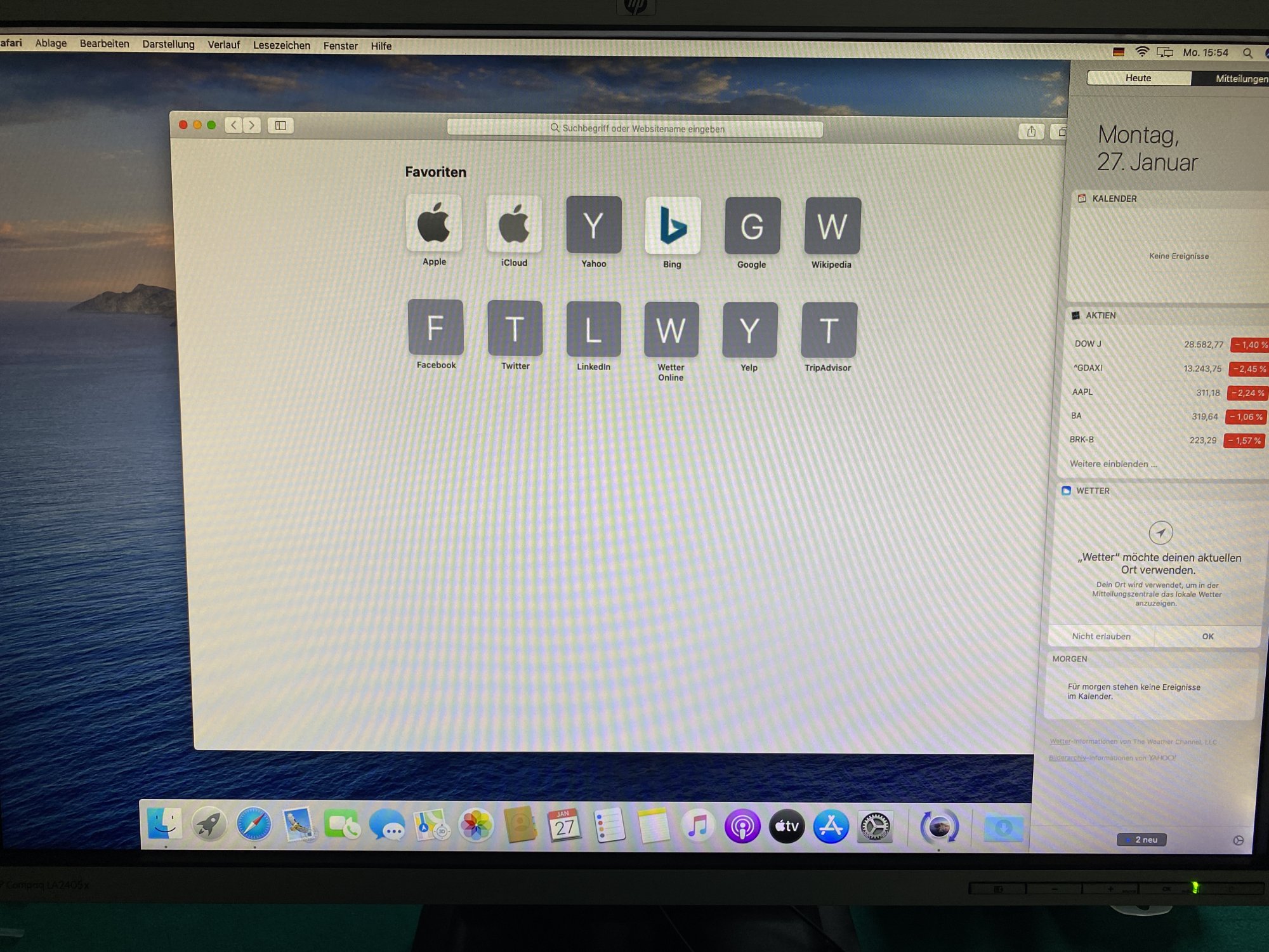

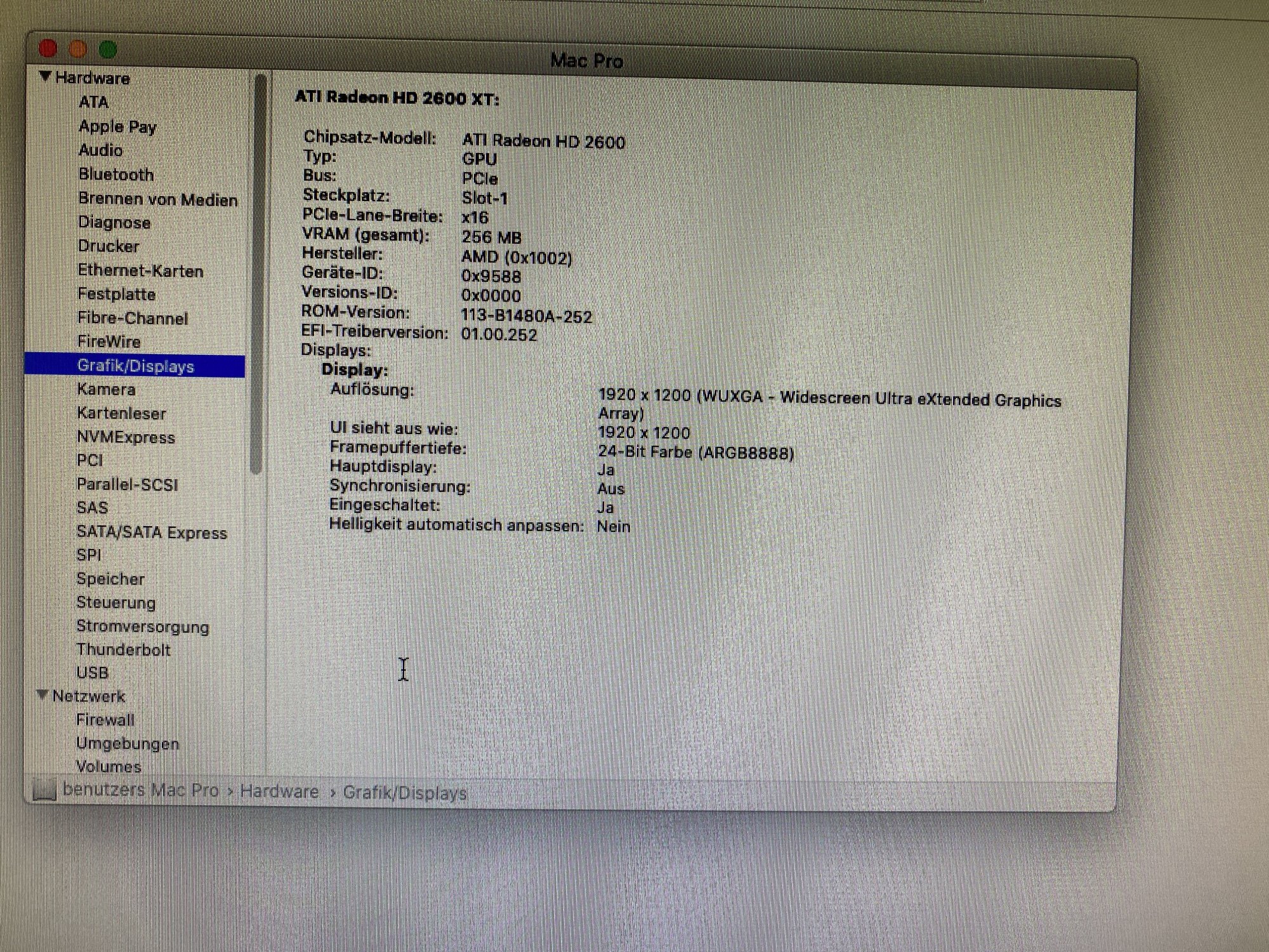

Looks like that.
laggy system without transparency
2600XT
Reactions: TimothyR734
