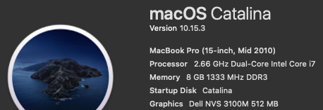

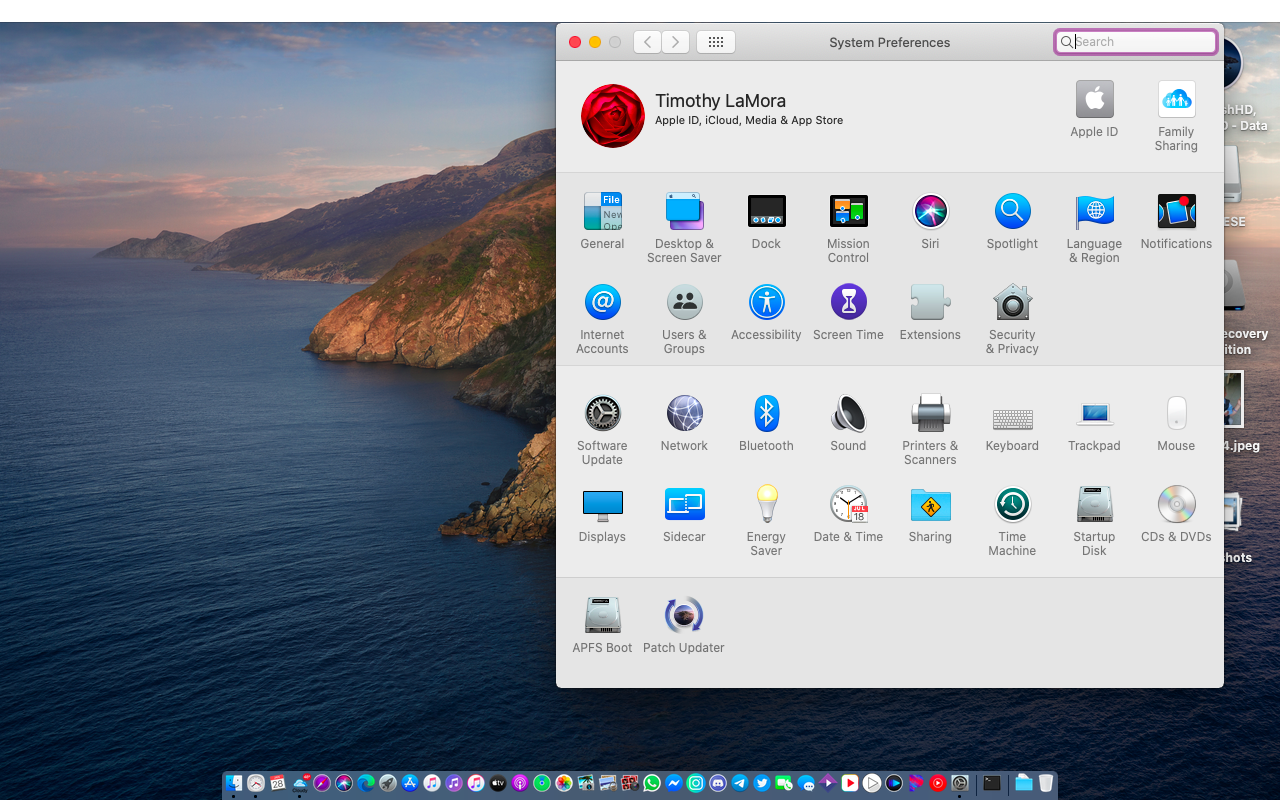

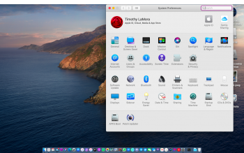

After updating to 10.15.3 i need to redo these patches? or the trackpad patch would be in the new patcher @dosdude1 ?
I got a trackpad update from the patch updater right before I downloaded 10.15.3 final after I installed and did the post install patches the trackpad is still working :)
