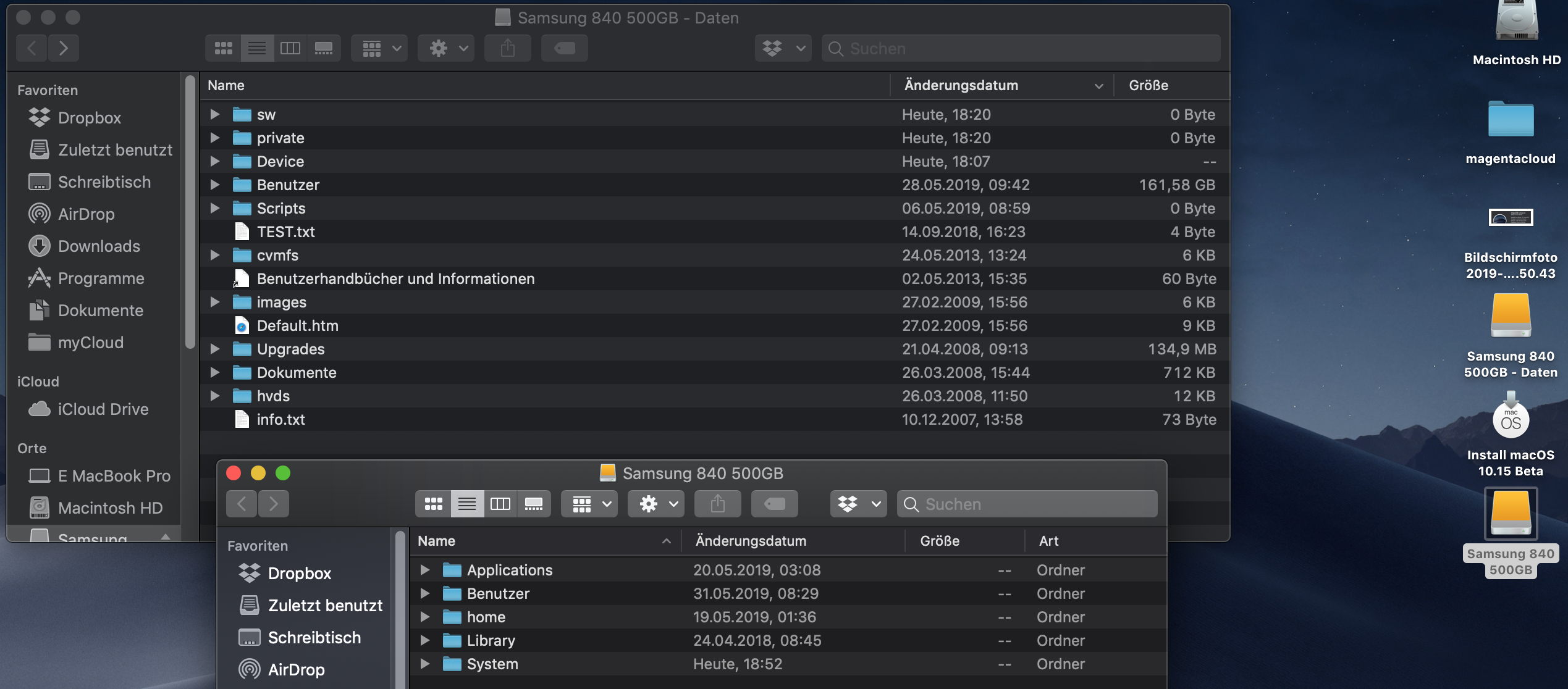

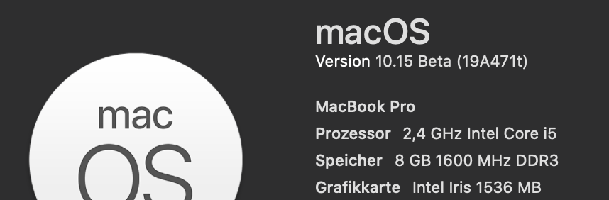

Happily could use a supported machine (MBP11,1) to install Catalina 10.15 beta on an external SSD with APFS (USB).
This disk was prepared on my MBP5,2 by cloning (CCC) the nice and stable 10.14.5, including all user data/programs.
Then connected the disk to the MBP11,1. Ran the Catalina installer app obtained via dosdude's post #31. Takes a while (1hr) on the USB disk, but that takes care of all data on the disk.
Boots fine on the MBP11,1 and all my settings and data are in place. Used this for some hours without seeing problems.
Attached are outputs from the 10.15 running on the MBP11,1: system info, and output from diskutil apfs list and listVolumeGroups. disk3 is the Catalina one, disk1 the internal with 10.14.5.
Then booting back into 10.14.5 still on the MBP11,1, here is as screenshot of the desktop with the two separate Catalina APFS volumes opened. The System one looks familiar, /S/L/E etc are open to modification from the running 10.14.5.
For now I'll try patches this way, from my MBP5,2 with 10.14.5 and the Catalina disk on USB. A small script, and of course the necessary modified kexts etc, should allow a decently fast patch-and-try cycle. I'll start with (a subset of) the suggestions in ASentientBot's wonderful work (post #767).
The "problem" is now that I saw the running Catalina on a supported machine. Want to see it also on my MBP5,2, even with non or partly accelerated graphics...
Good to know that nothing was hurt on the MBP11,1 by the installation exercise.

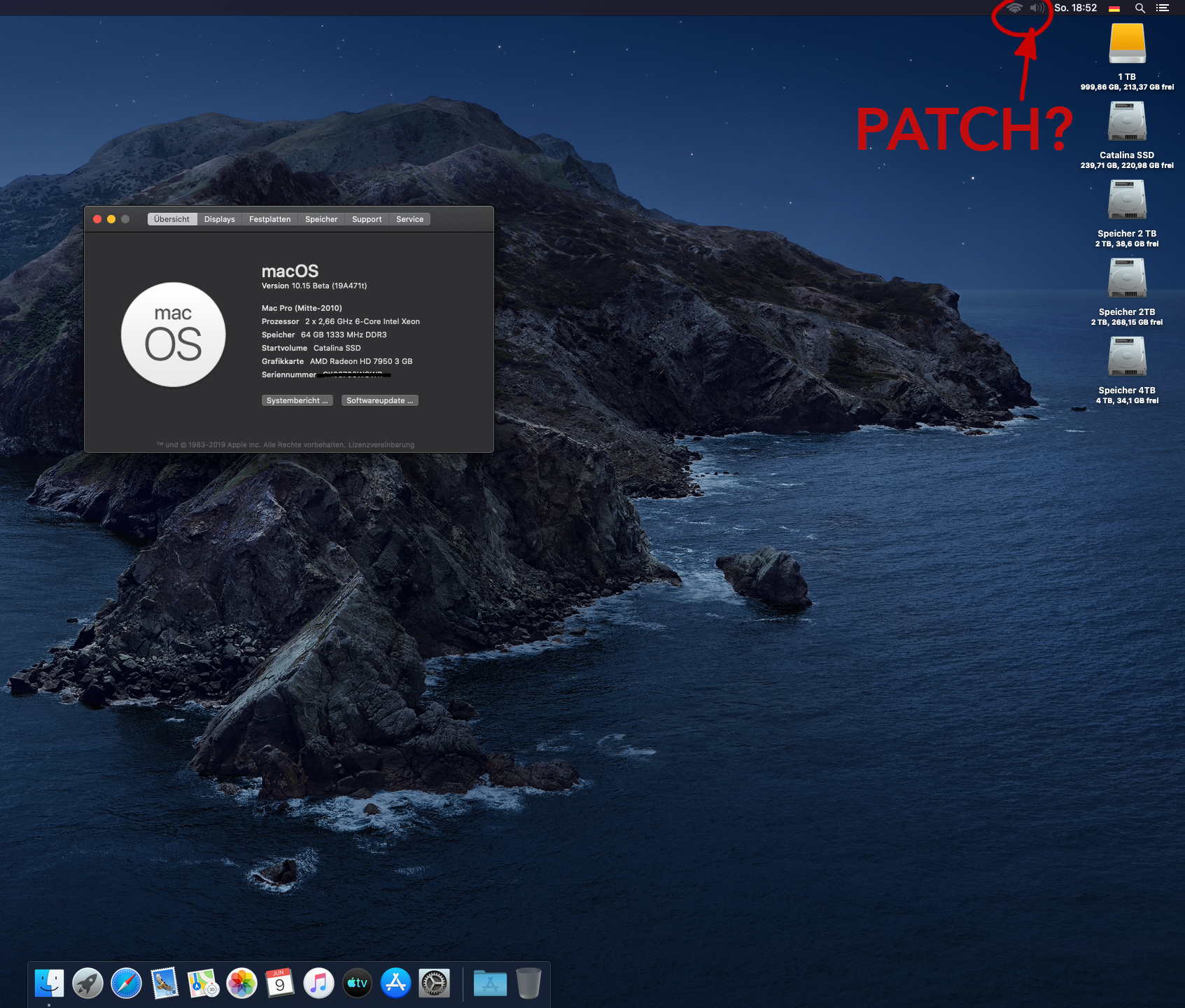

I don’t have supported Mac to do initial install of Catalina, so I spoofed my 2007 iMac to think it was a 2012. And it worked
Does anyone know how to set this in nvram as a param without having to use a Hackintosh or third party boot loader? Just curious.
