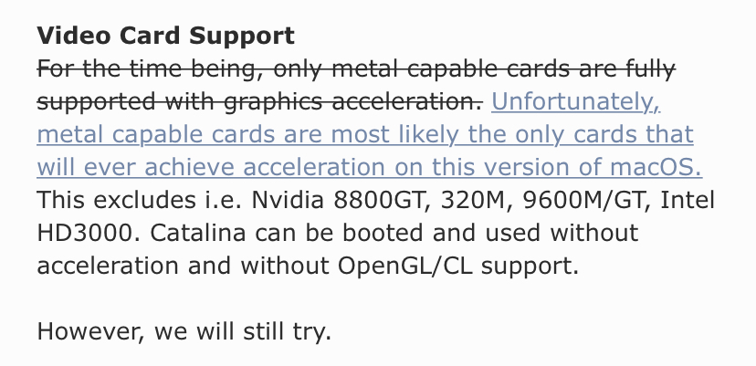

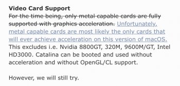

Sorry I don't understand, I have an Mac Mini 2011, with Intel Graphics 3000, this Video card is no will compatible with Catalina? This time not will have a Patch?🙁
the devs are trying to find a way, don’t worry to much 😉
[doublepost=1560301336][/doublepost]isn’t the geforce 320M supported in 10.15?

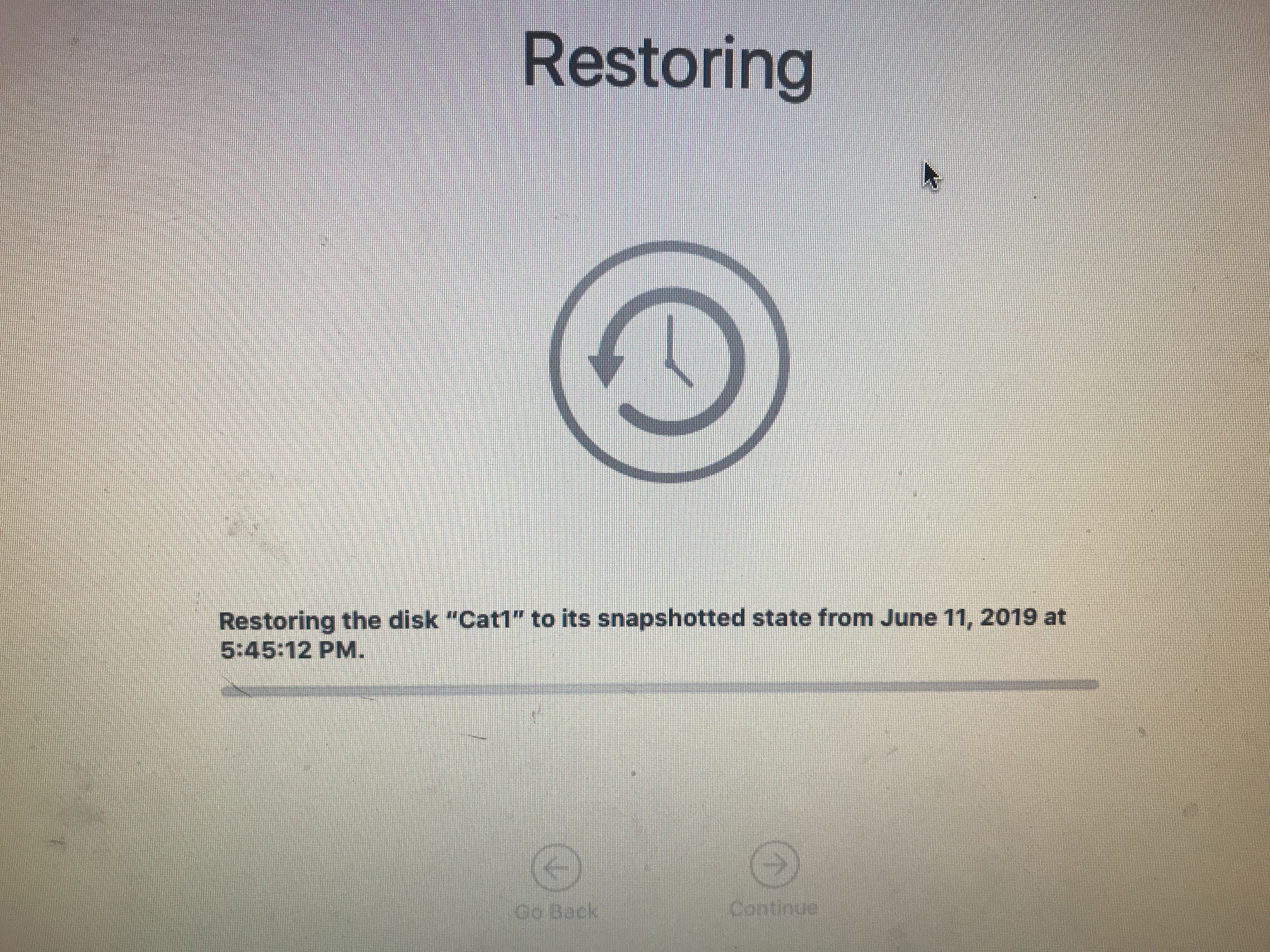

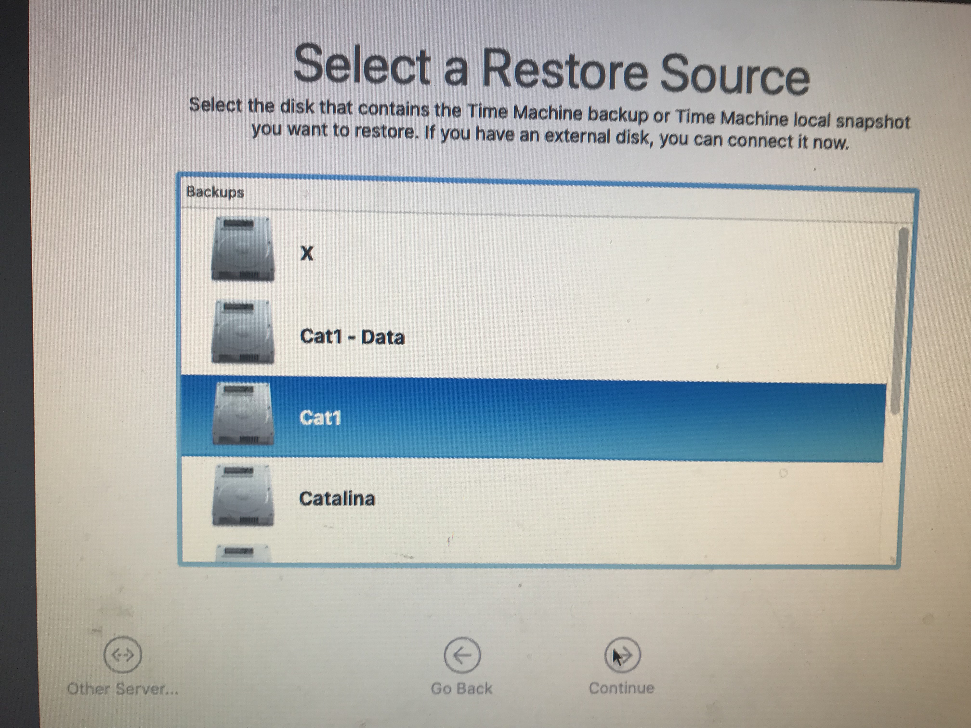

I hosed my Cat system on purpose.
Then booted my Cat USB install disk / same as restore volume.
Open Time Machine App
Select the hosed source disk
Then picked my latest snapshot.
Local Snapshots made using tmutil
I am thinking my first front end for clonetool will utilize tmutil as you can do anything you want to the system and you can restore it from a snapshot without taking up more disk space.
Data can also be sent to a remote servers it’s ways of managing time machine on a more automated and managed level. More granular and less like a giant tape drive which is how TM usually works. You can even access the local snapshots via time machine in Cat.
I have other tools that can make clones of home data same premise and we can add in other imaging tools if needed.
Looking to really close a gap in backups that take up zero disk space, and take advantage how APFS works.

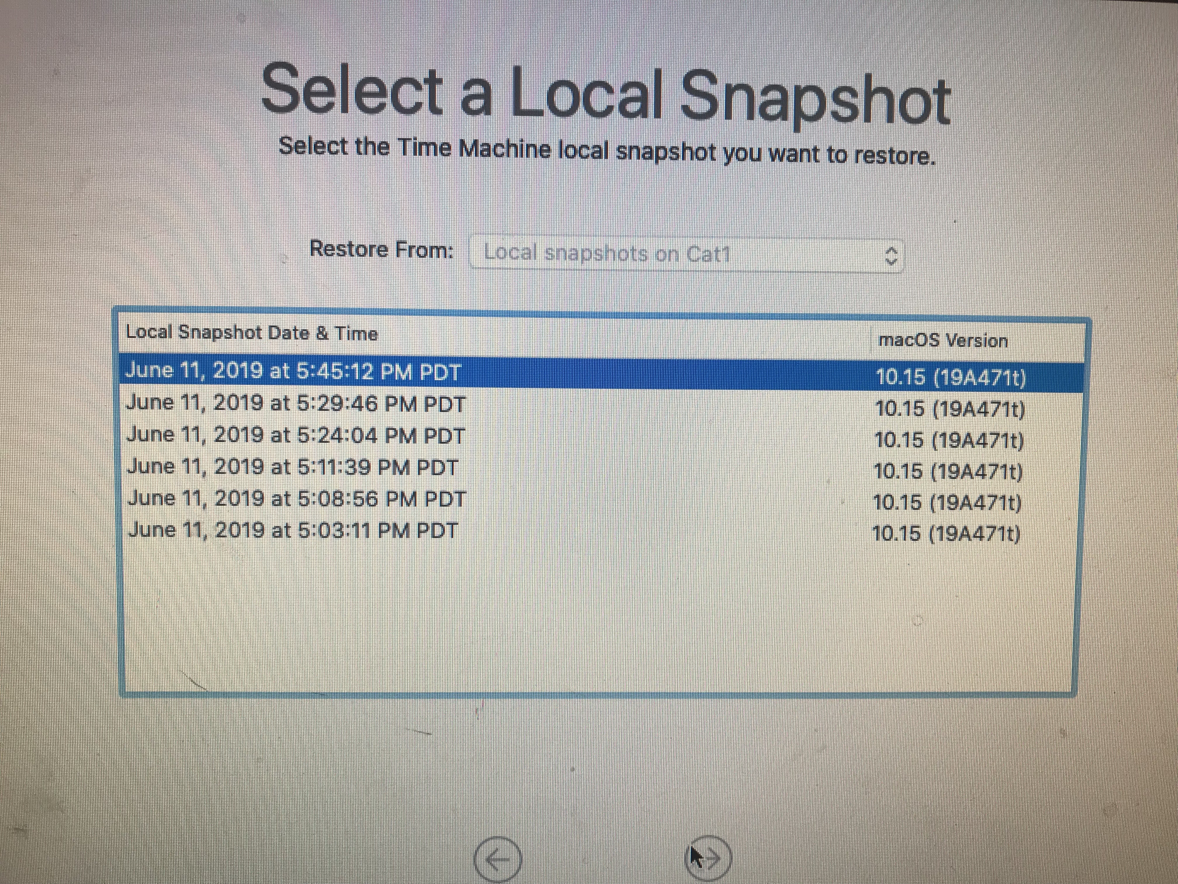

I am going through it now manually installing one kext set at a time, taking snapshots and rebooting, saving the shell scripts. Turned SIP off manually.
I love that discovered taking local snapshots. It’s been there since High Sierra and I am considering about building my own API around it. Saves time, disk space. Windows had snapshots a long time, but APFS really does a good job sharing common data. Lots of uses. I can also clone anything in the home directory, same premise with shared data. I have a few tools in mind and will probably make a menu bar app.
[doublepost=1560303689][/doublepost]incase anyone wants to create their own tmutil localsnapshot use:
-> Created local snapshot with date: 2019-06-11-183655
Make sure you run it from you live system. Thinking you might be taking risk? take a snapshot and ease your mind that you won't have to do another reinstall after a big whoopie!
It's slick.
and use a recovery disk mode or install boot disk to do a restore of the local snapshot using Time Machine App. (I may find a way to do this without rebooting, but til then this works).
Requires APFS. Awesome tool to build something on.
Select the hoses source
If you had a 2012, you'd be in good company. Even though its graphics compared to a 680 is slow.

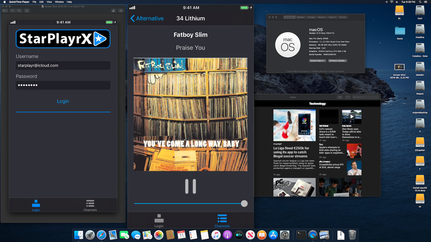

[doublepost=1560311751][/doublepost]I got everything working on the MP3,1 except for Sound. I installed the Audio Kext's and no dice.\
I do have two USB sound ports and those work fine. I'll see if my electric guitar can hook up to one of them cuz other than a Mic with the USB Sound, and sometimes I use head phones, I'm good. Don't have digital audio in or out right now, but I am can live with that for the time being.
I did a bunch of local snapshots.
It looks like the system keeps the last six.
APFS snapshots are a lifesaver. Can't believe I did not come across them sooner. Again, I did not like APFS at all for a long time. Guess when something is new and you don't quite understand it and the old HFS+ was the standard for a very long time.
Code:
Mac-Pro ~ % tmutil listlocalsnapshots /
com.apple.TimeMachine.2019-06-11-194219.local
com.apple.TimeMachine.2019-06-11-194619.local
com.apple.TimeMachine.2019-06-11-194632.local
com.apple.TimeMachine.2019-06-11-195947.local
com.apple.TimeMachine.2019-06-11-201158.local
com.apple.TimeMachine.2019-06-11-203042.local
