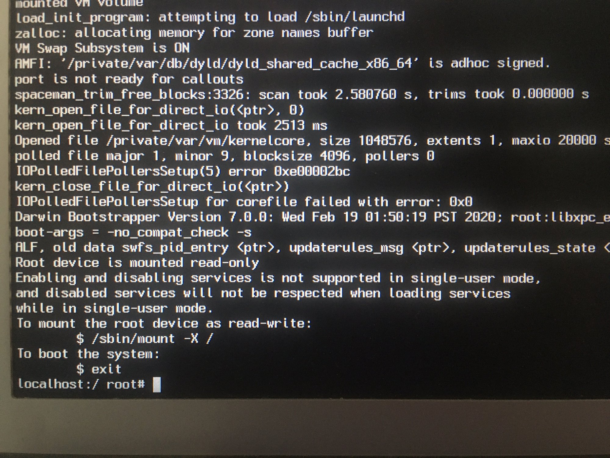

Back to re-installing 10.15.3 as I used the launchdaemon script Julian provided the swupatch to download the update then applied the catalinaswuamfifix patch applied all but the platform check patch as was not needed to be checked in dev beta 3 got into my desktop then rebooted applied the legacy video patch rebooted got a circle with a line through it rebooted back into the patcher applied all the post install patches still got the circle with a line through it did or am reset now couldn’t get into the desktop
"The circle with a line" it's because apple from 4b4 has decided with their OTA to replace the Preboot boot plist with a clean one (probably they refreshed also the APFS UUID), so follow this tip that should work, boot again from the USB Catalina Patcher, open a recovery Terminal and type exactly this (quotes and underscores included):
Code:
mount -uw /
nvram boot-args="-no_compat_check amfi_get_out_of_my_way=1"
reboot
Once you are in 10.15.4b4 desktop, apply the ASentientBot new libraryvalidation script.
It would have worked if I had known that I needed to apply the the first patch in the post install patches as I though it needed to be unchecked like in Dev Beta 3
It was because the post-install first patch re-replaced the Preboot boot-args with only -no_compat_check , but ASentientBot libraryvalidation after an OTA update needs anyway a first round of amfi_get_out_of_my_way=1 , I understand that a pre-patched com.apple.boot.list is useful but it follows a particular route to apply, while instead a NonVolatileRAM is quicker and can be applied from any OSX Installer, any single user mode, any legacy OSX, even from Snow Leopard, and it will be stored (until a manual PRAM reset) and work for newer macOS too when set from Leopard for example.

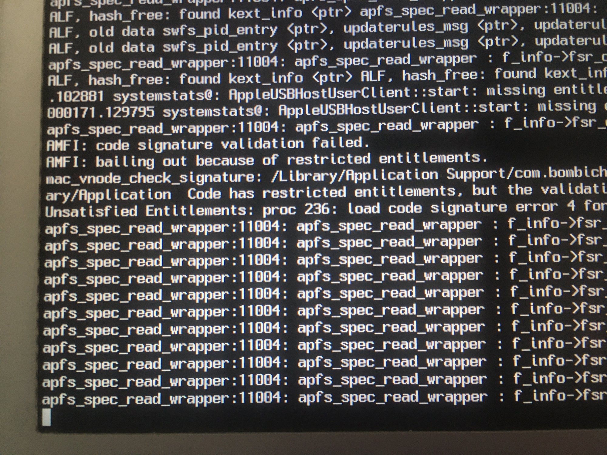

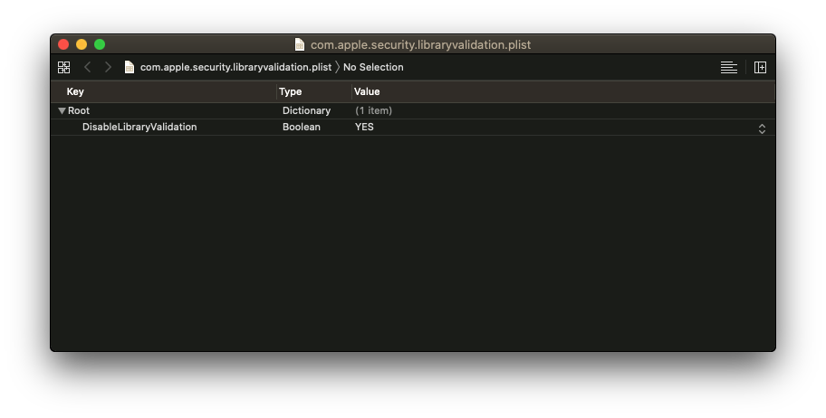

ASentientBot's libraryvalidation plist worked fine for me, without amfi settings in NVRAM.
I did as follows (using a full installer obtained via Mojave, as OTA doesn't work on my 2009 machine on external disks):
- have a clone with 10.15.3 on my external SSD
- create/set the com.apple.security.libraryvalidation.plist to DisableLibraryValidation YES (already done in my internal SSD before cloning, will be useful throughout Catalina's life)
- install .4b3 over the external SSD, with bootable USB installer made with patcher 1.3.0 (options no APFS booter, no automatic paching)
- won't boot as no patches applied yet, but I wanted to watch what happens: the libraryvalidation plist is still intact, boot-args still only -no_compat_check
- applied all proposed patches, including platform check and legacy video card
- boots fine, despite some unimportant AMFI messages regarding CCC, seen in verbose mode
- then installed the new ASentientBot wrappers, rebuilt caches
- all fine, with transparency.
Next I'll try with automatic patching - should work as well.
EDIT: it does. Made a new bootable USB installer from .4b3 with patcher 1.3.0, automatic patching option this time, used it to install over a freshly cloned 10.15.3 external SSD. Proceeds to boot without any intervention... didn't install the newer wrappers yet, transparency is there nevertheless.
Just the Monitors system setting is not showing resolutions, nor does applying night shift with patch updater take effect. Minor things.
So com.apple.security.libraryvalidation.plist is working very well... needs to be done only once and survives system update.
Thanks @ASentientBot!

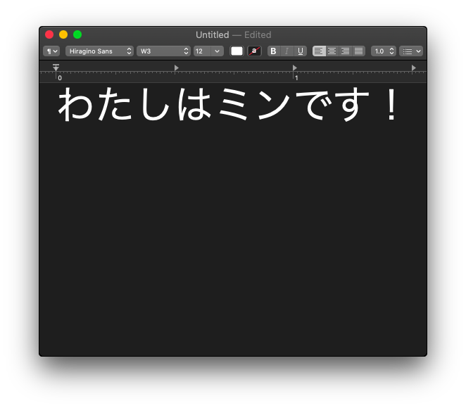

Following @ASentientBot's post, I got the Japanese Input Method partially working by replacing these files from Mojave:
Code:
/usr/lib/libmecabra.dylib
/System/Library/Input Methods/JapaneseIM.app
/System/Library/PrivateFrameworks/TextInput.framework
Just by replacing those file, the Japanese IM worked, however after messing around with it a little bit I am still seeing some strange symbols popping up following by a crash of the JapaneseIM.... But I can still type some simple sentences in Japanese without any problems. Yay!
Edit: Got the JapaneseIM fully working by replacing one more framework (With no more crashing or "おはよ4"):
Code:
/System/Library/PrivateFrameworks/TextInputCore.framework
Hopefully this will help to fix the problems that Japanese people on unsupported Macs are encountering. Good night!
Code:
Code:
Nice! I never figured out a proper solution to this, despite spending quite a lot of time on it.
The other thing I played with was launching the JapaneseIM main binary under Intel SDE (which is supposed to emulate AVX) but SDE doesn't seem to work on Catalina at all. I'd guess if you can get that working, it may be the best solution.
Edit: I apologize for misreading your post and thinking it was still only partly functional; after re-reading I realize you got it fully working. Excellent job! I remember your News+ fix on Mojave, glad you are still here and still being awesome :)

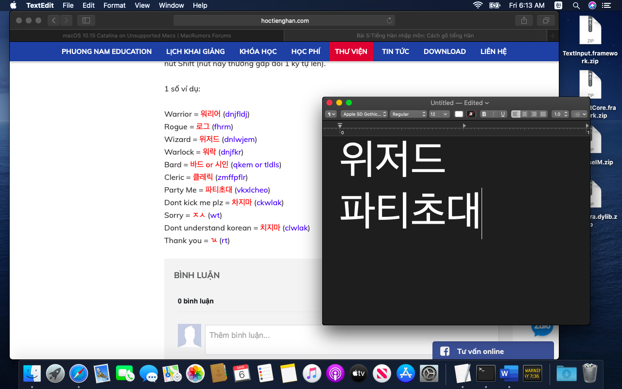

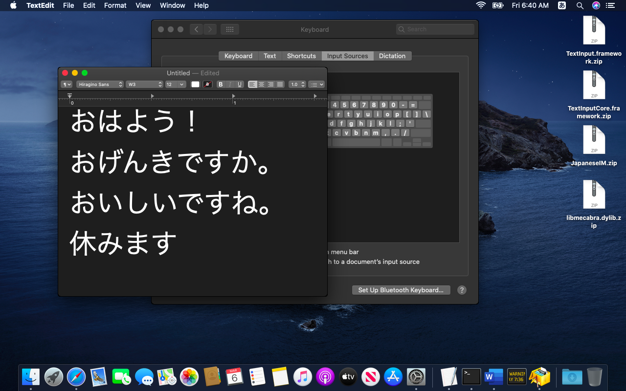

You can also have the Korean keyboard (or any languages resemble the Chinese language) to work just by replacing those frameworks and lib file, and the Keyboard-IM app in /System/Library/Input Methods/
For example, I replaced the KoreanIM in /System/Library/Input Methods/ and it worked flawlessly without issue (despite knowing nothing about Korean here).
Edit: Discovered that just replacing the two frameworks in /System/Library/PrivateFrameworks/ is enough to fix those keyboard input issues. No need to replace the input method file in /System/Library/Input Methods/ or the lib file.
IMPORTANT EDIT: I found out that this fix causes some missing symbols errors in /System/iOSSupport/System/Library/PrivateFrameworks/UIKitCore.framework/Versions/A/UIKitCore, which prevents Home, News, Voice Memos,... and other Catalyst app to crash.
Crash log:
Code:
Crashed Thread:        0
Exception Type:        EXC_CRASH (SIGABRT)
Exception Codes:       0x0000000000000000, 0x0000000000000000
Exception Note:        EXC_CORPSE_NOTIFY
Termination Reason:    DYLD, [0x4] Symbol missing
Application Specific Information:
dyld: launch, loading dependent libraries
Dyld Error Message:
  Symbol not found: _OBJC_CLASS_$_TIAnalyticsEventSpec
  Referenced from: /System/iOSSupport/System/Library/PrivateFrameworks/UIKitCore.framework/Versions/A/UIKitCore (which was built for Mac OS X 13.1)
  Expected in: /System/Library/PrivateFrameworks/TextInput.framework/TextInput
Edit: I decided to only replace /System/Library/PrivateFrameworks/TextInputCore.framework while keeping the TextInput.framework intact. With the inability to type Japanese without replacing TextInput.framework, I have to replace /System/Library/Input Methods/JapaneseIM.app as well as /usr/lib/libmecabra.dylib to make it work again.
