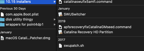

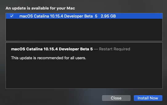

Im not sure why i'm having so much trouble with these betas.. i run all of the posted scripts (attached)

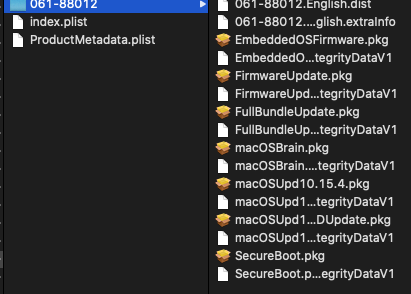

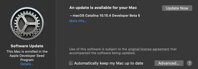

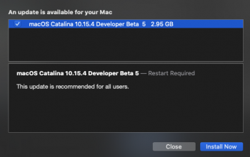

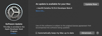

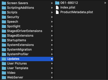

well, I run the script.. MacBook restarts, goes into the install screen. that lasts about 30 sec, then it restarts back to the desktop
P.S. I even deleted all of the updates in the update folder and started over again.
Do you have the swuswitcher app that will tell you which program you are in public or dev beta as the public beta is out as well then you run the swupatch in your terminal so the update appears in the software update in system preferences sometimes it checks twice once you start the download close and reopen your terminal at about 10% or so of the download process run the catalinaswufix5amfi patch
before you restart to install the update run this script in the terminal as well sudo defaults write /Library/Preferences/com.apple.security.libraryvalidation.plist DisableLibraryValidation -bool true

I have both scripts and have ran the both scripts several times, also did the terminal input you added
boot into your Catalina usb patcher in the terminal type csrutil status make sure you SIP is off
