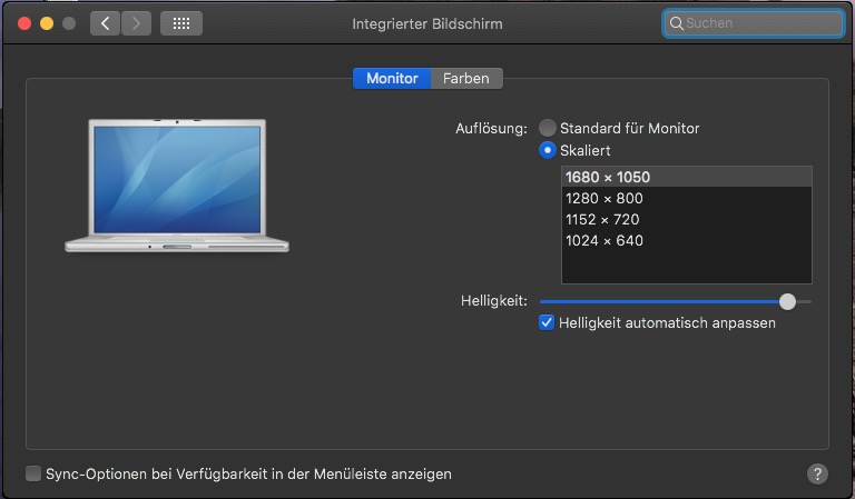

MB Pro 4,1 (17") also working fine on 10.14.6 beta 6 (GM) after the usual Nvidia and system patching.
Next step: Correct the screen settings panel with the .6b5 wrappers. Keeping fingers crossed that this also still works.
--edit--
Yes. Wrappers work! ;-)

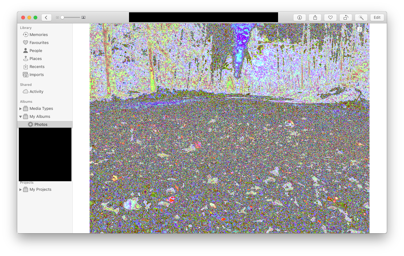

Is there any way to solve this problem?

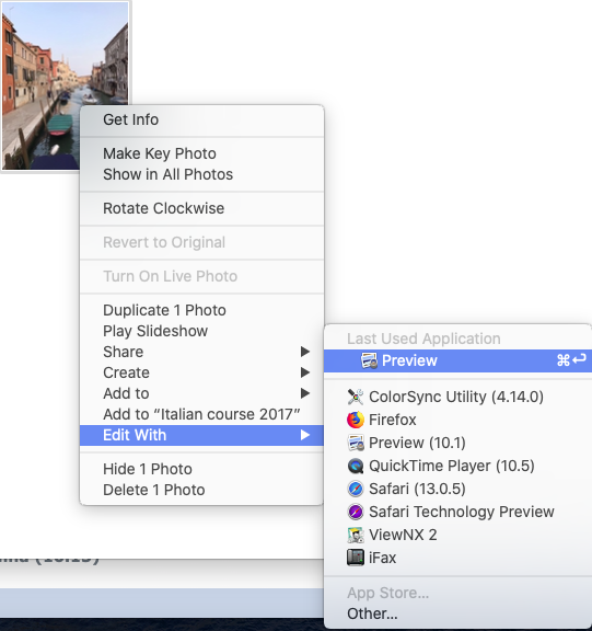

This problem exists on my iMac8,1 and there does not appear to be a solution within Photos itself. You can open the photos using another app. Right click with the mouse and select Edit With. Preview usually works, but you may have another program that you prefer.
