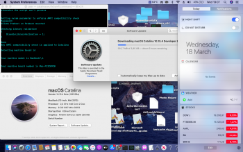

10.15.4 beta 6 is available, @ASentientBot if you want you could try the catalinaswufix5amfi.command (in combination with Sierra's swupatch.sh) , this simply will work on apfs firmware machines, it includes also your added tips with "return true" for OTA machine whitelisting and your recent "disable library validation script", I guess using this auto-installer method with its apple post-scripts is more effective than "pkgutil expand" and "cp -a".

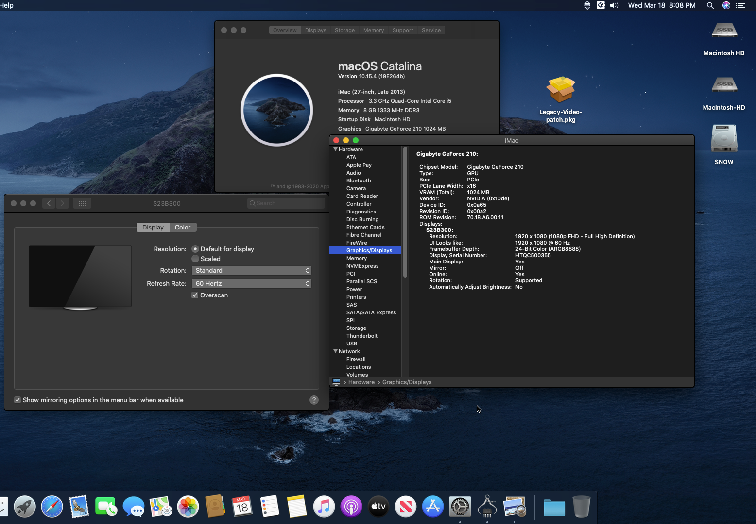

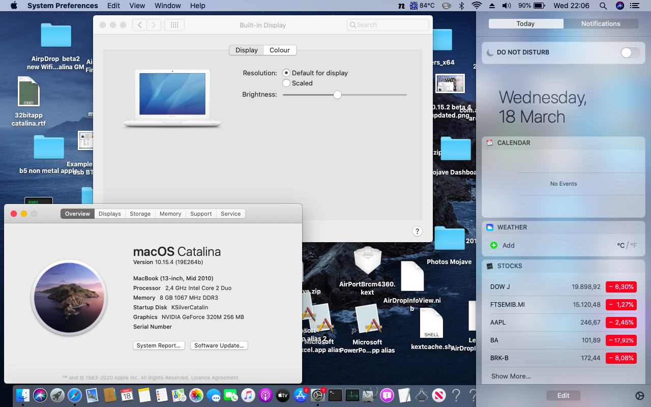

OTA update installed through the catalinaswufix5amfi.command without issues, I made this post mainly to underline that most probably the 10.15.4 beta 6 build 19E264b should match with the next apple public release since the "Beta" naming is not showed but only the build number (if clicked on it, otherwise "About this Mac" showed simply 10.15.4 ) exactly as a final release.
@ASentientBot 4b5 updated output wrappers worked correctly also in this 4b6 release in fixing the Displays prefpane.

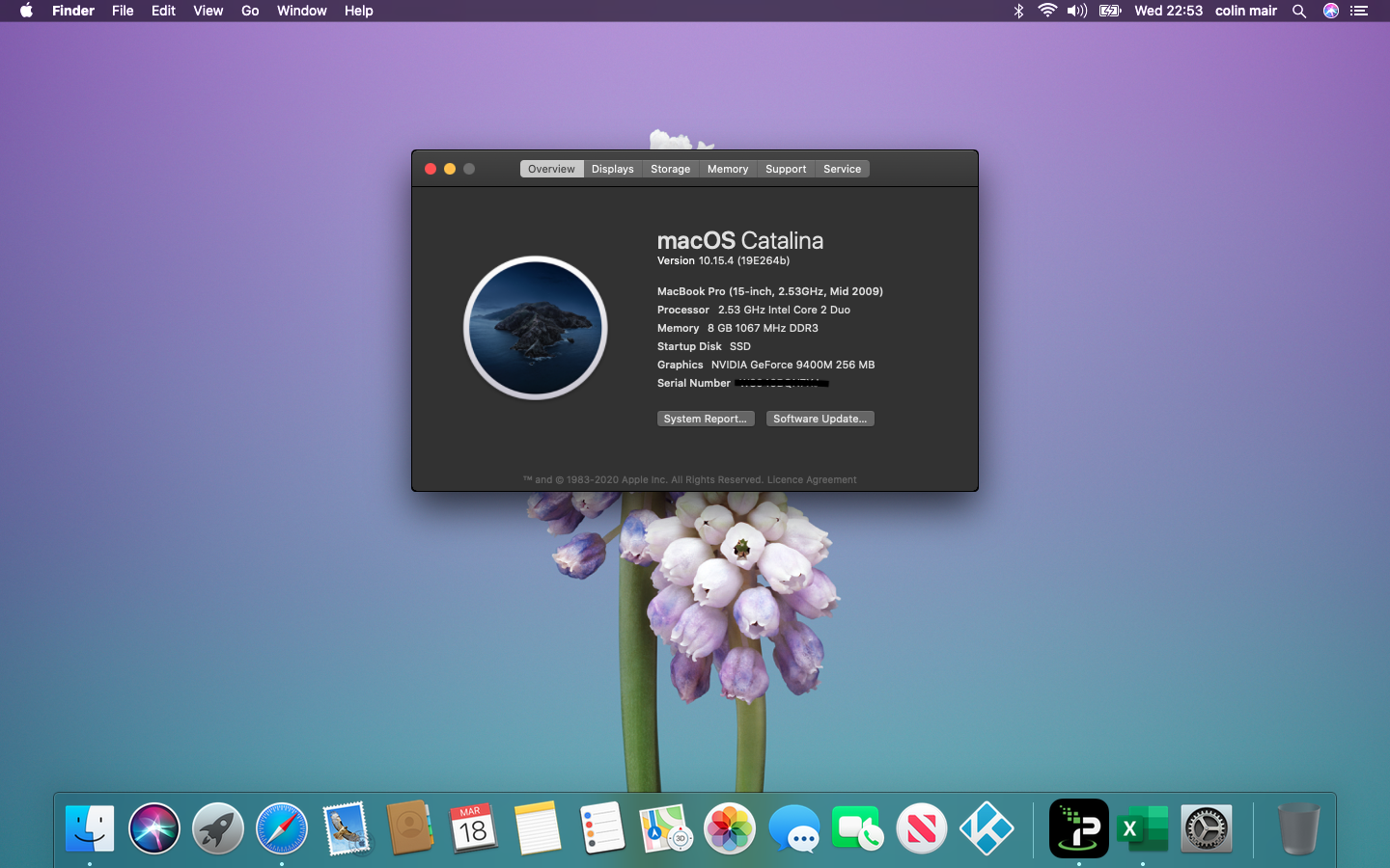

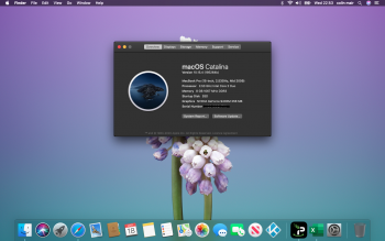

Catalina Beta 6 installed easily using the catalinaswufix5amfi.command in terminal after 10% or more download of the OTA update. On reboot installed the usual post instal patches for my mid 2009 MacBook Pro. As before did the manual method for repairing the blank display panels ( see post 8870). All working exactly the same now as Cat Beta 5.
