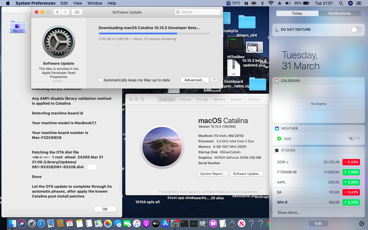

I am currently downloading and installing 10.15.5 beta 1, if will work with ASentientBot wrappers, I'll release the method to allow the APFS OTA update installer also for non-APFS machines.
To those who are using CatalinaOTAswufix, don't worry, the funny apple has introduced during OTA stage2 a full black loading bar, but don't discourage just wait on the black bar for 10 minutes and OTA installer with Catalina circle will proceed smoothly.
