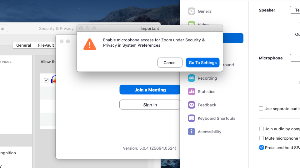

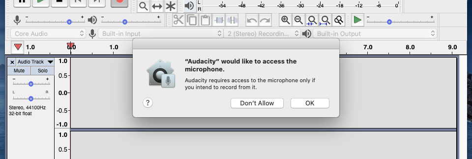

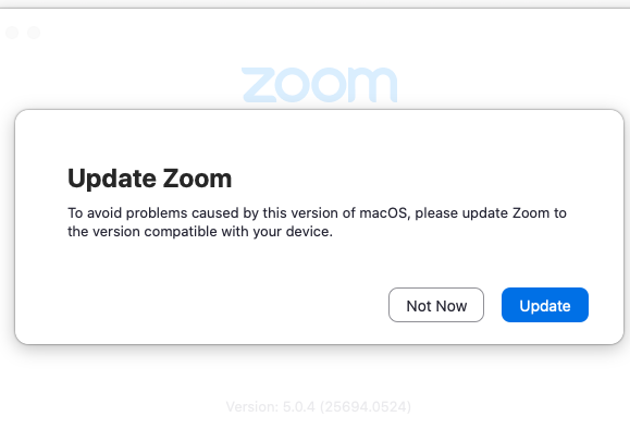

Still having issues with Zoom and Catalina.
10.15.5
As per screen shots Audacity enables the allow in privacy for mic/camera but zoom comes up with a different button almost internal zoom not the OS>?
Zoom Works fine on 10.15.4 on a iMac and a usb installed 10.15.4 boot drive on said MacBook Pro as well.
As you can see running latest download zoom 5.04 and strangely when clicking check for update it says oh must download a version that's compatible as per 3rd screen shot! even tho running latest. Run the updater and it downloads 5.04 again and still doesn't work...!
Im lost!
Any way to force or give a program ie zoom access?
I'm d/l 1.4.4 version of OS and flashing usb installer and will see how that goes rather then patching 15.4 up to 15.5 who knows....
10.15.5
Im lost!
What worked for me was to download zoom https://zoom.us/support/download and install that way not from the update from within the app

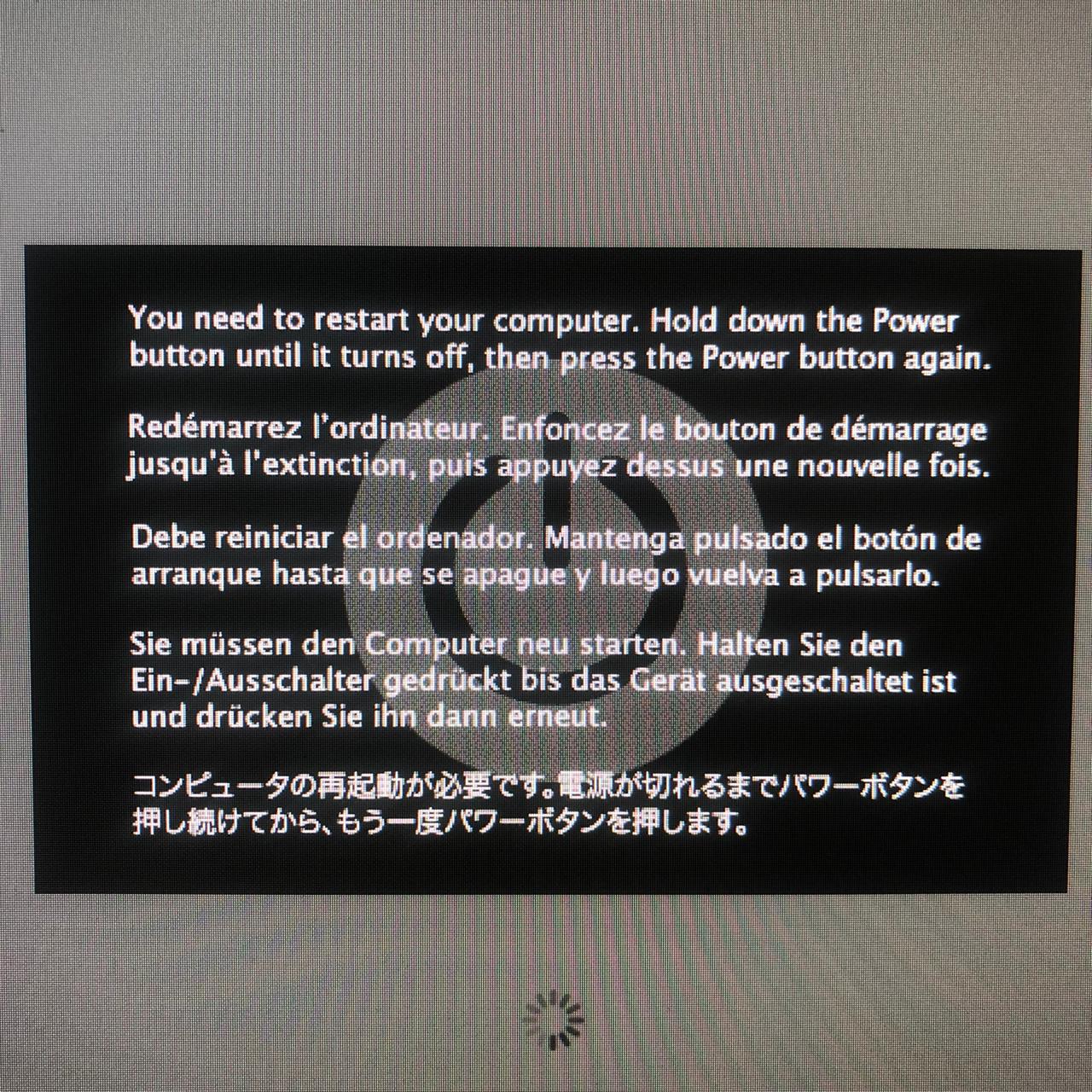

Hello guys, I'm trying to install Catalina using dosdude1 patcher but I can't, I formatted the ssd for APFS, the installation starts and hangs when it's four minutes to finish, the new 770m gpu is installed, will I have to put the amd gpu original to be able to make the patch?
I also tried to restore the system using cmd r but I am also not getting it, at the end of charging, a message appears saying that I need to turn the Mac off and on.
will it be because of the new gpu installed?
iMac 21.5 mid 2011 - i5, 16GB, SSD 500GB, GTX770m (Flashed with Beta3 vBios rom by Nyck)
