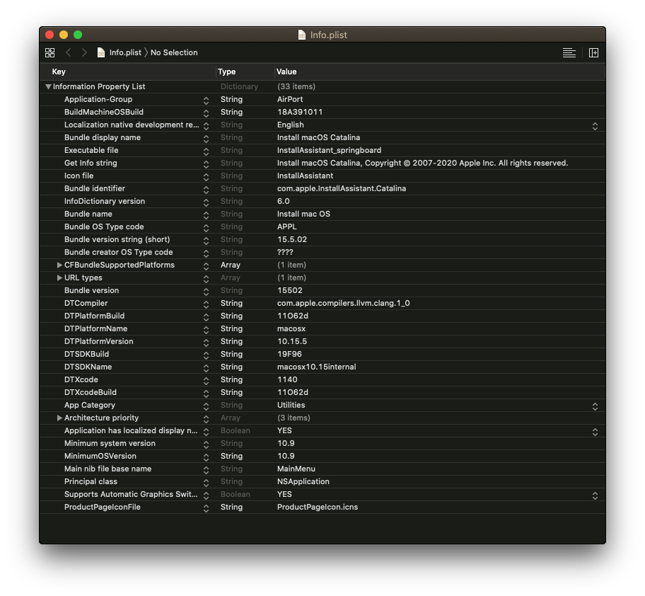

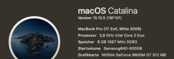

I briefly saw 10.15.6 beta 1 offered in system settings->software update (I regularly use CatalinaOTAswufix.app to see these). It was probably superseded by the 10.5.5 supplement, don't see it anymore. Will go back to 10.15.5 first release (15.5.01) for this.
BTW when looking with Xcode at the info.plist of a release, I often see an older build number (previous one?), so also for the supplement. After installing, the build number is correct in About This Mac.
