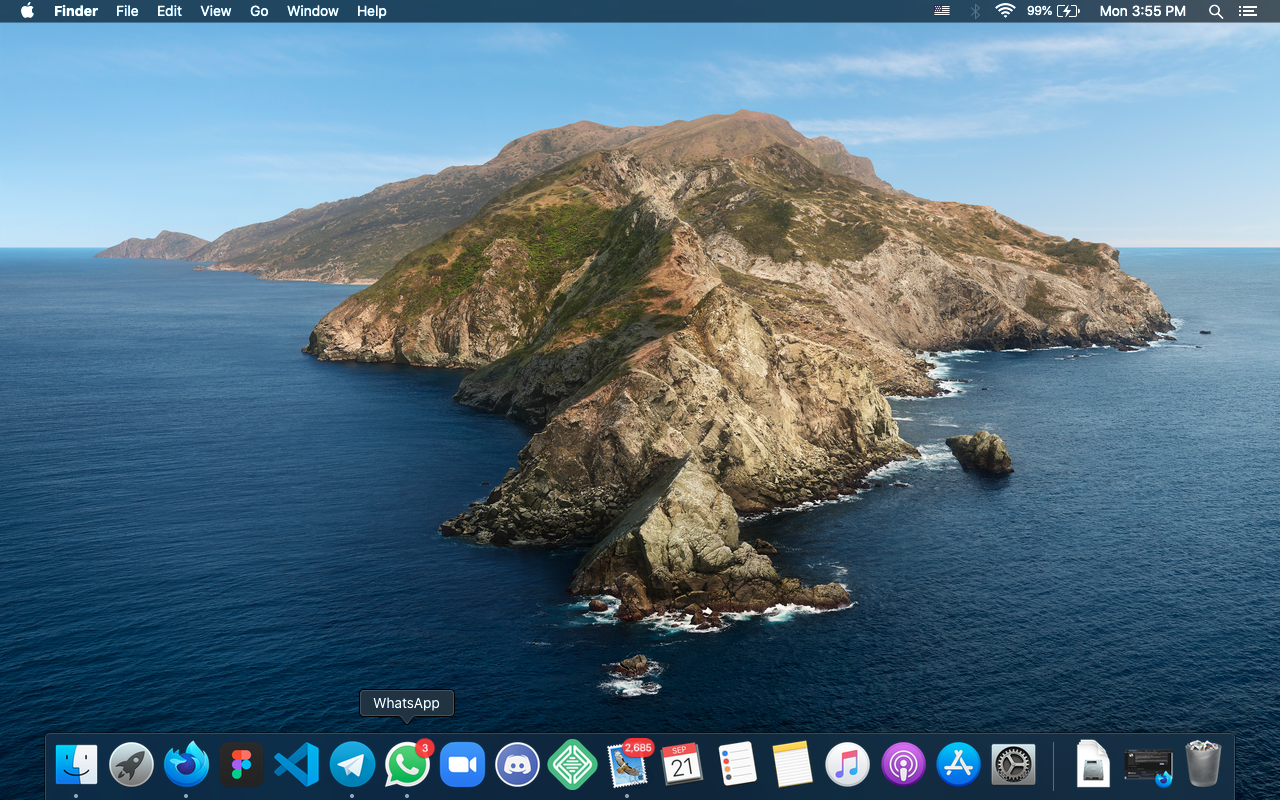

Man, I did a clean installation with MacOS version 10.15.4 and Patcher v1.4.3 and the system is great, everything works correctly, previously I had installed this version but using patcher 1.4.4 and the system ended up lagging. Do you think it could be a problem with Patch 1.4.4?
As you see in the photo, I was able to install all my programs without problem.
